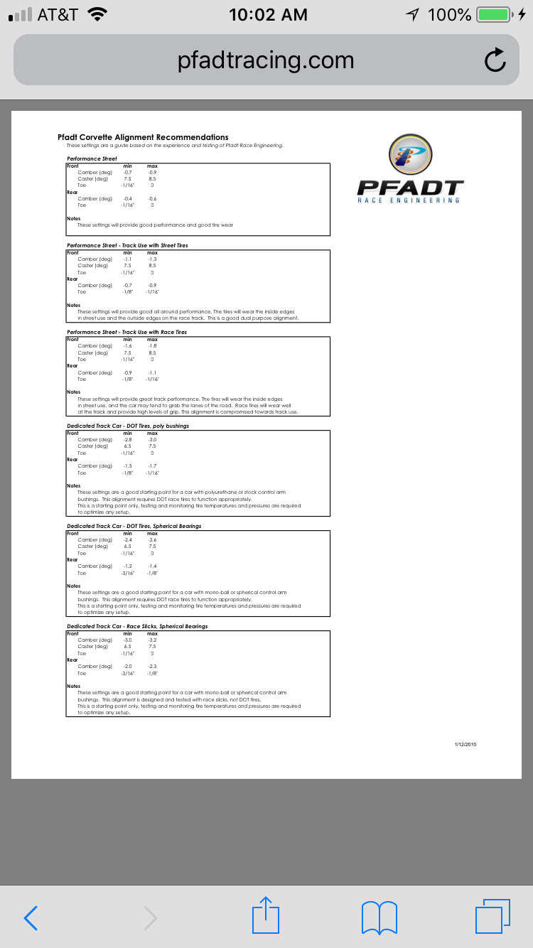

Based on another of your threads you are getting new tires. Get the alignment when you get them, and for best tire wear get a Pfadt Performance Street alignment.

not very often these cars hold their alignment very well! The Phadt street specs are very good.
