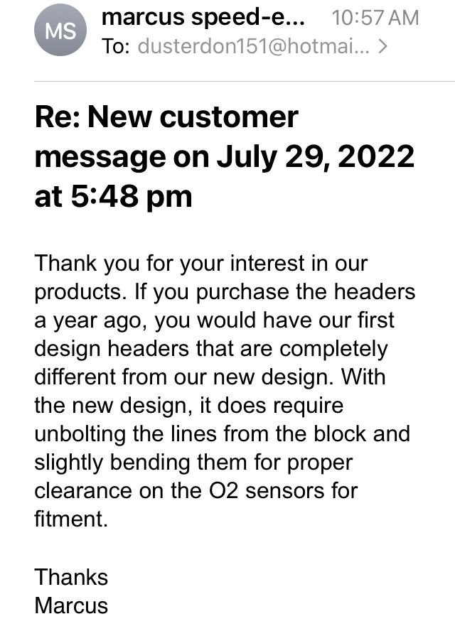

Old Aug 1, 2022 | 12:11 PM
farmington's Avatar
farmington
Joined: Aug 2017
Posts: 4,243
Likes: 1,133
From: North Myrtle Beach SC
Just got this from SE
Old Aug 1, 2022 | 12:22 PM
StayinStock's Avatar
StayinStock
Joined: Dec 2013
Posts: 6,338
Likes: 5,115
From: Charles Town WV
2023 C6 of the Year Winner - Modified
hmm, well thats a pain. But still for half the price of the competitors still a good deal if your on a budget. I will say my biggest complaint about them is the tinny cheap tone... I think the think walled stainless causes it. I have a friend with a nearly identical setup as mine except kooks long tubes and his car sounds way nicer than mine.
Old Aug 1, 2022 | 06:48 PM
farmington's Avatar
farmington
Joined: Aug 2017
Posts: 4,243
Likes: 1,133
I pulled my set out of the box ( they are going on in 6 weeks) and thank goodness they are the old style. The pictures I saw on Facebook of someone doing install with the newer ones didn’t look good.
