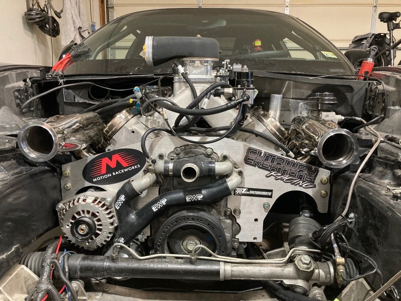

That makes sense if you are ever planning to go back. I ran the alt in stock location for a long while with the ICT bracket, then I moved it down to about where the AC compressor was when I did my motor plate. I wanted to make space for up and forward headers for my turbo setup. I should take more pics, this is old as I have since deleted all the OEM brake lines and converted them to 3AN, deleted the hood latches, trimmed back the cowl, etc. but yes I have lots of room for activities!

You’re definitely further along than I am for sure. That looks like a lot of car you got going there. Seems like I’ve seen this pic before while picking through the forum. Did you convert to a live axle set-up as well?
I was planning on just removing the PS pump/lines & run the factory alternator/PS bracket. Is the ICT breaker required to delete the PS pump? The reason I ask is, I couldn’t find a bracket in their catalog that worked. I called & spoke with those guys as well, & they didn’t seem to think any of their stuff was applicable. They have a trk bracket that deletes the PS but places the alternator waay high & even then requires another bracket to fit the corvette alternator that pushes it up even higher.

You can certainly do that, I did for awhile but the bulky stock bracket annoyed me so I set out to delete it. I found the ICT bracket and used the adapter you mention for the stock alternator, wasn't ideal as the adapter had just enough flex to give me belt issues at high RPM. So I went to the local parts store and traded mine as a core for a truck alternator that fit in perfectly in the bracket without the adapter which solved the belt issues. I had some issues with engine mounts so that spurred the motor plate setup and moving the alternator again, that same truck alternator is the one in the pic above, its been working better than my OEM vette one ever did.
