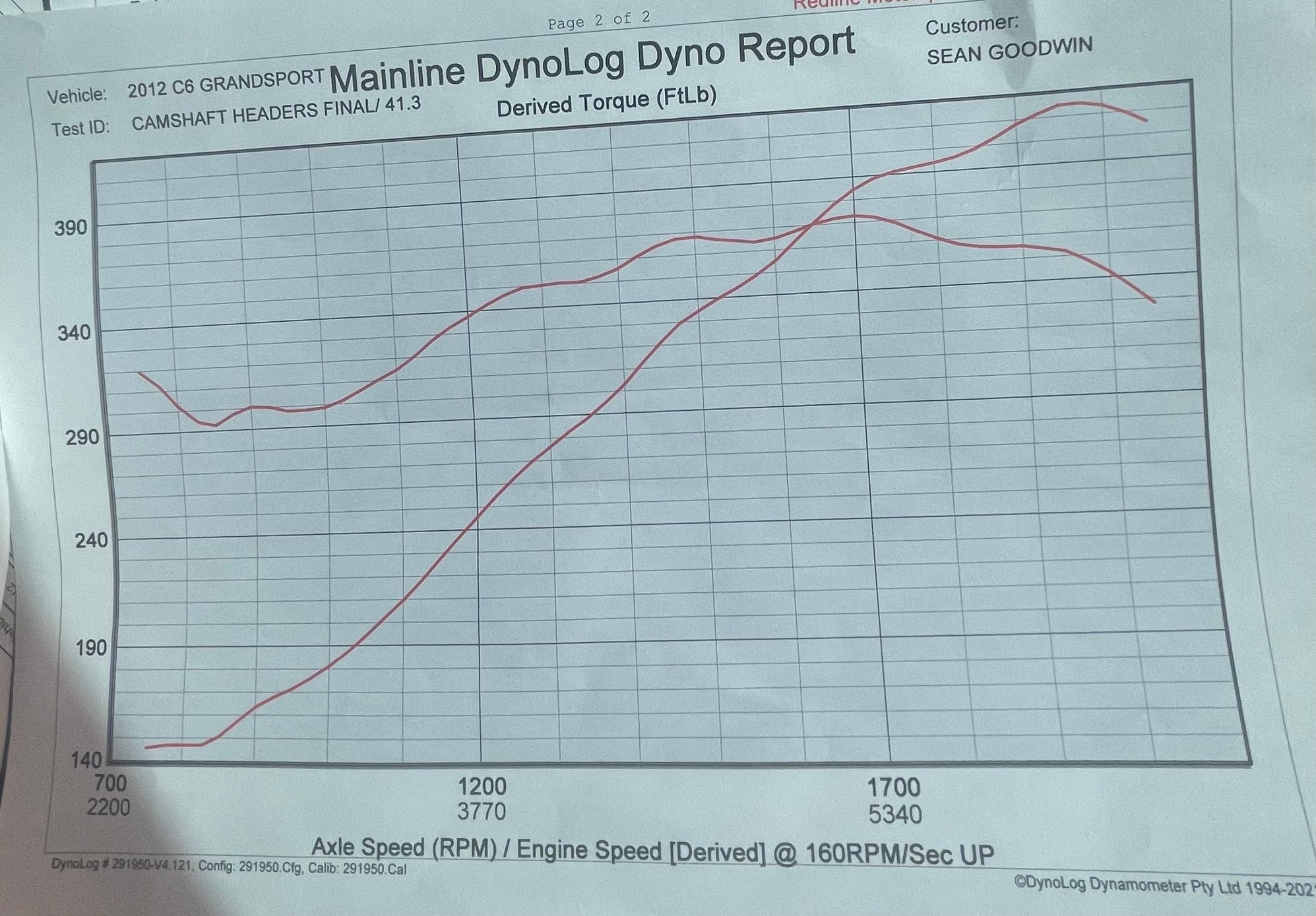

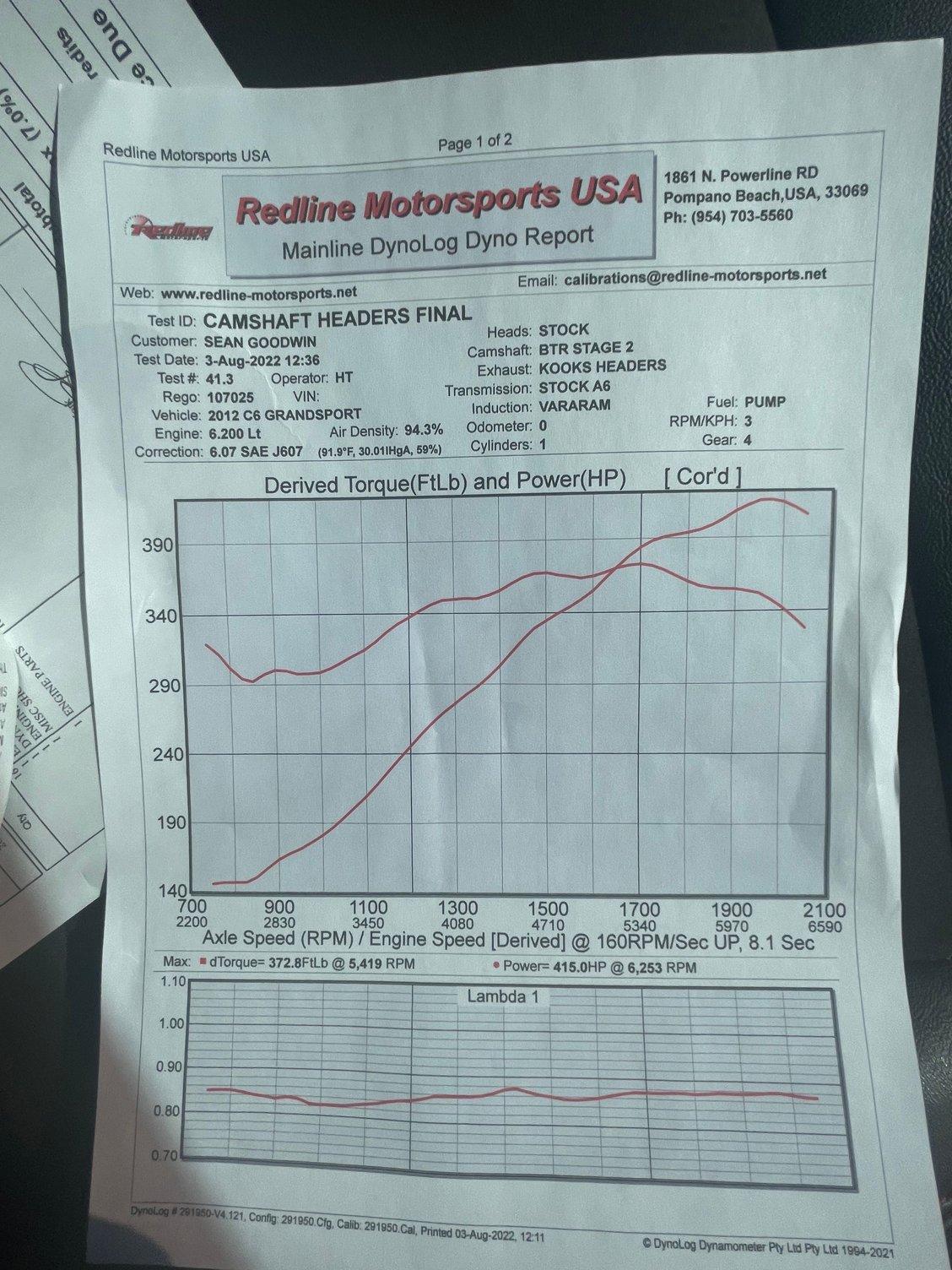

yea I’ll snap a pic of if and post it

I'd expect something like 440ish rwhp through an A6. That's dyno jet numbers. Is the dyno corrected to standard atmospheric conditions? Uncorrected dyno along with hot assed weather will kill dyno numbers

The owner said he was still getting used to it etc etc… weathers been
hot af down here… I’m sure all contributed to low #’s.
maybe I’ll look for another dyno run in the winter… idk

This is why I like inertial Dynojet’s…..just a big dumb wheel with minor corrections. I can’t manipulate or “get used to” my dyno

Bottom line, how does the “butt dyno” feel? That’s really the bottom line. If you NEED a number, find a dynojet and make a couple pulls.

Throw it on a dyno jet and see what it puts out. Your car on a dynojet should be at least in the 460-480hp range. For reference my 2011 LS3 manual car made 432 with just headers and tune, still on the stock air intake even.

Def would be a low number on a Dynojet considering it’s an LS3 but I’m not familiar with that particular dyno. If it were me I’d do what someone above mentioned and find a shop with a Dynojet and make a couple pulls to compare. If it still comes back lower than expected then go from there. I’m about to have the same cam put in my LS3 C6 and I would def be disappointed if it only make 415… don’t wanna get too caught up in the numbers tho.
