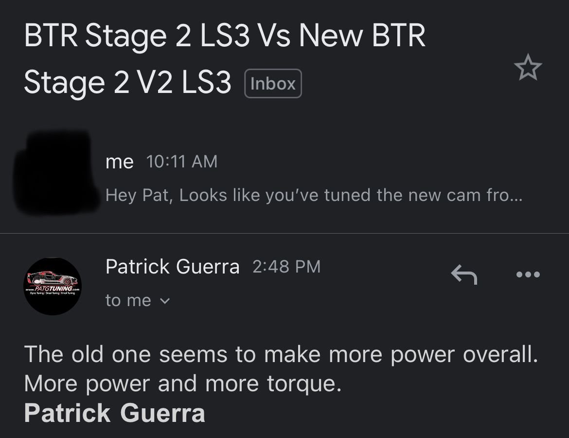

From: Chicago
Originally Posted by SpinMonster
So have any of these cams been installed and put on a dynojet for factual results?
To BTR stage 2 V2 cam

I understand the need for trade secrets but if a cam is an outdated design and no longer sold or if the results are not what was expected, meaning it's a failure, what's the point of secrecy with the specs? Wouldn't it help the end user to not do something with design in order to save people money and heartache? I've always felt that by sharing specs and collaborating, we would have head/cam packages at 535rwhp on a 6.2L

Originally Posted by Petera90
So he’s saying he has tuned cars with the new V2 stage 2 and the old one makes mpre power and torque overall? Interesting….
Old Oct 21, 2022 | 06:44 AM
  #40
Petera90's Avatar
Petera90
Joined: Aug 2021
Posts: 140
Likes: 11
From: Chicago
Yes overall the old version is better he said. The old stage 2 is also his favorite off the shelf cam for the LS3. I don’t get the secret specs now from BTR. It’s not like all of sudden these new cams are gonna make 50whp more vs the old ones. They even stated on insta all tests with their new cams are done with e85. I like BTR I have their stage 2 N/A cam and it drives great for a cammed car. But, their hype for their new cams is kinda lame especially when you call them and they tell you the overlap of the new cam and it doesn’t line up with the specs.
