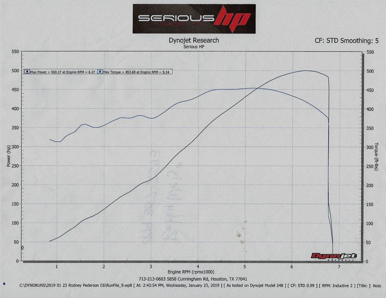

Agree. I won't have a cam that's not ground by Cam Motion. Also, won't have a cam with over .620 lift. My current cam is a custom 226/234 115+4 with .620/.620 lift ground by them and specced by me. It's got about 50K miles on the build now. I did change the BTR platinum dual springs along with the stock rocker arms at the 30K mile mark. Everything looked good at that point so I went back with new versions of the same springs and rocker arms.
The cam has 0 (zero) overlap. No huge split with huge exhaust duration that does little more than increase overlap and add to drivability issues. You can set the cruise control at any rpm from idle on up in 6th gear and it will run smoothly with no buck, surge, or shake. It will even smoothly idle up a mild grade in 6th gear.
With CNC ported and mildly milled heads, thinner head gaskets, ported and rod modded intake manifold, plus all of the bolt ons, it showed 500/454 at the wheels. It's been running strong for 5+ years now. If it disappeared tomorrow, I'd build another one just like it. Wouldn't change a thing.

I agree with the first two paragraphs. Respectfully disagree with the third.
GM uses the same square port heads on trucks that are used on the LS3. If the square port heads were an inherent torque killer by themselves, I don't think they'd be a good choice for trucks. I think the camshaft you choose has more to do with where power is made than your head choice. I do agree that with bigger camshafts, the square port heads aren't going to be low end friendly. Just need to steer clear of the bigger camshafts with lots of overlap for a street Vette.
My LS3 heads are CNC ported which, by conventional wisdom, should kill low end power even more. I did bump up the static CR to 11.4 ish which helps some I'm sure. With Michelin PS4's, it gets no traction anywhere past idle in first gear and gets loose at the top of 2nd. With drag radials, it gets loose sometimes at the top of first depending on pavement type. Here's the dyno. I don't think it's missing anything down low.
2021_01_30_055637_96c3beba91524c0757d9b2 ab66f45e60e704ad77.jpg (1259×973) (ibsrv.net)
