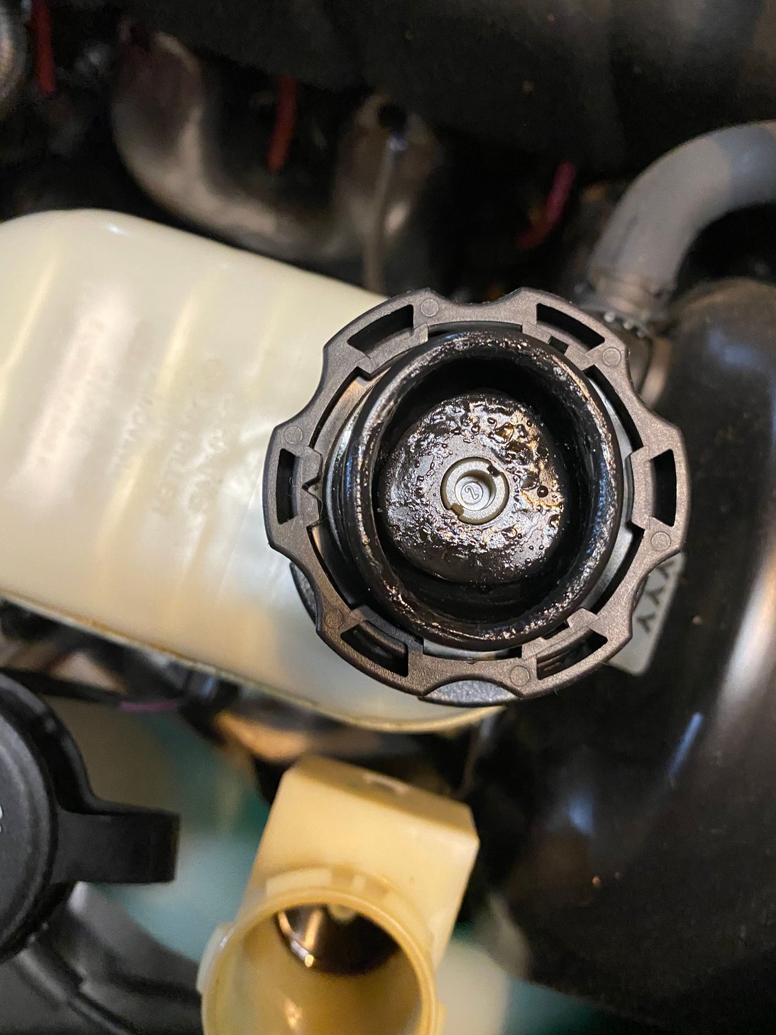

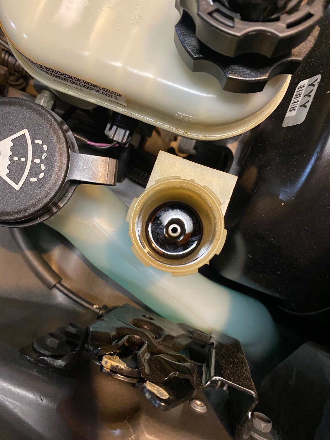

Looks like the level is low and the fluid pretty dirty. I assume this is the reservoir for the clutch. Any thoughts?
Inside of lid.

Yikes....looks like the clutch fluid was never replaced, which should be a regular maintenance step with a manual trans. The black stuff is the build up of carbon & "schmutz" (that's a technical term) that will degrade clutch performance. Replacement of the clutch fluid is an easy DIY & should be done at least once a year or more often with hard usage. There are a number of methods to do this.... here's one... https://www.corvetteforum.com/forums...lush-tool.html. There's also the so-called "Ranger method" which just uses the syringe or turkey baster to suck out old fluid from the reservoir; add fresh fluid; pump the clutch pedal 10 ot more times; suck out the blackened fluid again & kept repeating that cycle until you get clear fluid in the reservoir. Do it NOW!
