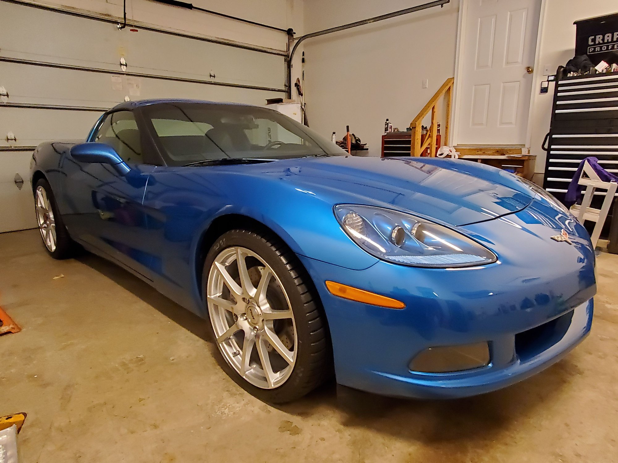

I ended up with the Michelin PS 4S. I wanted to go with all season tires, but availability wasn't there. So far I like them. Headed to the track tomorrow for my first day. It will be an easy day. I won't be pushing hard. I don't expect to be out in the cold much so I don't think the summer tire will be an issue.
That Jet Stream Blue looks great!
