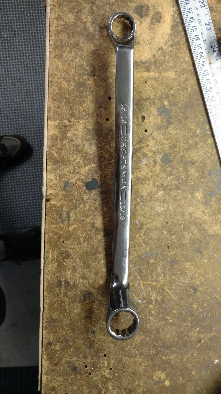

I use this too rotate the engine while in the car. It misses the steering rack but grabs the bolt head good.
