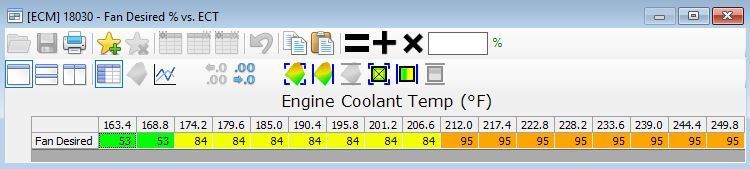

So, when do the fans kick on?
Lets say 200*F fan turn on, 190*F fans off. This is like my gasoline daily driver turbo set point (actually 196*F on 188*F off)
It matters where we measure, I use near the head exit point to the radiator, water coming out of the engine, not going INTO the engine which is much cooler.
Anyways- so lets look at this situation.
How did we raise the temperature of the engine to 196 or 200*F? We let the water coming in become near 170-180*F something like that. Which means the thermostat is open, staying open. Not closing. When the fans kick on at 200*F, the thermostat is open. The fans turn off at 190*F, the thermostat is still open. It will not shut until 160*F or less, right? So, basically, it does nothing. Its almost exactly like having no thermostat at all.
Lets look at another example, this time 185*F thermostat. I set my fans to 205*F and off at 195*F.
The fans come on at 205*F- thermostat is open, water is free flowing through radiator and engine.
The fans turn off at 195*F- thermostat is open, water is free flowing through the radiator and engine.
Again, its like the thermostat isn't even there. The thermostat does nothing to cool the engine. All it can do is rapidly warm the engine to it's pre-set temp and then meter water gradually at that temp until the whole closed loop system can be fully warmed to some minimum temp where the thermostat remains open the entire time.
What if we set our fans *off* temp below the thermostat closure temp? Ah- this is a tiny secret from clutch fan days where the fan always runs. Then the fans will continue to run, even when water has stopped flowing into the engine because the thermostat closed already. That means the fans will run constantly while the radiator becomes cooler and cooler because water is stopped inside due to closed thermostat, assuming we have strong enough fans and a nice radiator design. If we had a clutch fan, the thermostat setting becomes the fan setting for the water leaving the engine. We can take advantage of this situation in racing events where we desire cold water from the radiator to be available but the electric fans must be activated manually on a switch to run like a clutch fan constantly and the thermostat closure point must be high enough to maintain engine efficiency for the type of racing. For example if I plan vehicle on a road course for 20 minutes, I would prefer to start with a cold radiator, not a fully warmed radiator with the thermostat hanging open. So I bypass the 200*F setting with a fan manual switch and bring the engine temp down to 185*F where my thermostat closes (no less than 185*F though). and now the engine sips colder and colder water maintaining 185*F while the radiator drops gradually 175 165 155 145 135 whatever it can reach. Then, the event begins and I flip my switch off, the fan turns off, if I want to conserve the energy of the fan (less voltage drain, fan is off, free up some battery). The engine is still 185*F thermostat closed, and it will remain 185*F until the water entering the engine finally begins to exceed 185*F at which point the water outlet temp of the engine will climb and eventually turn on the my fans again at the appropriate 200*F setting for on.
