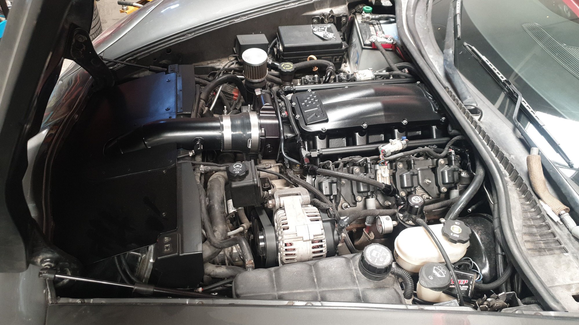

As u can see custom shroud
This the intercooler location

Originally Posted by Dr.BlueDevil
Yes SLP UD blancer
Your water pump is running too slow at idle coupled with much reduced airflow when stationary due to fans and huge I/C.

Its not clear from the picture if there is any gap for fresh air to get to the rad from the front or bottom - does it all have to go through IC? If so make sure you seal the rear edge of the IC to the front of the rad.

You gotta seal up the sides of the radiator. In traffic and at lights you're just sucking in hot air from the engine bay through the fan then radiator. Evidence here is that you're running between 180 and 190 on the highway. An underdrive pulley doesn't have that large of an effect. I have one as well.
