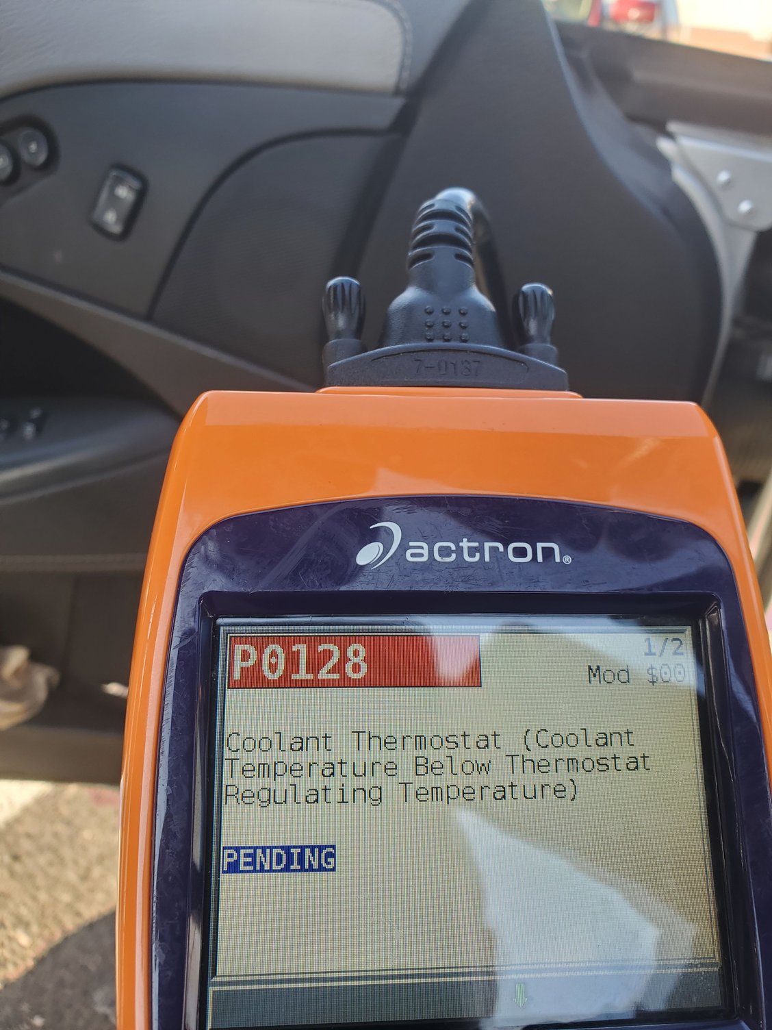

Old Feb 20, 2023 | 02:16 PM
rjr49's Avatar
rjr49
Joined: Oct 2010
Posts: 277
Likes: 11
Disconnecting the battery worked for a while but it happened again. This time It only worked for about 10 miles. So, I followed your advise and had the code pulled. It's been a long time since I swapped a thermostat but I can't see that being a problem. the coolant is cold! I don't see what difference it makes to the computer weather the thermostat is open or closed. It's definitely not hot! So. I'm thinking it's the temp sensor. What do you guys think?
Old Feb 20, 2023 | 03:12 PM
C5 Diag's Avatar
C5 Diag
Moderator, Tech Contributor
Posts: 15,601
Likes: 4,060
From: Cape Coral, Florida
The ECM not only want to make sure the ECT is to high but also too low…a warmer engine reduces emissions so that’s why it’s throwing the P0128…if you think it’s the ECT sensor let the car sit overnight and with your code reader see what your coolant temp reads…it should be within a few degrees of the outside air temp…if your code reader has a global OBD2 function ( check engine light symbol) check the ECT there…what you see as far as ECT is the temperature the ECM is seeing…there is something called “substituted values” in scan data which I won’t get into here.
