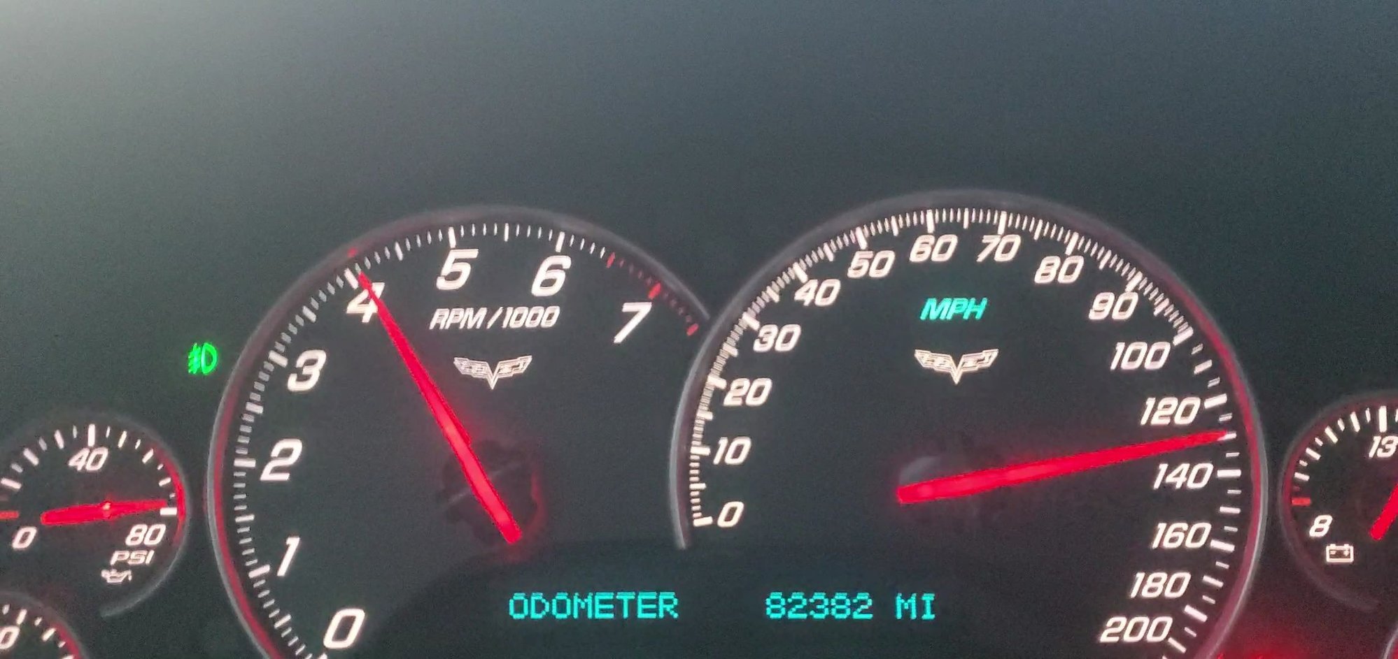

My engine builder says to use valvoline vr1 20w50 in my 5.3 sleeved to a 427. At wot I see 80 psi oil pressure from about 4000 to redline. I have been told by others this will blow my seals out eventually & will actually lubricate less. So, can I move to a 10w40, or 0w40?? Any info is greatly appreciated.

Old Nov 26, 2022 | 12:01 AM
Littlered2009corvett's Avatar
Joined: Mar 2021
Posts: 44
Likes: 10
From: Cleveland, n.c.
