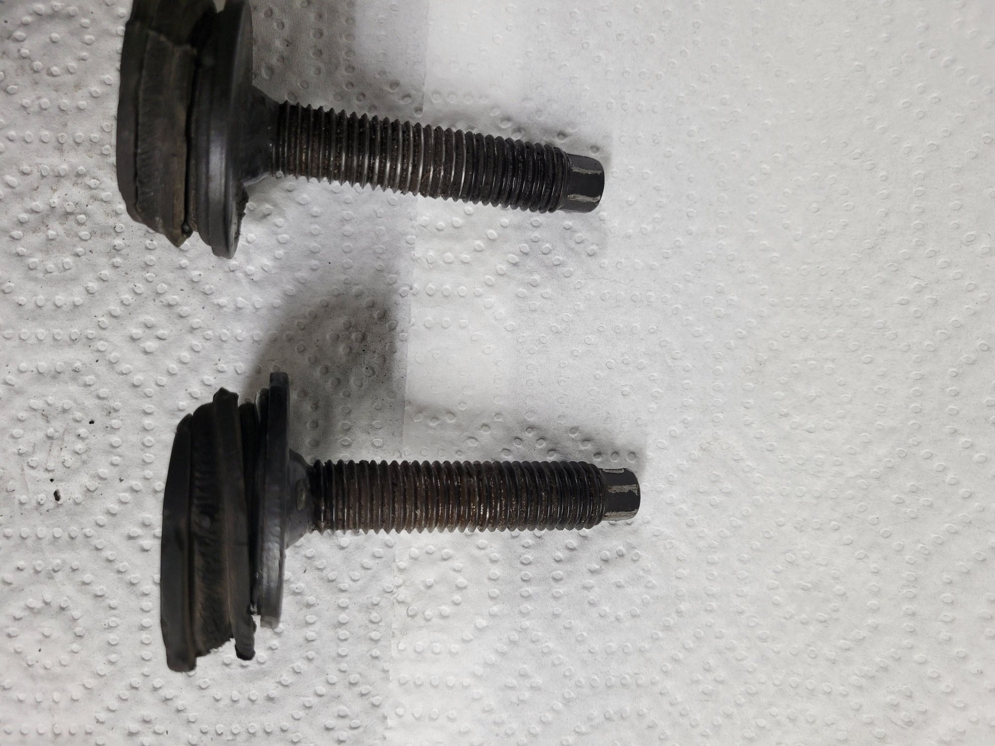

Hello, before doing any ride height adjustments, be sure to take a look at the bolts. Have to get aftermarket as no longer available without getting whole spring. Went with silvers coilovers and never looked back.

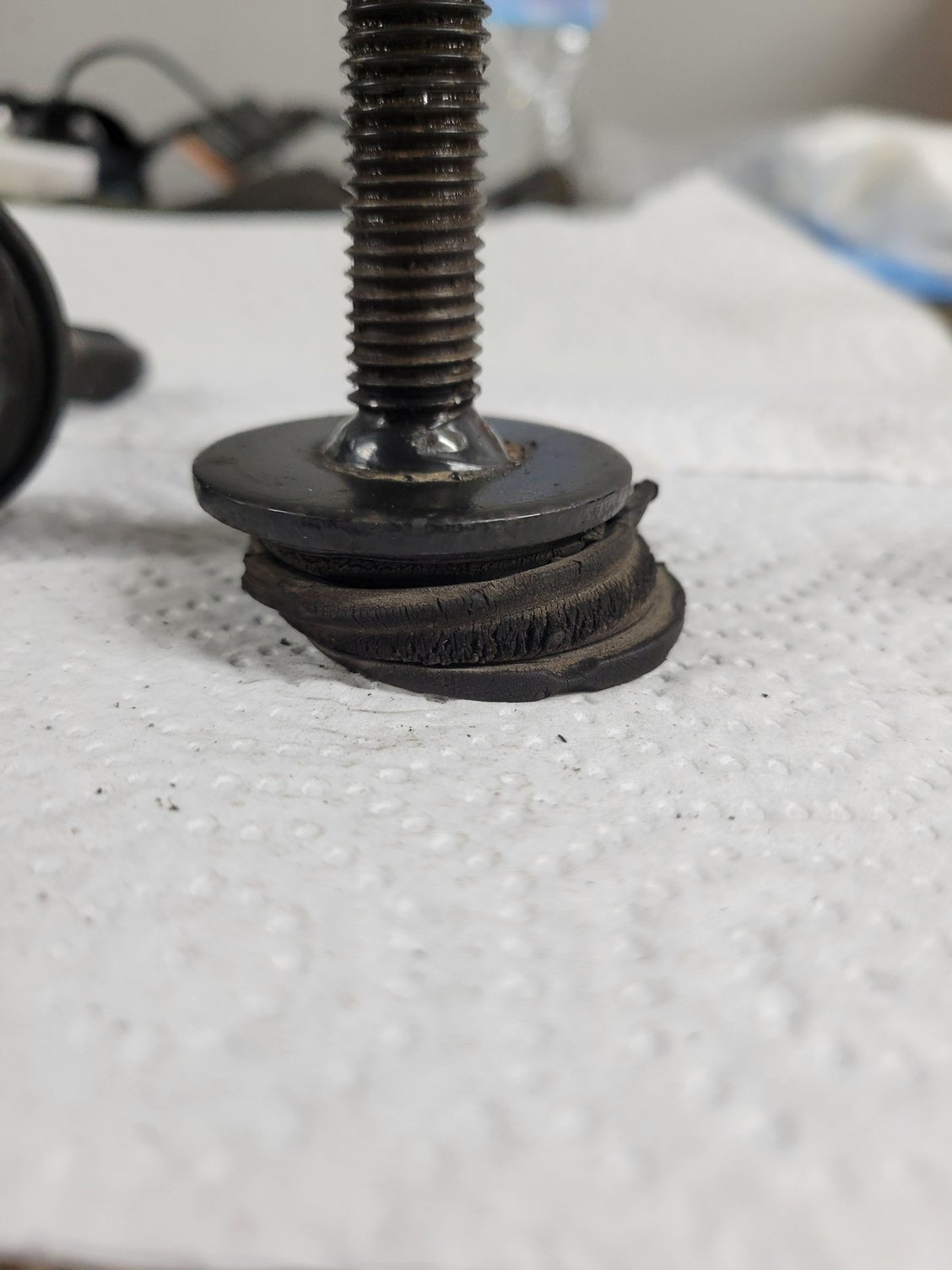

those are in pretty good shape actually. They sheer because the UCA and the spring arcs have different radius. I have several laying around the shop

That's about how mine looked, ended up cutting half the pad off anyway with a cable saw. Will serve me fine until I get coils

a little silicon lube helps, GM really should have done better with either the geometry or the adjuster design. I would have guessed it was an afterthought by the spring manufacturer, expect that they kept using it for decades.

That's how my fronts currently look. I'm running a Hyperco spring in the back with Delrin bolts and they seems to work well. Time will tell...

I tried those from 3 different places, they are all made the same and the thread pitch is wrong (really bad quality).
Actual OEM ones do not exist except used. they were never offered separately from the whole leaf spring afaik.
Sent em back and got stainless lowering ones with the swivel pads, they work really well, and ditto on the silicone grease.
my ride height was higher with those to start with so I'm pretty happy really, I needed to raise it.
