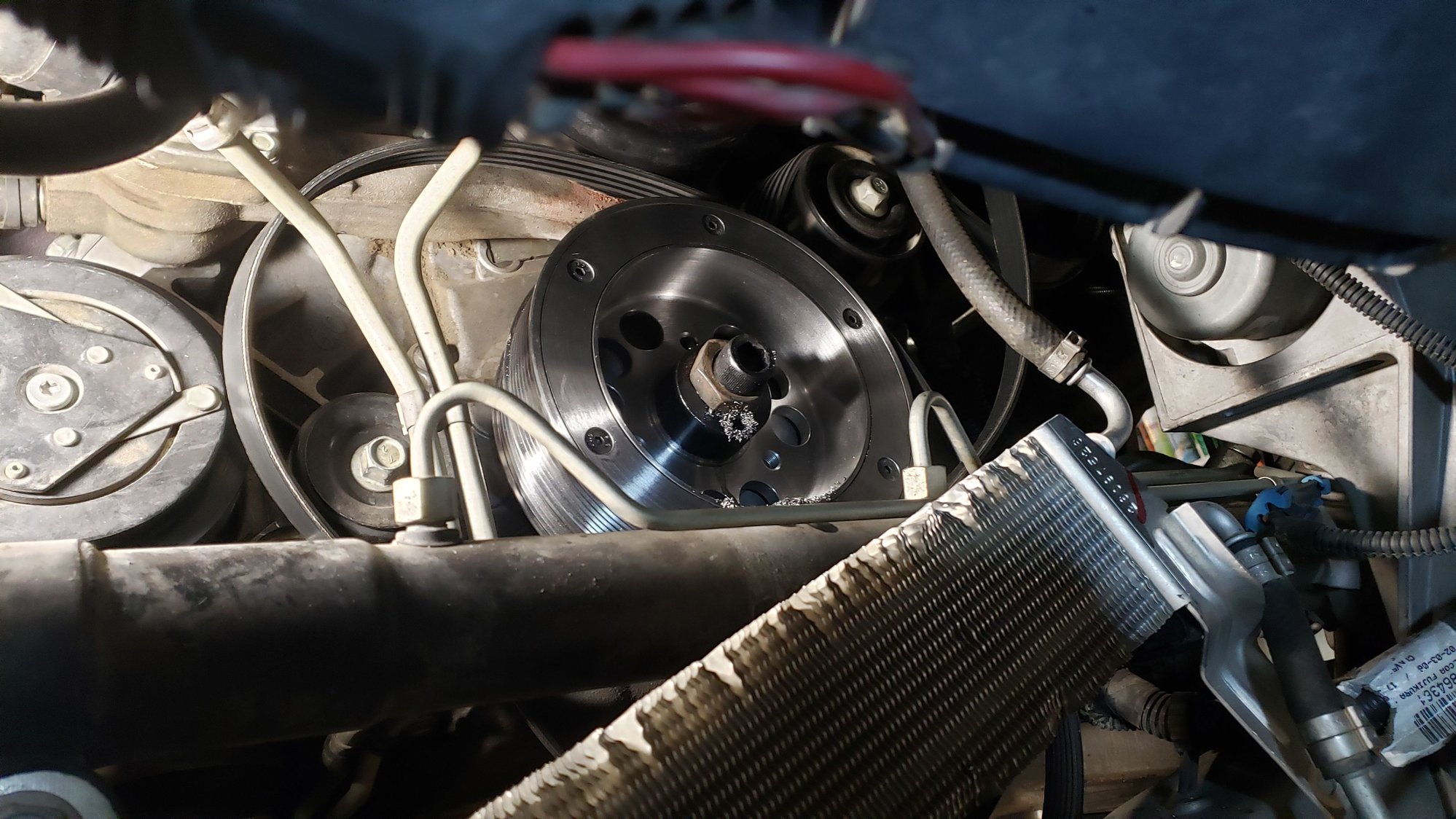

Nicely done sir! I did mine about a week or 2 back (I posted a video on here somewhere) and definitely preferred dropping the cradle to messing with the steering rack. I used the power bond replacement. So far so good. Mine had 177K miles on it. Hoping this one lasts just as long :-).

Hey one more quick thing... You may not have this problem/issue but after re-assembly on mine, I had the "service ride control" message on my DIC (F55 model). Apparently, the LF ride sensor had come out of it's socket when I dropped the cradle. Quick and easy fix but... if you have the same issue, FYI so you know what to look for :-). Here's a pic. Sensor attaches to lower control arm and cradle.

thanks for that tip! This is the scary part, what have I screwed up that I don't know about? Yesterday I noticed my steering wheel was turned 90 degrees right when the disks are pointing left. Unbeknown to me qhen I dropped the cradle the steering shaft came out of the socket. I was focusing on the lines and wires in the front. so I need to make sure its aligned when put back together. I keep reading about the clock spring, hope I did not affect it.

did you pin your ballancer and also heat it up before installing?

Installed! Based on how easily the hb went on i would strongly recommend pinning the crank and to use a jig when drilling the hole.
