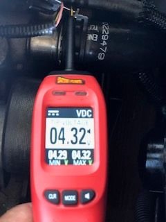

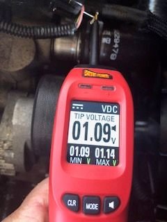

Dorman for anything electrical is JUNK !!…the P0120 is for the TPS1 voltage so I don’t understand why you changed the APP sensor ??…if the ECM sees TPS1 less than .325 volts or greater than 4.75 volts the DTC is set…there are 2 sensors which are actually simple potentiometers…TPS1 voltage goes from low voltage at idle to high at WOT and TPS2 works the opposite…if you have a DVOM you can test the signal wire at idle and WOT…there are 3 wires…a 5 volt reference, a signal, and sensor ground…you should be checking ALL of those voltages…a scope is the preferred testing method because it takes millions of voltage samples per second…you’ll never see this with a DVOM…it may be best to find a diagnostic shop that uses a scope but very few do…dealerships don’t use one either….scope capture (TPS sweep) below…TPS1 going from 1.085 to 4.341 volts…DVOM voltage also enclosed...I am moving this post to Tech…and remember...ALWAYS go with OEM sensors and parts if possible !!
