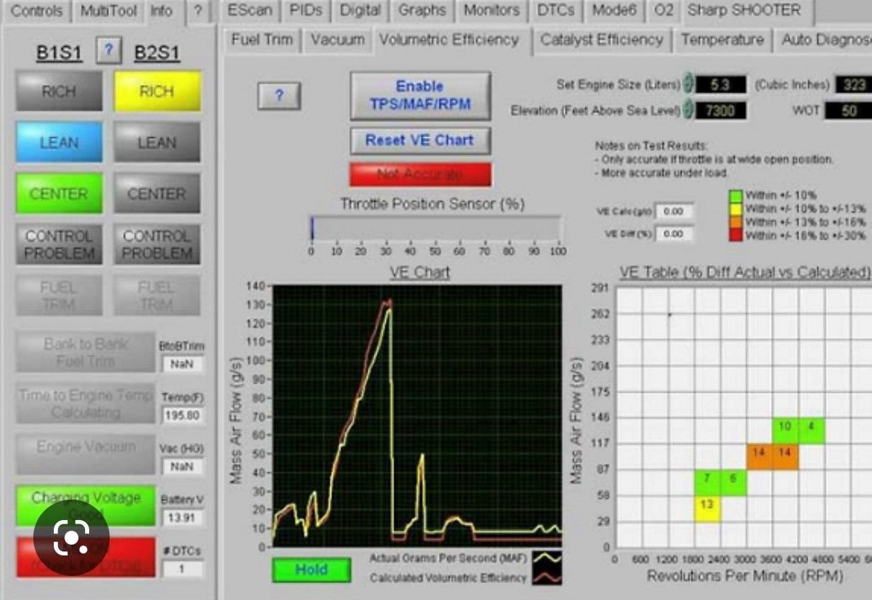

Yes, weak or broken valve springs can cause misfires at higher RPM's but these misfires didn't happen till the O2 sensor was changed....why was the O2 sensor changed initially and were all 4 changed ??...for the P0420 ??...good your friend has a scan tool that can read live data...can he graph with it and what does Mode 2 "freeze frame" data saying for those 2 DTC's ??...what is bank 1 upstream O2 sensor doing from idle to 5000 RPM and then above 5000 RPM ??...is it switching between 200-800 mv's ??...what do the fuel trims look like at those RPM's ??...if the O2 sensor is bad and just because it's NEW doesn't mean it's GOOD !!...I went through 3 new O2 sensors last year before I got a Denso that finally worked...if it is "stuck" over 800 mv it will be "pulling" fuel and that bank will be lean which will give you misfires...the upstream O2's should go rich at WOT...also as far as the P0420 is the downstream O2 sensor fairly steady around 700mv's or is it oscillating like the upstream when the cats are hot...if bank 2 fuel trims are positive and the bank1 is negative under load your cat may be starting to plug up...if I can get some numbers from you during a pull I can check the VE of the engine to make sure it is pumping air correctly...if the VE is good it's not an "air" side problem ...I've been using this cool scan tool recently that will let me know by just going around the block if I have an air or fuel issue with no guessing...the chart on the left is the calculated vs. actual VE...if both are the same the air side is not your problem.

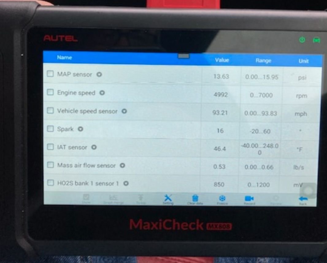

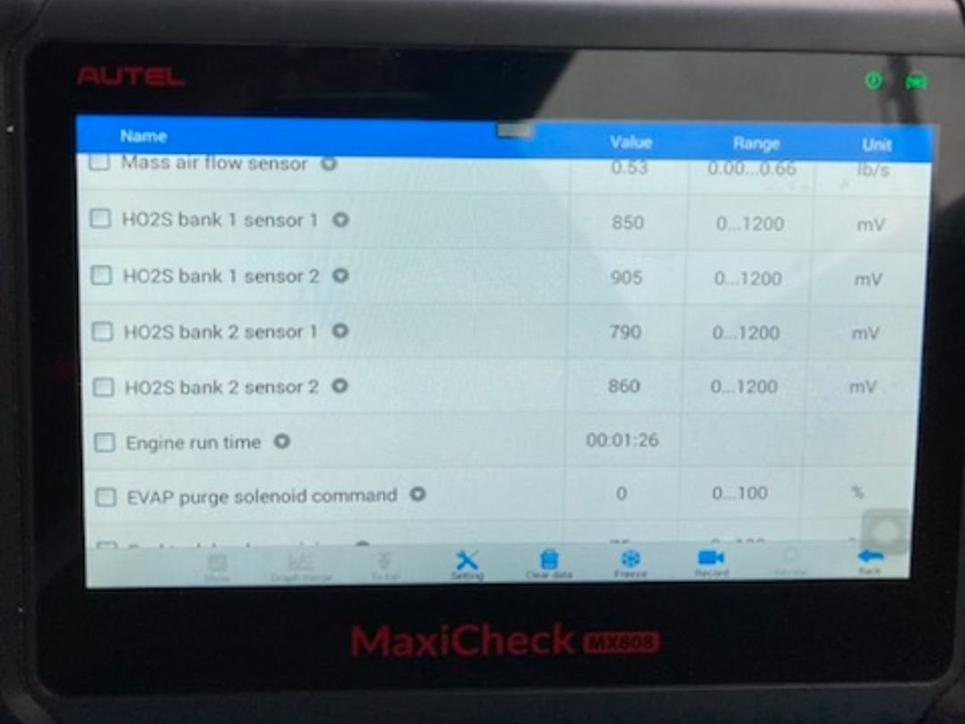

We seafomed the top end, and put the original top O2 sensor no change. Swapped #1 and #2 coil and wire, no change.
Old Jan 22, 2023 | 09:46 PM
C5 Diag's Avatar
C5 Diag
Moderator, Tech Contributor
Posts: 15,595
Likes: 4,055
From: Cape Coral, Florida
I see you’re in open loop so I’m guessing the engine was misfiring at that time…only a single cylinder misfire ??…were the upstream O2 switching between 200-800 mv’s ??…in open loop the O2’s aren’t used in the fuel calculation…I’d swap injectors if it’s a single cylinder misfire and see what happens…I see you have the MX808 and I don’t know if it has injector balance testing under special functions but if it does and you have a fuel pressure gauge you can do that test instead of swapping injectors…you can do a quick test for mechanical integrity of the engine with a “cranking cadence” test…gas pedal held to the floor while you start the car…it will only crank but listen if the engine has a steady cranking sound.

#1 and #3 missfiring pretty bad i think #3 missfired 300+ #1 200+ and #5 just under 100. Bank 2 is as near perfect as it can get. Now the missfiring is coming in at 4500 RPM's.
Old Jan 22, 2023 | 11:32 PM
C5 Diag's Avatar
C5 Diag
Posts: 15,595
Likes: 4,055
Can you graph the O2’s being your in OL and fuel trims don’t give us any guidance ??…looking at just a number doesn’t tell us anything…I would still do a VE test…you can record with that scan tool and you would normally use the highest MAF reading and RPM in the calculation at WOT…do you show an fuel injector pulse width data PID on that scan tool for bank 1 and 2 ??…that is a good one to look at.
