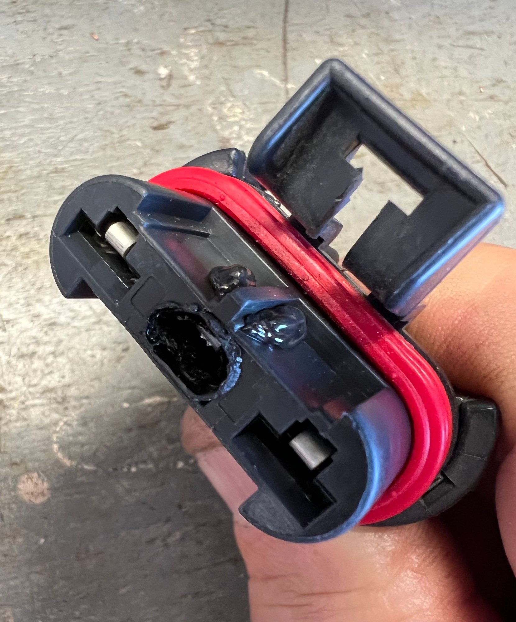

I had the exact same thing happen to my 2011 GS.
1. Engine Hot .. A/C turned off message on the DIC
2. Coolant temp gauge reading 100 (lowest number on the gauge) even when the engine is up to operating temp.
3. Coolant temp on the DIC reading XXX
_____________________________________
I replaced the coolant temp sensor, but after a couple of days, the same thing happened again, so that was no fix.
And a couple of days after that, my electrical connector to the radiator fan melted and of course, the engine actually got hot since the fan was not running anymore. I am thinking that it all had to do with the fan connector burning and not making a good connection (until the connector completely burned up).
Anyway, I removed the connector and hard-wired the fan (now eliminating the connector) ... and I don't have the problem anymore.
Problem fixed ...

BTW ... My bet is that when you check the fault codes on your car, you will have a P0116 code ... even though the 'check engine' light never came on.

And actually snap the 2 pieces of the connector apart and look to see if there is any damage to the metal contacts where the two pieces snap together.
BTW ... Has any 'tuner' said they increased your radiator fan speeds sometime in the past ?
Set the max fan speed above 90% and it will sooner or later burn up the connector.

This was Turbo6TA’s connector we found a few weeks ago !!

Since all the wiring and grounds in my very low miles 2011 GS are in perfect condition, I was going to order a brand new E38 ECM (computer) for my car because of this problem, but 'C5 Diag' talked me out of pissing away money for a new computer !

My supercharged GS also has a Redline Motorsports tune.
I don't think Howard was the one that increased my fan speeds ... This was done a long time ago when Chuck 'CoW' was tuning on my car (and also had me install a 160 degree thermostat).
After re-wiring the fan, I have now set my fan speeds back to OEM speed settings using my HP Tuners.
