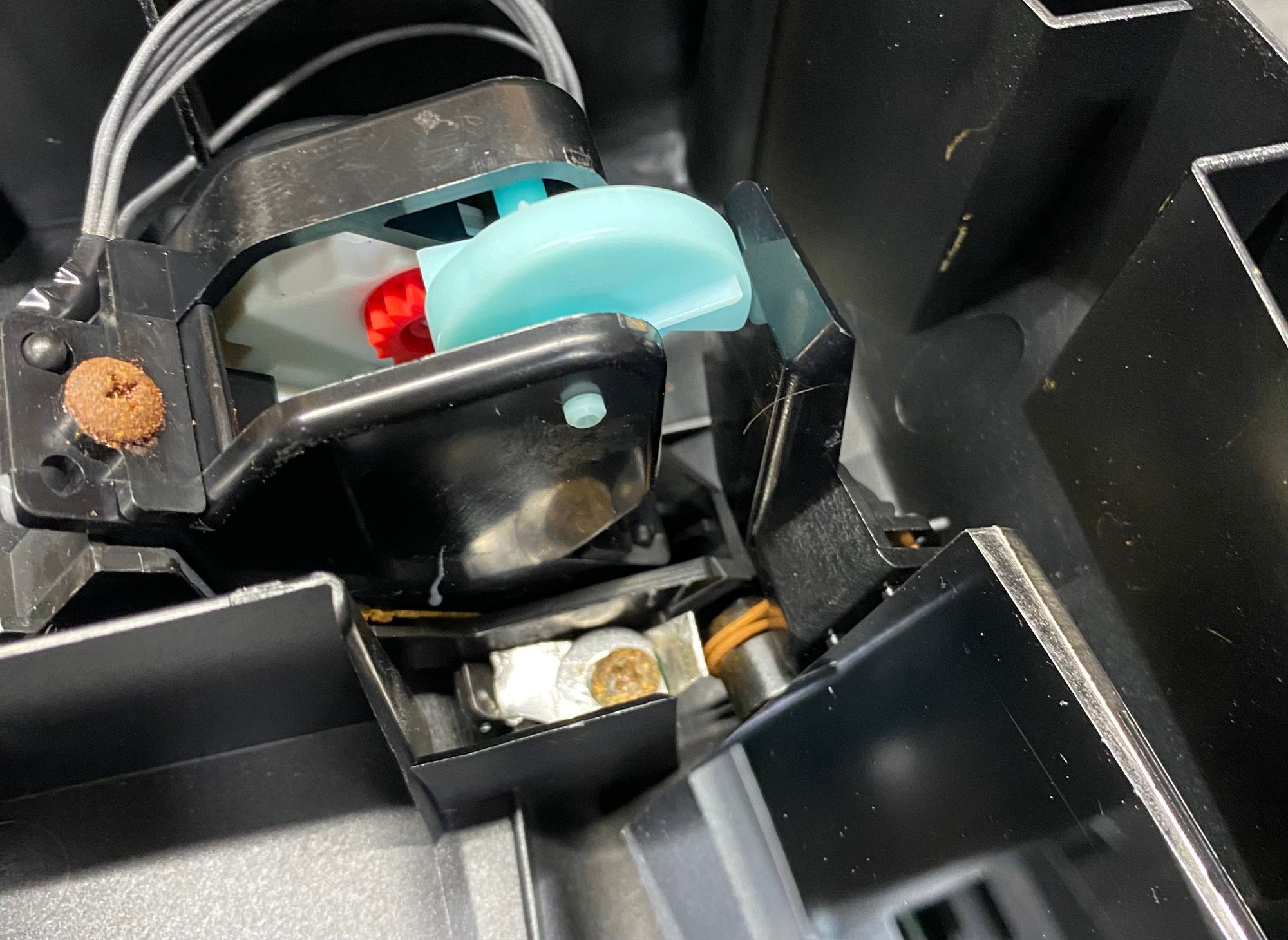

Here is what mine looks like, it is not projecting onto the windshield
. What is wrong?

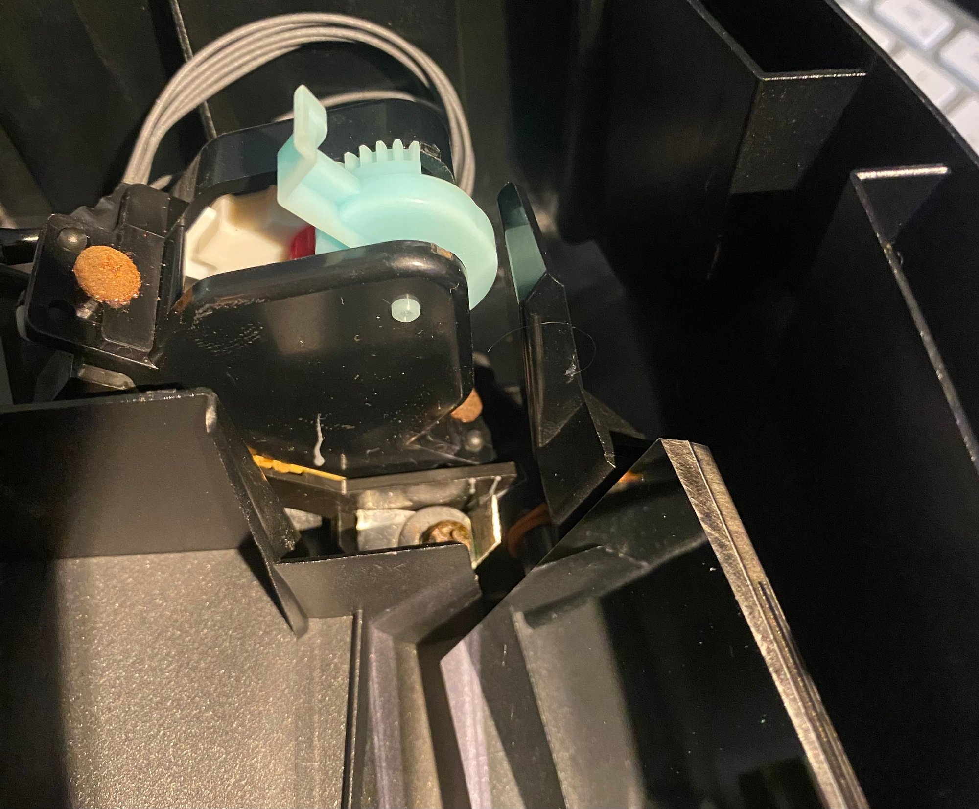

Another pic

https://www.corvetteforum.com/forums/c6-tech-performance/3803751-c6-hud-repair.html?highlight=hud+repair
This should give you a good head start on the issue.

Thank you, I used this post to fashion brackets for broken out mounting tabs. Excellent post! I guess I didn't pay attention enough to the blue stepper motor arm's position. It looks like it is pointing up.
Such a pain in the *** to remove and install the HUD unit. I used a ratcheting closed end wrench (not long enough), long closed end wrench (1/8 turn at a time). My hands are big, so it is very tight, cuts up my hand, take about 45 minutes to get the nuts tightened or loosened. I have slotted the tabs as well, but I need to flare them a little more I guess to make it easier to put in position.
Thank you, will try again!

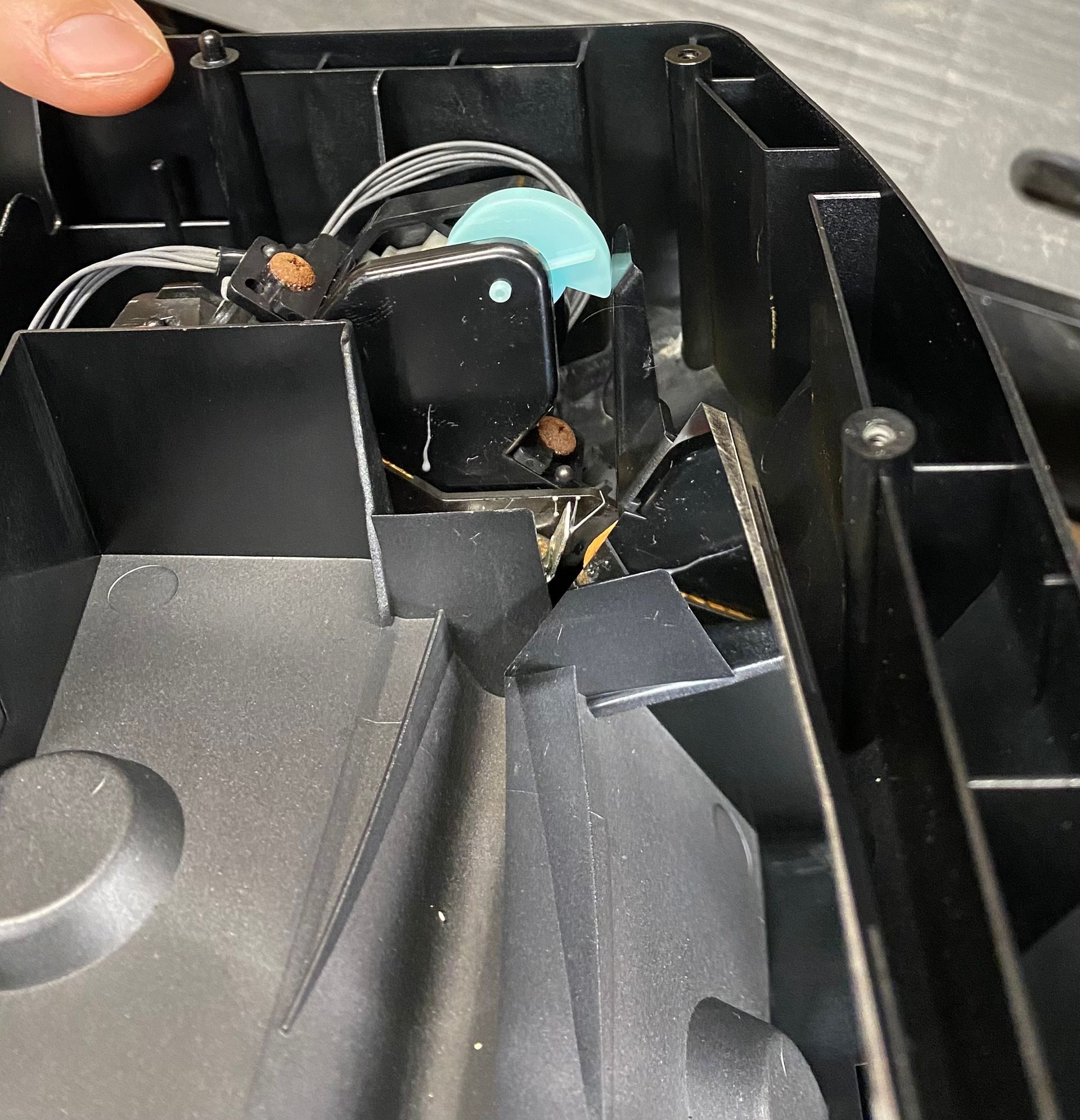

Here is another angle with the motor arm sticking up
To HUD mirror alignment
