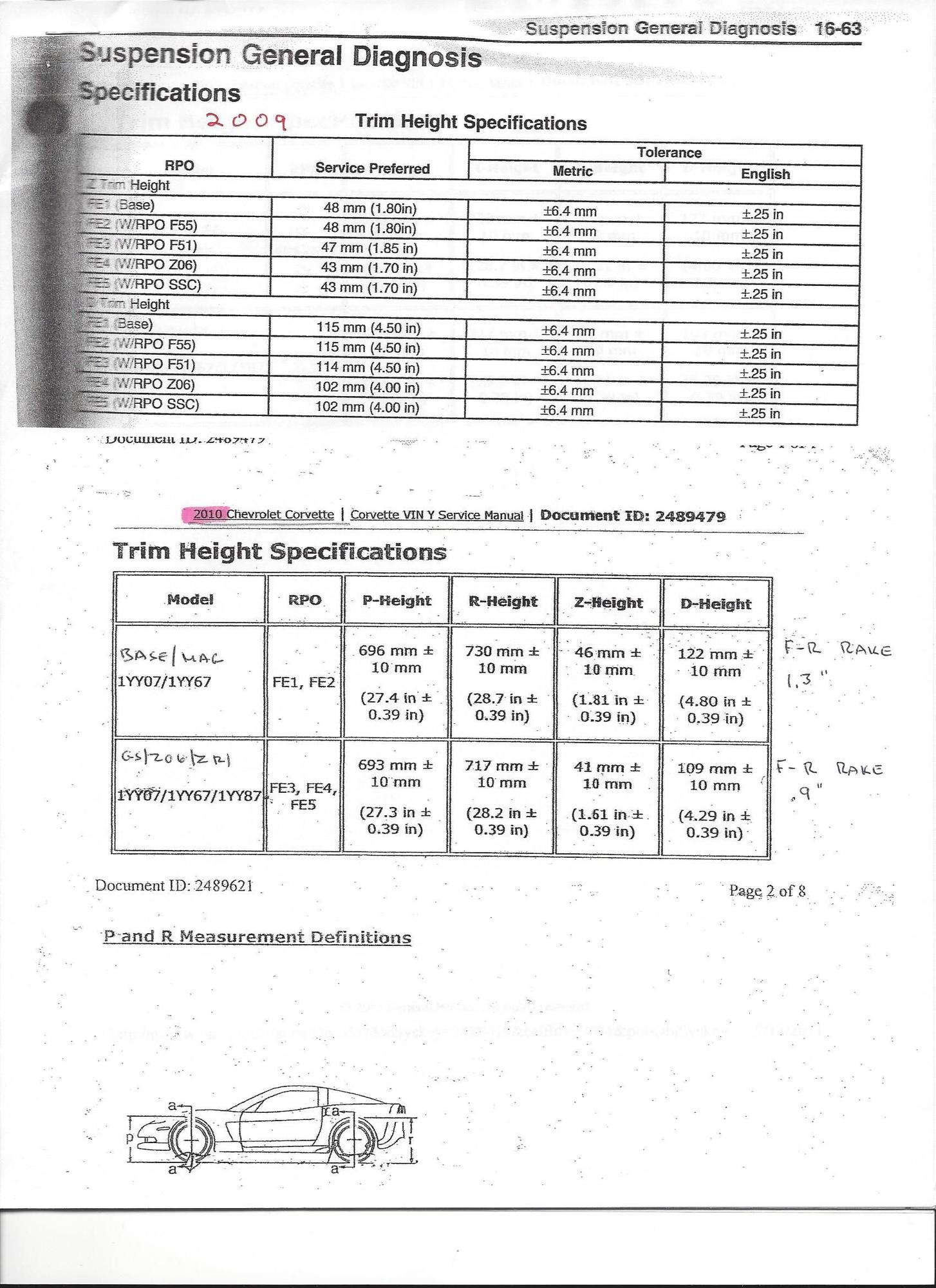

New to me 08Z purchased already lowered but looking to possibly raise the front. Does anyone know the stock front vs rear ride height when measured at the fender? I’m currently measuring front fenders at 26” and rear at 27.5”. Looking to possibly bring the front up a bit but trying to figure out what the stock rake is.

Stock GS, Z06 and ZR1
Front:. . . .27.3"
Rear:. . . . 28.2"
Attachment 48331736
