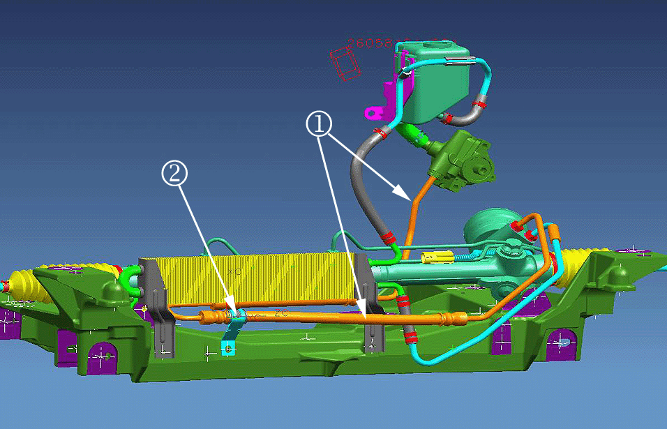

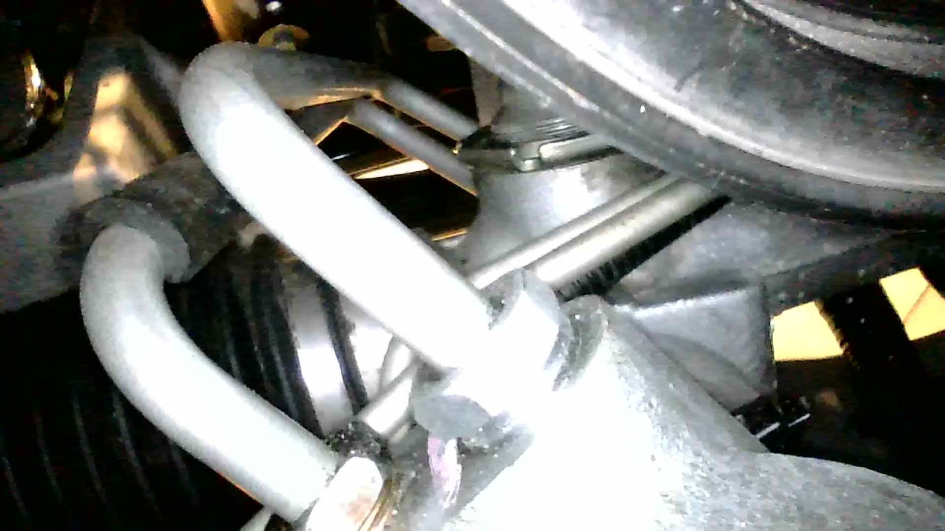

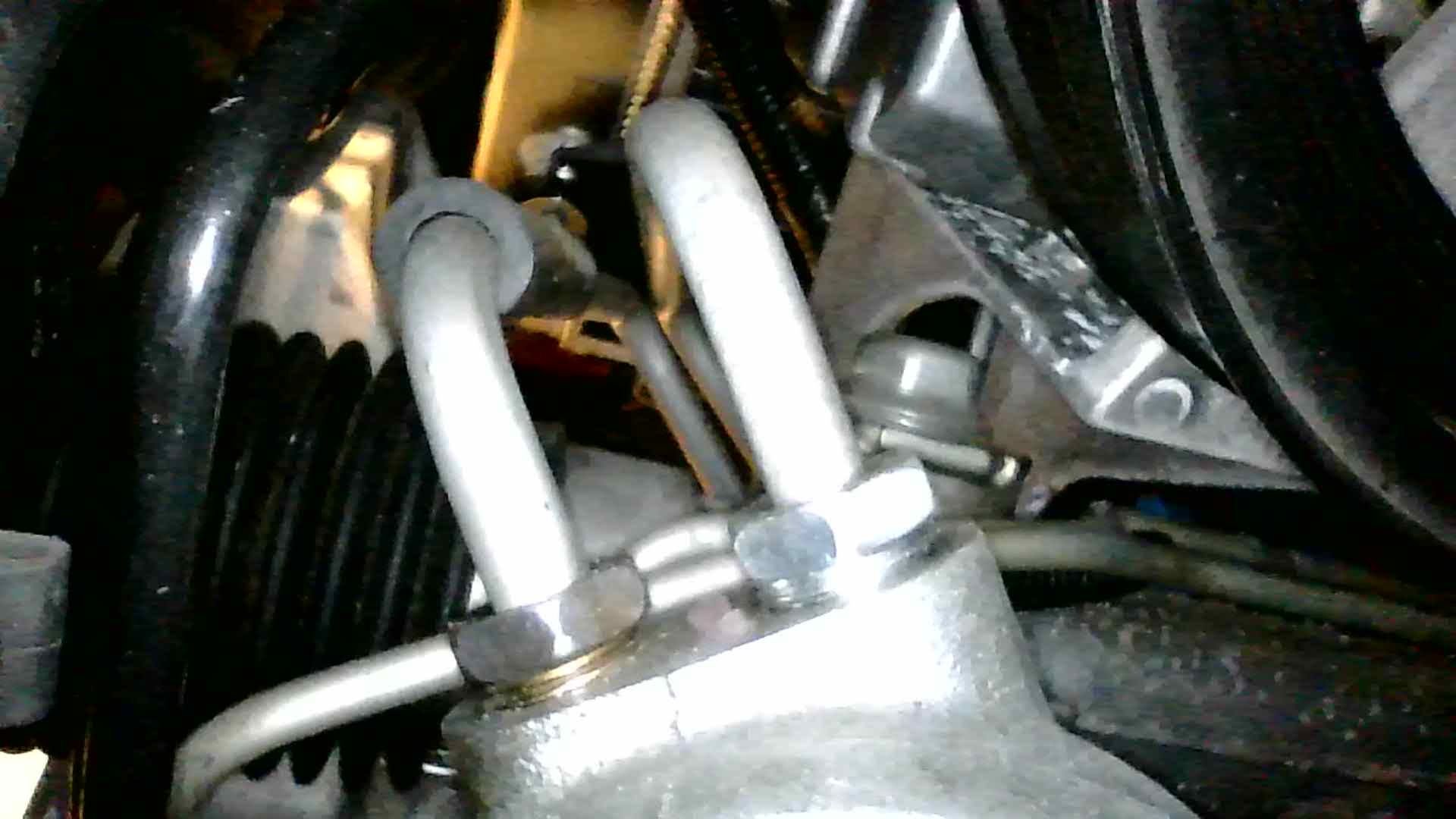

Originally Posted by RICH 28
On my 2005, those power steering lines do not cross each other. I made a mental note of that when I had removed my power steering rack three weeks ago.
Here are some crunchy inspection camera photos of the lines on my 2006 power steering cooler-equipped Z51 C6:
GM's routing diagram:
