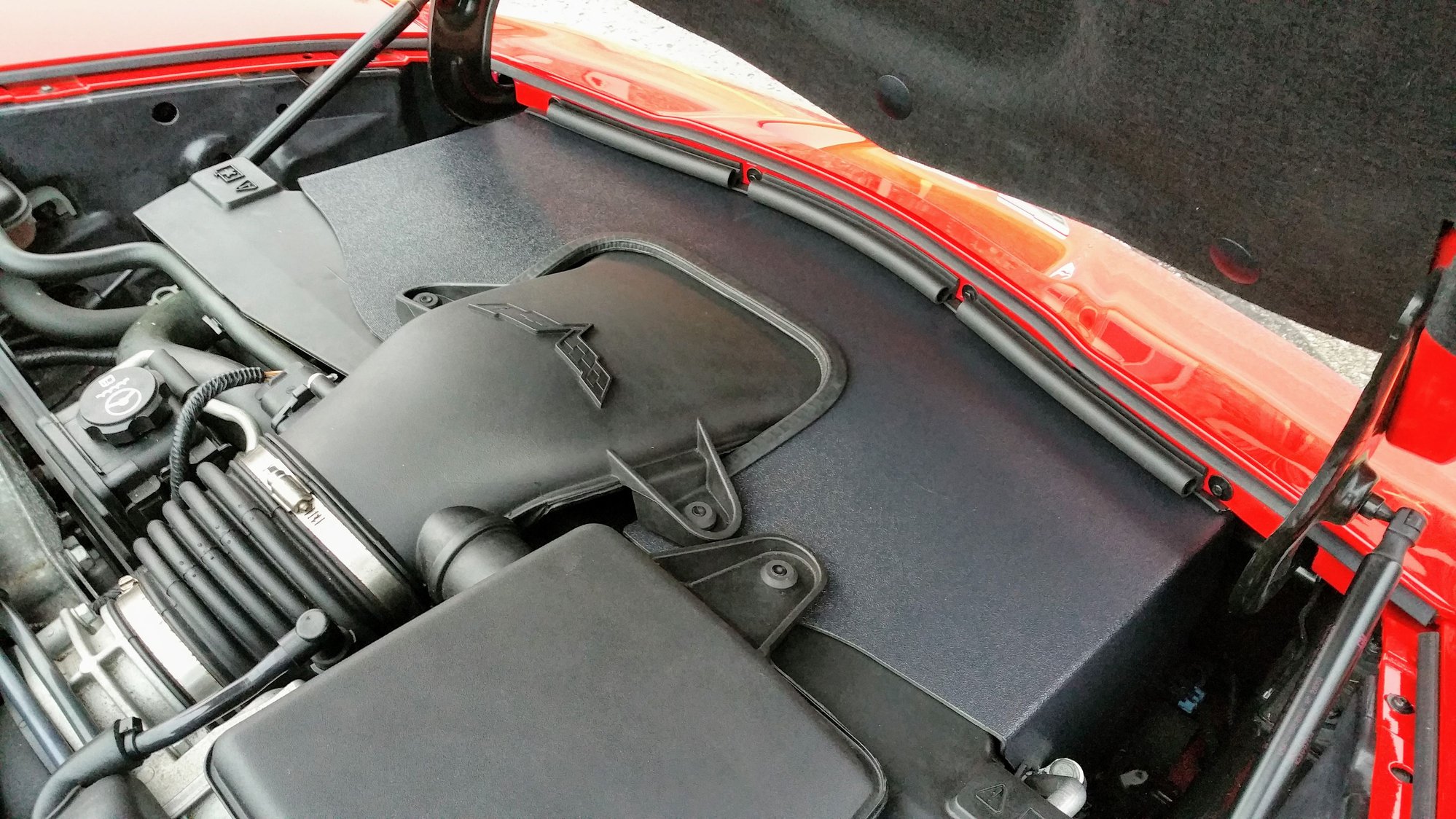

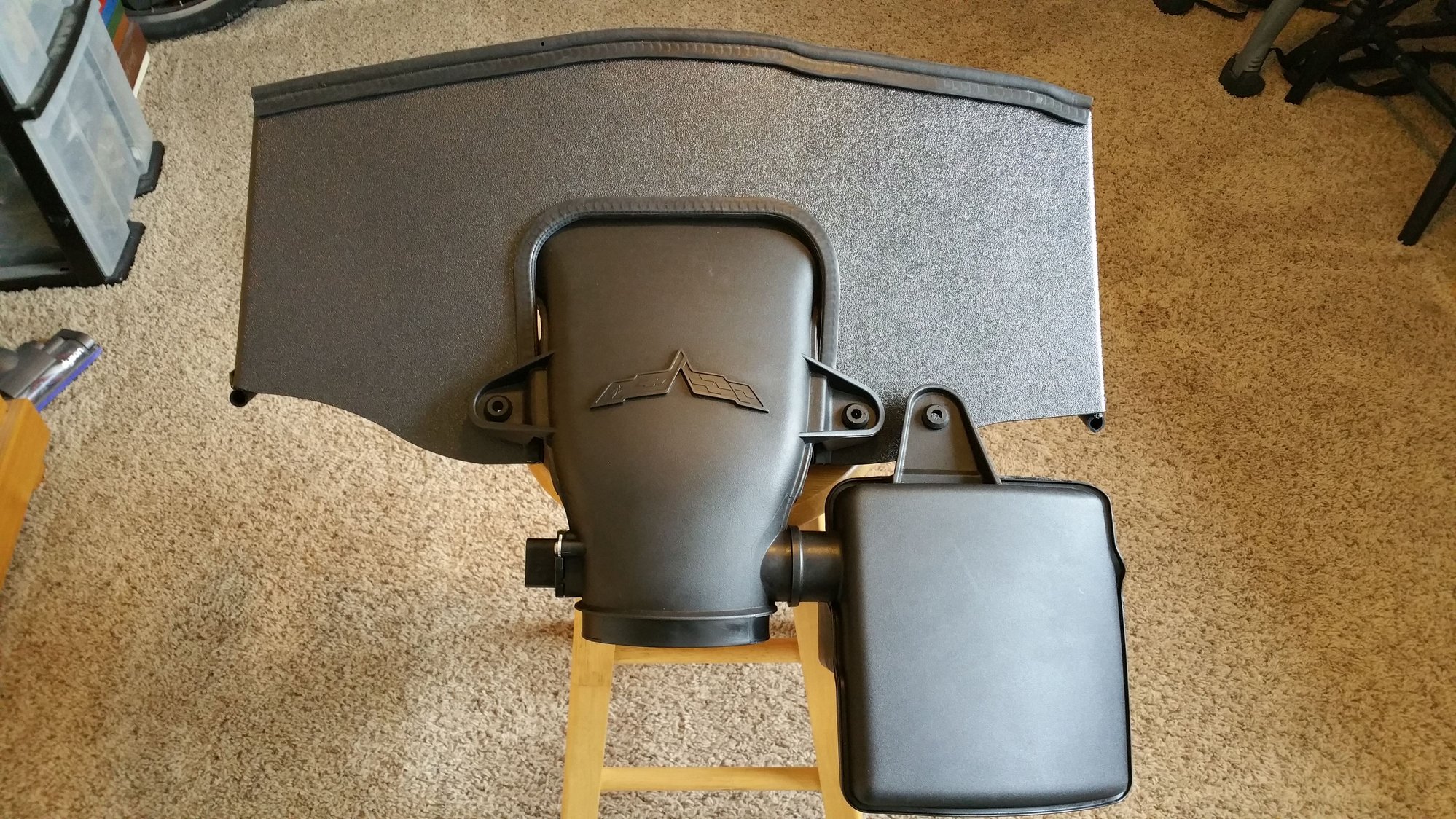

Best, most cost effective setup is either a GS or Z06 intake with a shroud to isolate the intake from engine heat. I think in 2010 all Corvettes changed to the GS/Z06 intake. The GS and the Z06 intakes are slightly different in that the GS has a Helmholtz chamber.
I had bought an uncut shroud from Haltech and trimmed it to fit my GS intake a few years ago. When I installed and E-force, I modified to shroud to work with the E-force intake which is essentially a K&N filter.

Halltech sells just the shroud that you can modify yourself: Generic Beehive™ Heat Shield
The rubber trim that I used, I think I bought it at an Autozone. But I think the shroud does come with a few pieces of rubber trim.

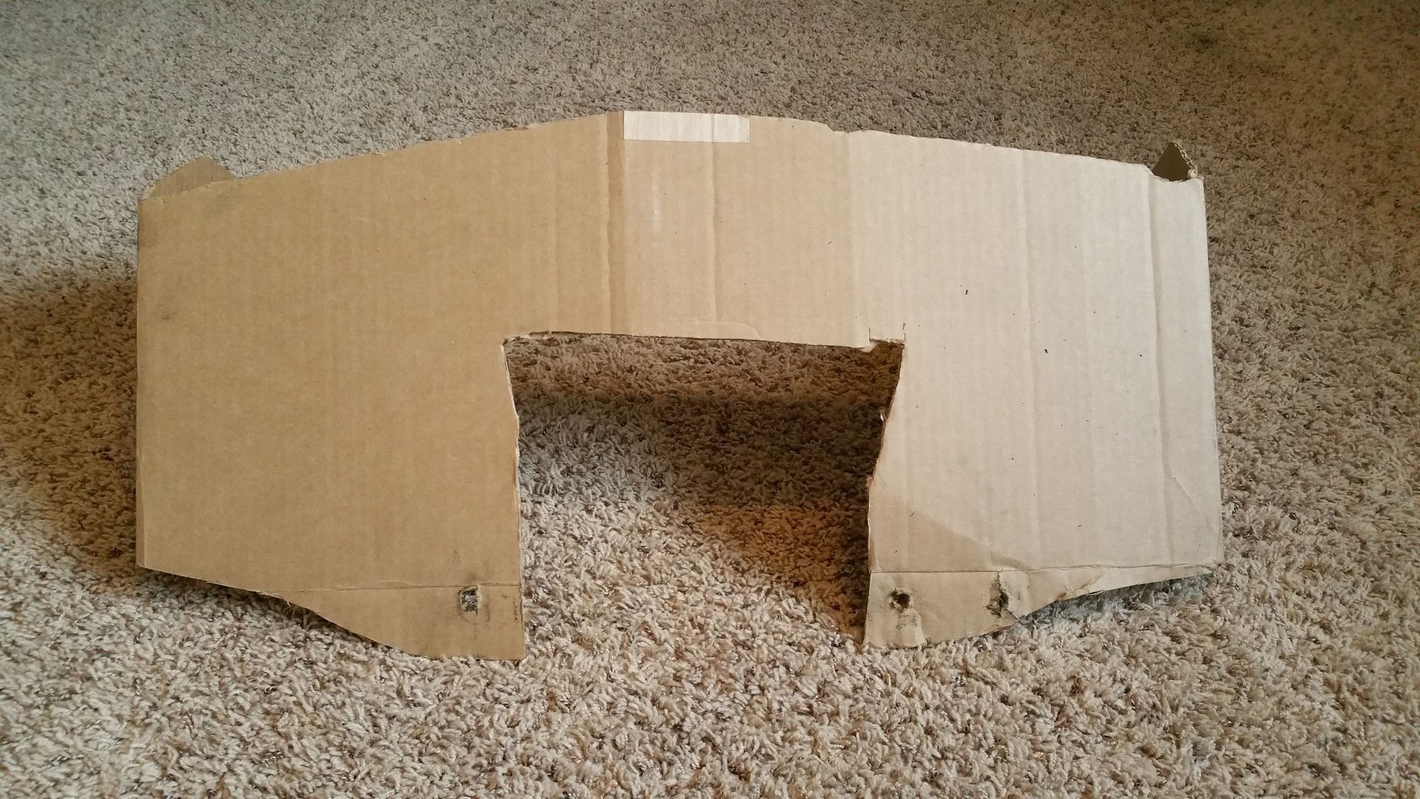

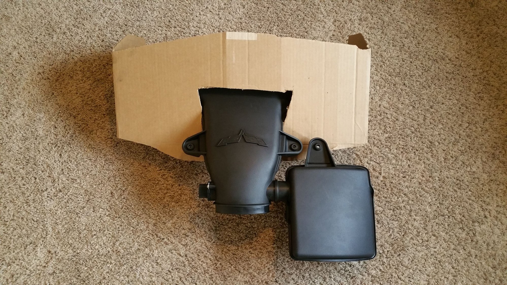

As for trimming and how much is required, it just really depends on your car and how precise you want to be. The easiest thing to do is use a piece of cardboard so that you can make a template for the final cut. Just cut it to fit a little at a time and once you have the fit like you want it, then cut the actual shroud to make your cardboard.
