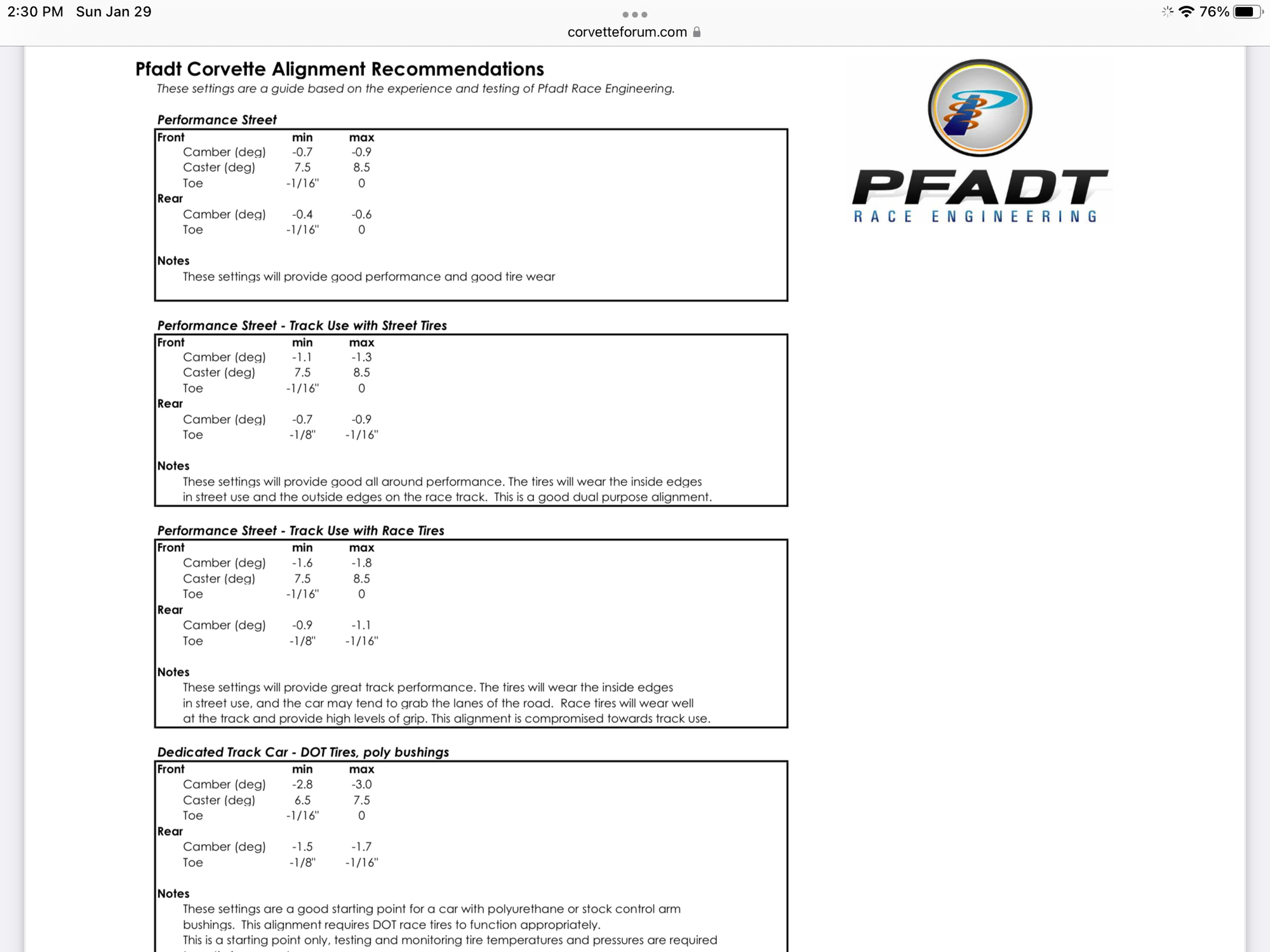

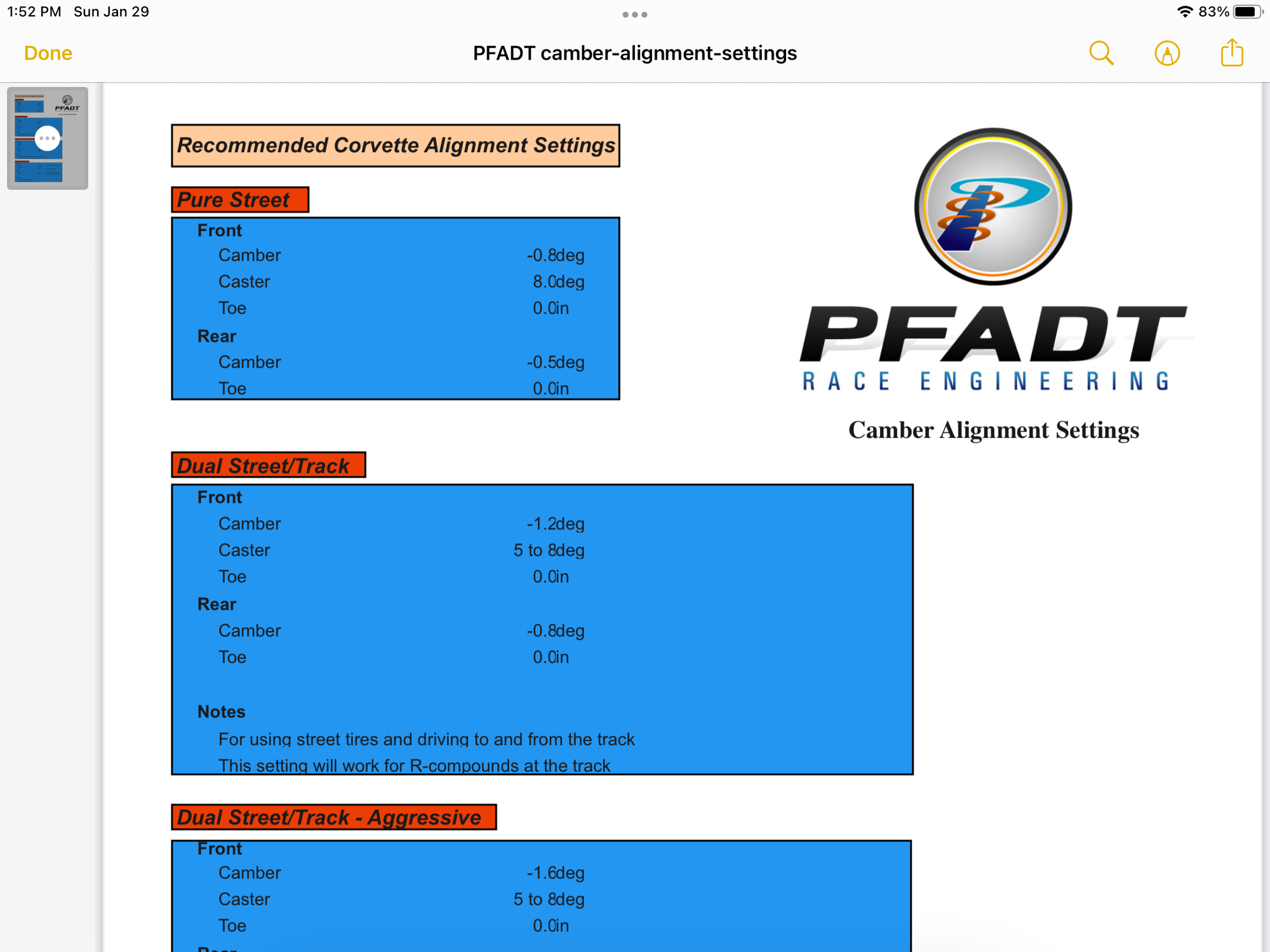

Factory alignment specs will have it pulling to right or left. You’ll notice inside of front tires wearing out before center and outside of tire.
I couldn’t understand why the inside of my front tires were bald and the outside still had plenty of tread……factory specs….
Went with Pfadt specs and tires are wearing fine and even, no pulling whatsoever.

So how do I get the Pfadt specs and what would I do just take a print out of them to the alignment shop?

I am not sure a dealer will do this for you. I went to an alignment shop and gave them the street specs and they set everything to them.

They might. I know some places will only do it according to the VIN for liability purposes but the place I go might do it. So that caster, camber and toe is all I need to give them?
My car is strictly street with no track time so I don’t need anything too aggressive, just go straight lol

That what I went with. Street specs only. I just drive aggressively also, no track stuff. My tires wear much much much better with these specs now. Here’s another spec sheet I found shows max, min.
Thanks bro, I’ll try to get the shop to do this for me
