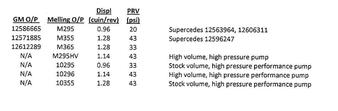

I saw it last night. I don't think any of those pumps would make that much pressure in a real LS2/LS3. Or at least I hope not, since I just put a Melling in my rebuild and am installing the engine next week!
Here is the various flow rates and pressures.....I'm sharing because it took me WEEKS to find this!

No high volume standard pressure?

The HV std pressure gave the most HP on the show. When I did my cam, I reused my factory pump. I get enough pressure to keep me happy.
