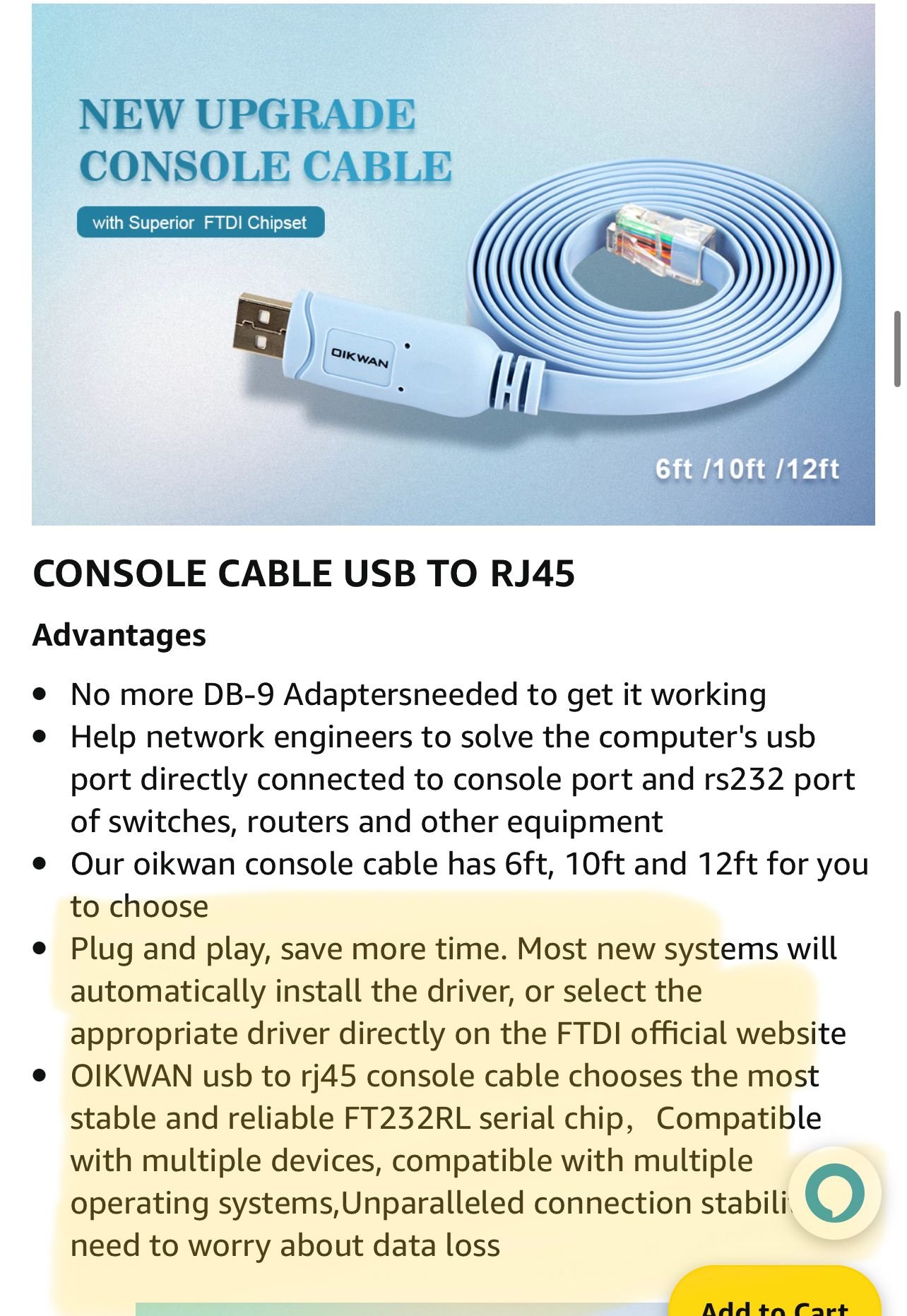

So I purchased this cable below.
my question is what driver do I need? I’m so confused as to where to look, they have drivers on the website here “ Drivers “ FTDI chip. I’m going to be reprogramming my BCM using @Dano523 tutorial linked here BCM flash/Program Dano guide I have the tech 2 clone with the Candi ect. I plan on doing the tech 2 legacy pass thru sub to sps $40 ect.
this wire I ordered off Amazon is throwing me off more than the flashing guide is tho lol.
any direction on the correct baud and FTDI driver ect would be greatly appreciated.

Default Solved the puzzle Pat
Never mind maybe I’m slightly retarded. Lol turns out drivers self installed and it’s not a choose your own adventure type 👀.

Where did you purchase it from?

You can buy these at most tech stores. I used them for configuring network switches and routers.

If you can get it work, then that will be a third cable option, verses the two known working RS-232 to usb port cables isntead.

Couldn’t figure out how to get it to work @Dano523 TDS says it communicates, but it also says it does if it’s not even plugged in….so idk what that is about, the FTDI chipset is one of the approved ones on the tech 2 wiki. I ended up just purchasing the one Bosch recommends the
Tripp Lite USA-19HS Keyspan High-Speed USB to Serial Adapter Tripp Lite USA-19HS Keyspan High-Speed USB to Serial Adapter
I tried in theory it should have worked, had the drivers installed changed com to 3 and baud to 11520 or whatever it says to do, put tech 2 into bypass and then chose legacy pass thru and nada. I shouldn’t have an issue with new cable….hopefully….I bought tis2000 software hoping it’s a tech 2 driver issue? We’ll see maybe I’m chasing ghosts,
amazon
