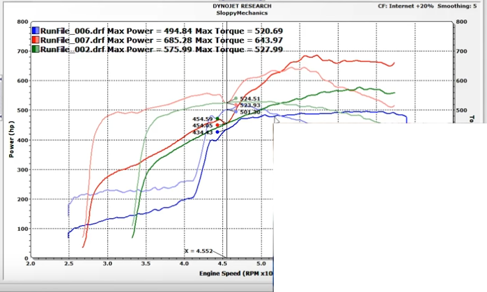

The other styles of blower- instantaneous boost, lets call them roots style or screw type or Eatons or whatever-
These are more for fun than outright performance IMO.
They deliver instant torque, which is great for showing off, tire smoke, sudden feeling of acceleration,
They can give an engine that 'big block' feel.
For example here is a 4.8L with a small blower 'instant' style, a car owned by 'sloppy mechanics' one of the best examples
That is only 292 cubic inches making at 3000rpm 500lbf-ft to the tires on a dynojet!
Instant torque, IMO great for manual trans cars and small displacement engines looking for big block torque.
This is my favorite type of blower for daily drivers and street cars, because I mainly drive on the street from stoplight to stoplight and this type of blower is a clear winner in that respect, as you can't always run a vehicle out to 120-150mph on the street with a centri to really take advantage of that top end performance parameter that they do so well.
Doesn't make the car the fastest- just the most fun to putt putt around with - street shenanigans at lower MPH and stoplight situations stuff, with good tires the area under the curve for low speeds makes up for the lack of top end
