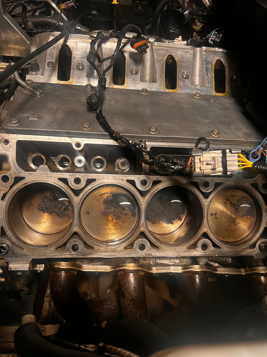

Old Mar 11, 2023 | 09:10 PM
Alex Noell's Avatar
Alex Noell
Joined: Dec 2021
Posts: 15
Originally Posted by ClothSeats
Maybe the lifter bores rather than the lifters themselves.
Exhaust valves hitting pistons 🤦‍♂️
Old Mar 11, 2023 | 09:29 PM
Alex Noell's Avatar
Alex Noell
Joined: Dec 2021
Posts: 15
So with it just being only the exhaust valve hitting the piston would that mean that my timing chain may be off a tooth or two?
Old Mar 12, 2023 | 09:08 AM
ClothSeats's Avatar
ClothSeats
Joined: Apr 2019
Posts: 2,499
Likes: 1,165
From: Northern Wisconsin
Looks like you are on the right track now. Cam timing may be off, or it just may be that it is caused by your new cam having too much lift for those pistons.
Old Mar 12, 2023 | 09:21 AM
Spaceme1117's Avatar
Spaceme1117
Joined: May 2016
Posts: 4,649
Likes: 1,832
From: Erlanger, Kentucky
That is possible but pretty hard to screw that up. I mean you literally line up the dots.
The other possibility is that the cam was improperly ground. If the advance is off by a few degrees, it can cause what you are seeing. To check that, you will need to degree the cam. And this does happen from time to time. Seems to happens more commonly with cams ground by Comp Cams. Not sure who BTR uses for their grinds or if they do it themselves.
Another option you could pursue would be to notch the pistons. But I would check the cam first and if it is wrong, I'd get a new one. And obviously check it as well.
