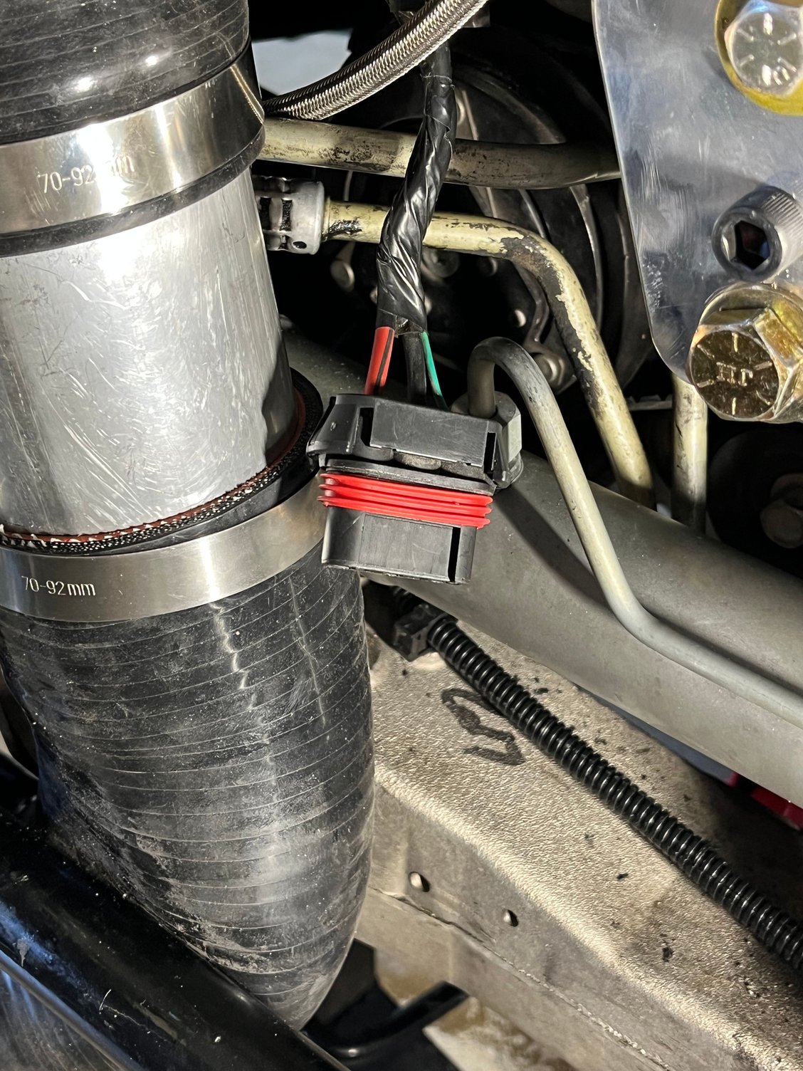

I’m installing an A&A kit on my 05 C6. Just finished installing the volute piping and for the life of me can’t find where this connection goes. Any guidance would be greatly appreciated.

It’s the cooling fan connector…a 3 wire connector !!…I would closely check the red and black terminals for pin fitment before reconnecting.

Thank You 🙏🏻 That would make sense why I can’t find the female connection. The radiator and fans are still out of the car.

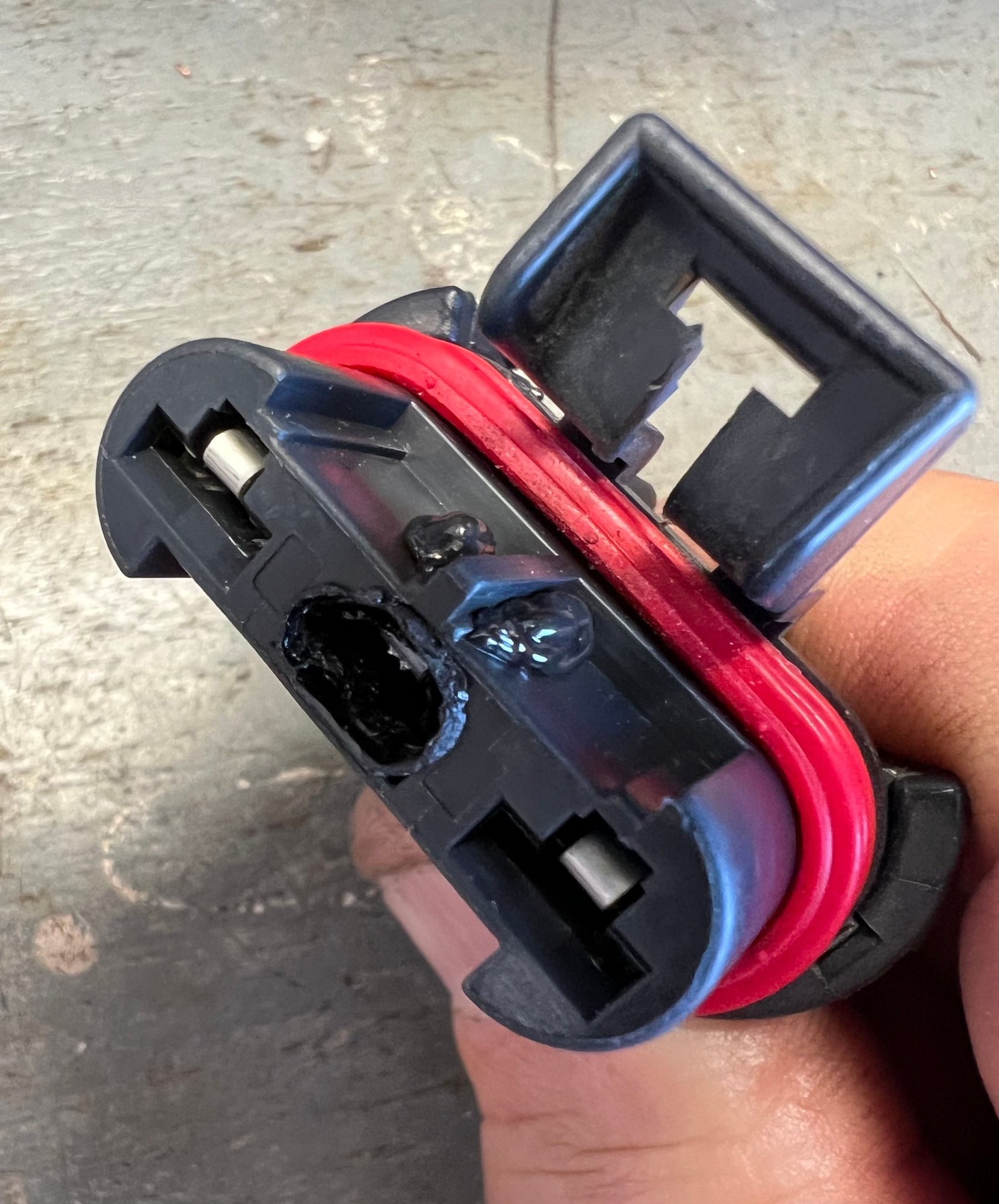

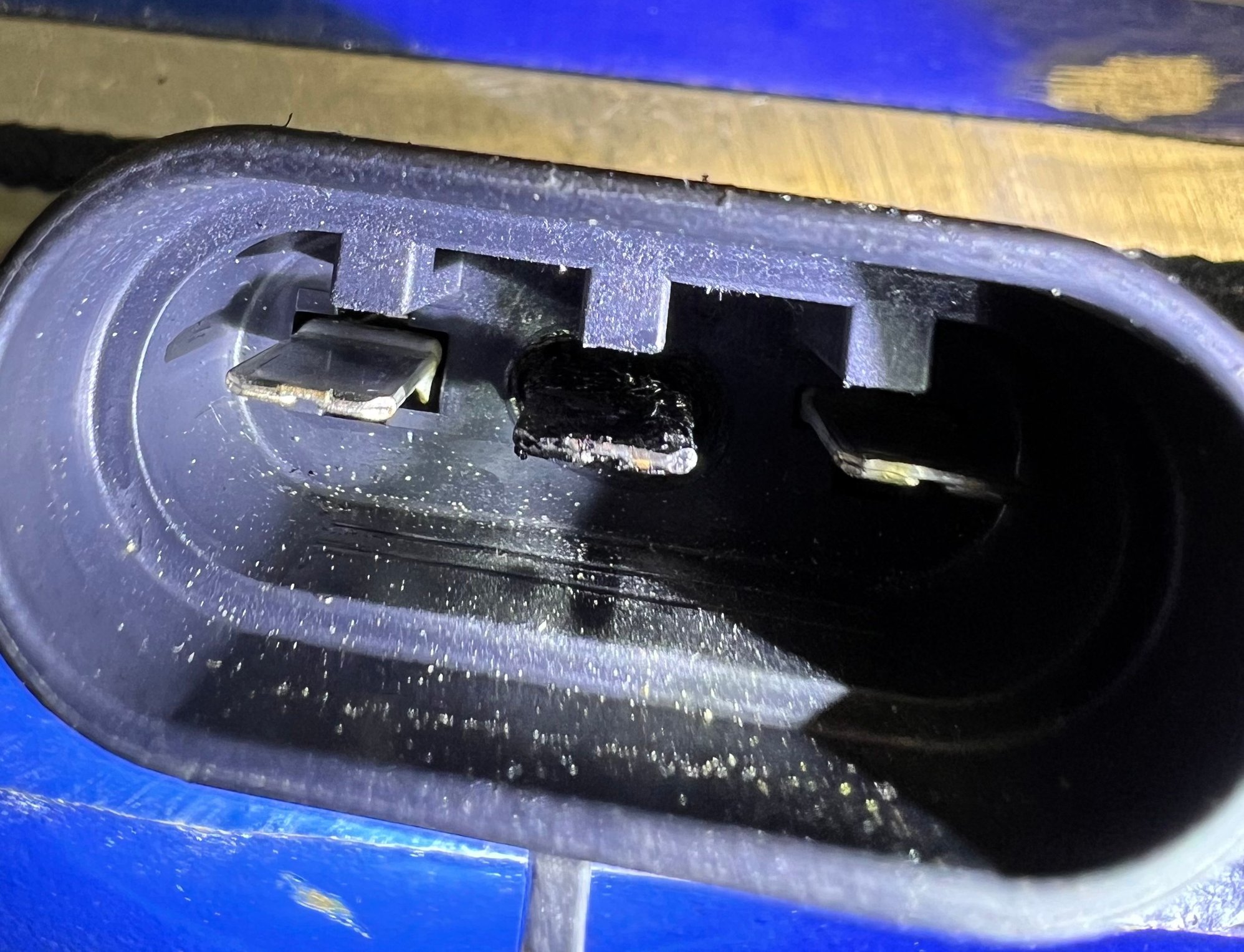

If you have a faulty connector this can happen to yours !!
