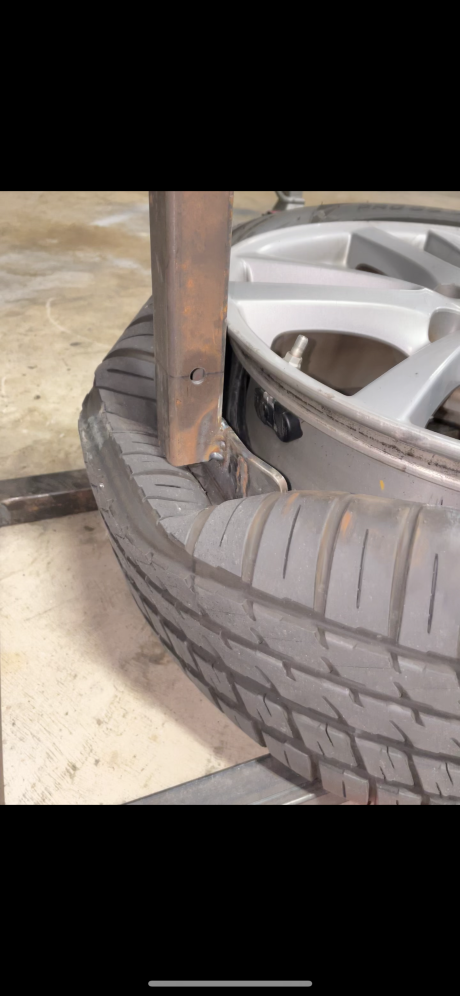

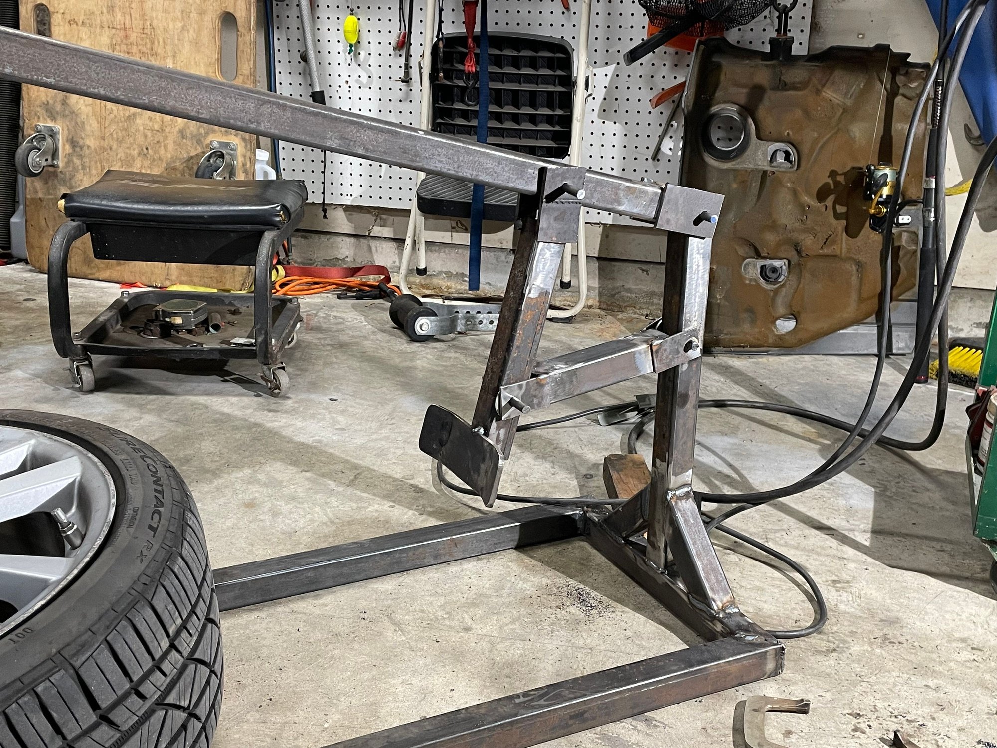

I built a device a few months ago to try to change a couple of TPMS in my Lexus IS250. It's not the easiest thing to use, but it did work fine for that car. It bolts to the floor and with some effort, it will break the bead. I bought 4 new TPMS sensors off FB Marketplace and an Autel programmer also from the same source for about $200. Local tire shops here want $95 per TPMS installed. It worked fine on the Lexus with low profile tires......unfortunately when I tried on my brothers Tahoe, it did not end well. A 4 inch tear was quickly made in the thinner sidewall. Thank goodness for roadside hazard warranty.
You can buy a similar tool at harbor freight, but I build this from leftover materials i had laying around. It just cost me a couple hours welding and cutting. It breaks down easily and stores in the corner of the garage. I'm not sure if I'll use it on the vette when it's required.
DIY bead breaker
Paul
