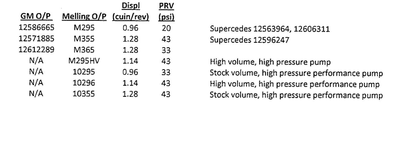

GM Racing literally recommend we shim our oil pumps 150/1000” 20 years ago, so I always shim or replace. Now we know the oem pumps cavitate above 6k
anyway, which pump did you buy. Melling makes it very difficult to find the right, slightly higher volume and/or pressure pump.
I went with the 295hv, and yes it’s pretty high cold,

Here is a complete rundown of volume and pressure springs
