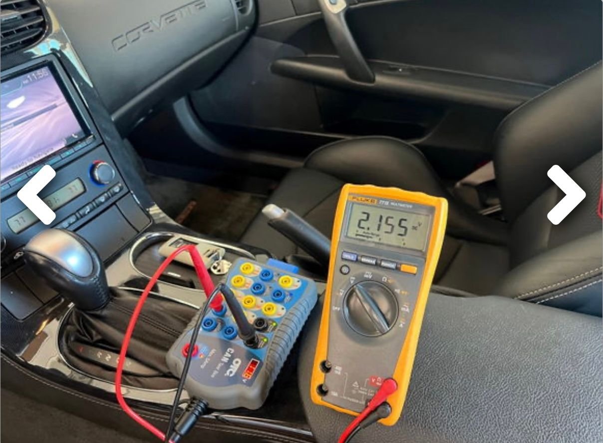

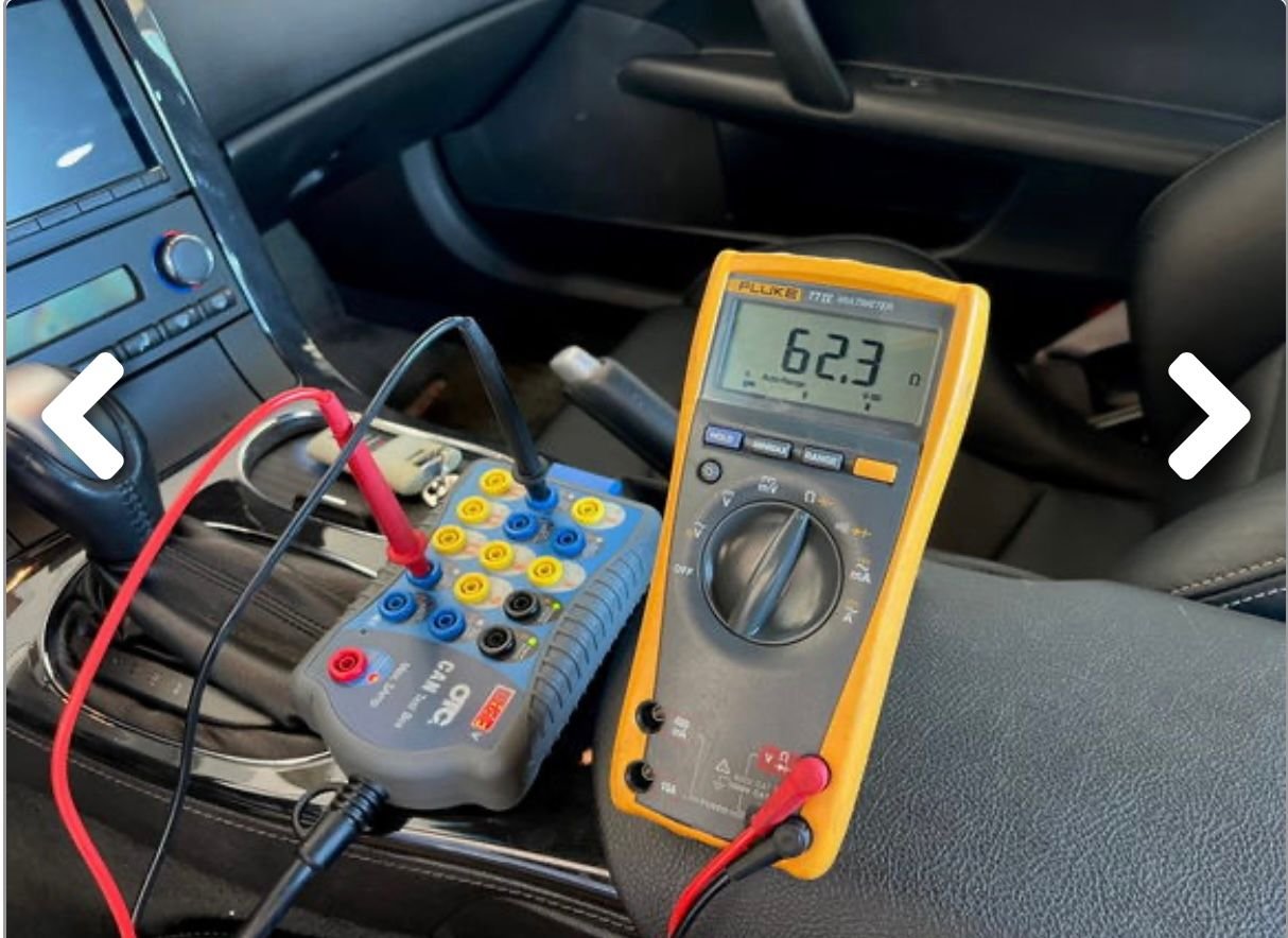

With a no crank no start you can’t rule out a communication issue…funny no “U” codes are stored…when it doesn’t start you can try checking the voltage on pins 6 and 14…CAN high and low…both should read about 2.5 volts…if you take an ohm meter and connect to both 6 and 14 you should 60 ohms…best to remove the negative battery terminal or wait about 20 minutes until all the modules “go to sleep”.
