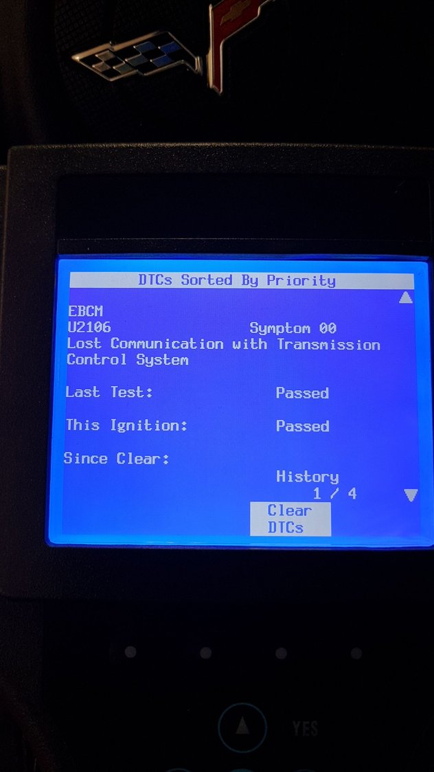

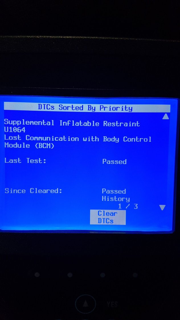

Hi! I have now drive my Vette Many miles after I delete all old codes and yesterday I get Same problems again Engine reduce power An my car Stopped. I take away Negative pole from battery and waiting 5 minuts. Then I started and everything works fine and no problem to get home. Today I take my new GMtech2 and check the codes.
EBCM U2106 Lost com. with TCS
Body control modul U2100 Canbus com. Symptom 00
Body control modula U1096 Lost com. with Instrument panel cluster
Suplemental inflatable restraint U1064 lost com. with body control module
What can I do are my TCS broken and needs to be replaced.
or what can I do?
/Goran

When you say your car "stopped" do you mean it shut off ???...you have a lot of "U" or communication codes...I see you have a Tech 2 so see if you establish any communication with the car or does the scan tool keep saying "waiting for data"...will the car even start now ??...if you have a DVOM and can look at voltage and resistance we can make some checks of the CAN bus system and the Class 2 serial data system...the U2106 is lost comm with TCM...your TCM sits above the ECM in the wheel well behind the right front tire...many comm issues involve modules located outside of the car since they are more exposed to the elements...at least the ones I've seen anyway...if this possible communication issue is intermittent DVOM is not the best tooling for this...I use a labscope because I can see any comm issues the second they pop up.

Yes I mean Shut off. I attaches some pictures from my Tech2, Better you look at my photos!
I am completely new to this and hope you interpret the pictures. 4 Pictures
