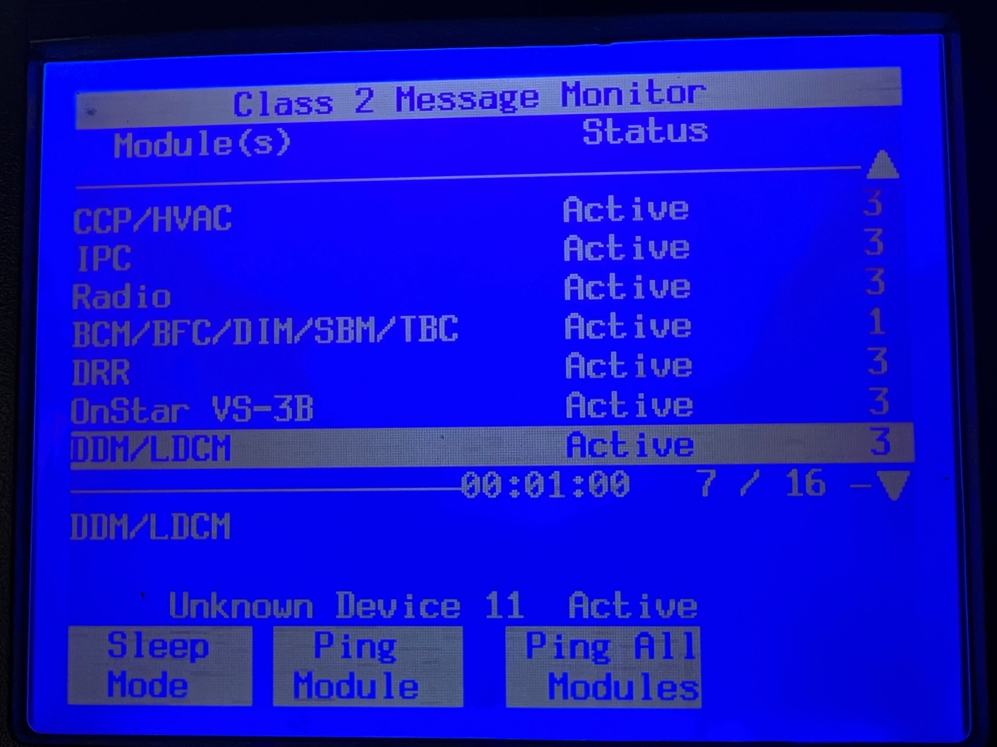

I cant find any"Class 2 Message Monitor" Yes, I do Ingition to run position and use Candi Modul.
From the beginning, Sart up push enter, F0: Diagostics Push Enter. Then 2005 Push enter. Passenger car Push enter. Chevrolet Push enter. Y Push Enter.
Now I come till F0 Vehicle Control System. Push Enter. I come to Computer/Intregrating System Push Enter. Then 4 speed Automaric Push Enter. Onstar not responding.. Press Continue on Soft4.
I have delete all Codes everywere. I'll take a test ride tomorrow if the weather is nice, and then check with the engine running to see if I can find any codes.
Continue once more Soft 4 Now see attached pictures.

If you can’t communicate with the VCIM Module (Onstar) you may have a communication issue…I don’t know where you are looking in the scan tool but go to Powertrain, Chassis, and Body and see if you can read live data in the modules…”Data Display”…if you can’t communicate you’ll have to further diagnose this…best to seek professional help !!…have you installed some aftermarket equipment like a radio lately or something you keep track plugged into the DLC (where your scan tool plugs into) ??…one of the members had a communication issue and his was his aftermarket radio he added.
