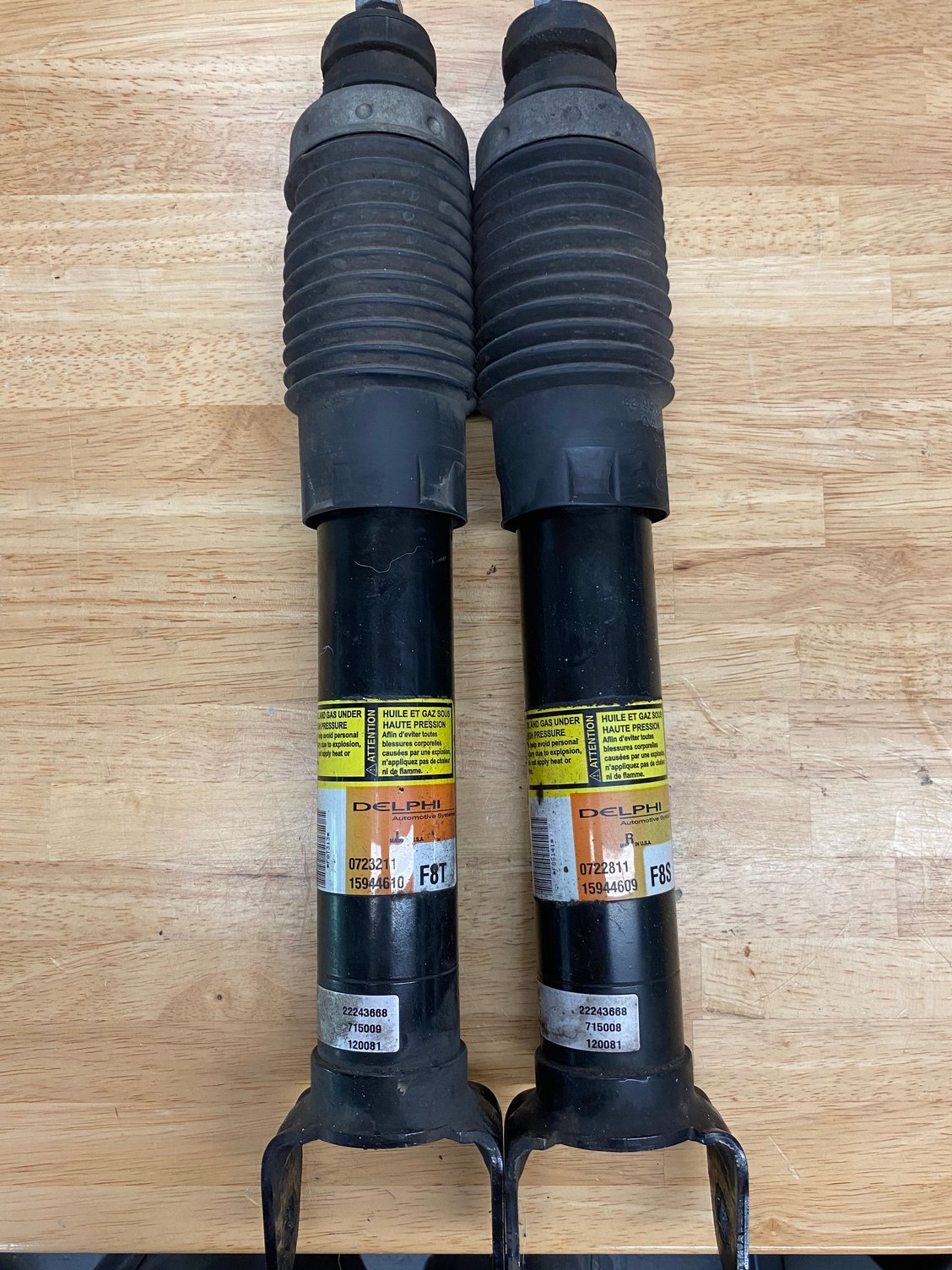

I have a nice pair of "non-leaking" rear shocks that came off my 2008. I'm selling for $200 shipped.

Although the price is outrageously good, '08 shocks only work on '08-'13. The OP has a '07 and even though they look the same and will physically fit, they are slightly different internally..
