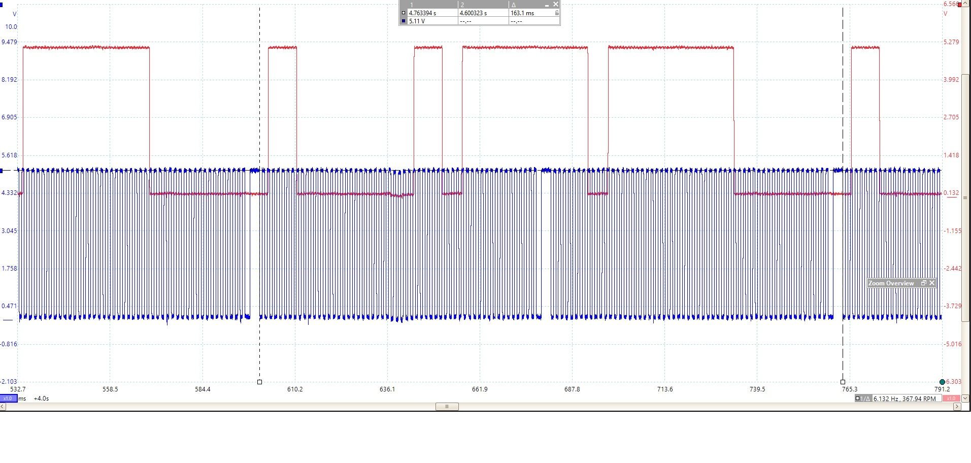

Can the scope thing be done with the sensors in place ?

I did my scope reading by accessing the ECM and using two piercing probes to get onto each signal wire…fairly easy to do…I believe your LS2 also has a 58X crank and 4X cam as my LS3 does…I moved this thread to Tech.
