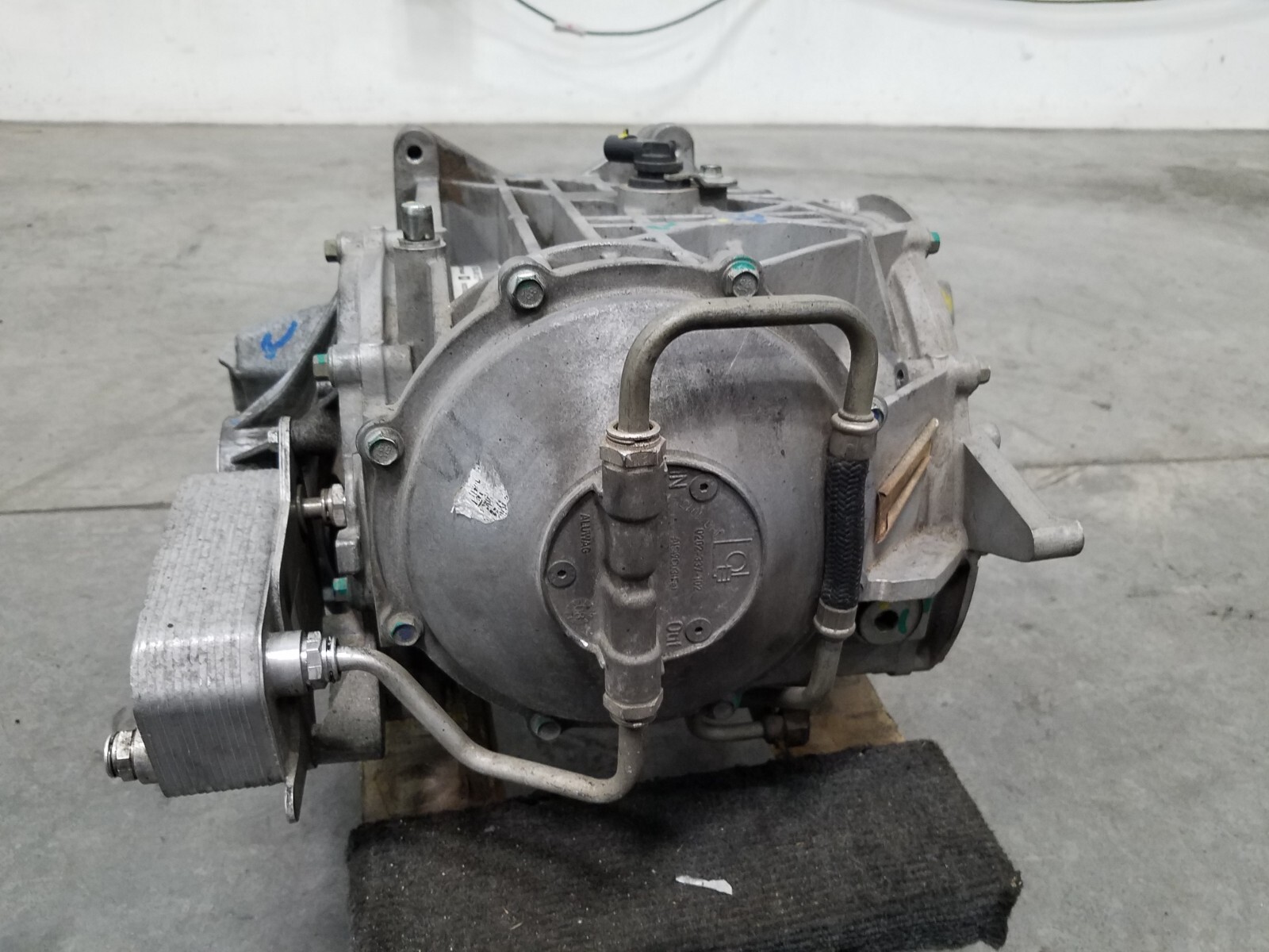

Hey Guys! Can I get a pic of what part or parts spin the diff cooler pump?

Pump is part of the rear cover plate.
Diff has lower power port for fluid out through the pump, and port back in on the high side for after the cooler.
https://i.ebayimg.com/images/g/ErQAA...f2/s-l1600.jpg
Pump rear plate cover runs around $1200, ports could be added to no pump diff, and would check with RPM if the pump drive parts could be made to be fit with non pump diff.
