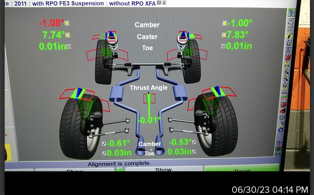

Sorry to beat a dead horse with another alignment thread but I'm curious what you all think about this alignment that I just received.
They are a shop that specializes in road racing and have great reviews, so I gave them PFADT specs and told them to do something between street and mild track specs. They talked me into the toe and I'm not sure how I feel about it. They said that amount will help it track straight without wearing the tires. I'm not an alignment expert nor did I want to debate a shop I'm trying to build rapport with.
For example, does ".03in" for the rear toe mean it's positive .03 inches, is it .03mm inward toe, or something else?
Car felt a lot more stable on the way home, I was experiencing issues with the front feeling washy before the alignment and new tie rod ends, but it had also just rained so I couldn't push it very far.
It means toe-in on that side. The sum of the rear toe measurements is the total rear toe. 0.03" + 0.03" = 0.06". Note that for toe, Pfadt uses the opposite sign convention than almost everyone else. Pfadt denotes toe-in with negative numbers, but the prevailing convention is to denote toe-in with positive numbers.

Looks good to me! You could try a little more toe in for the rear and or a little toe out for the front.

Looks OK to me too!
A little more toe in at the rear will help with stability, if you feel like it needs it.
From memory, spec on the F toe is somewhere around zero, so .01 is OK either in or out.
I usually use just a little more in...
That reading is probably in inches. Other readings in degrees are marked as such, and .01 mm is probably too small for the machine to measure.
Some people will recommend a small amount of toe out for track cars, to help with turn-in.
If it's a dual purpose car, I always recommend against that.
The minimal gain on the track with be paid for with a ridiculous amount of inner edge wear on the street.
If it is dual purpose, you can get away with a lot more negative camber. Tires are more forgiving of that than they are of toe.

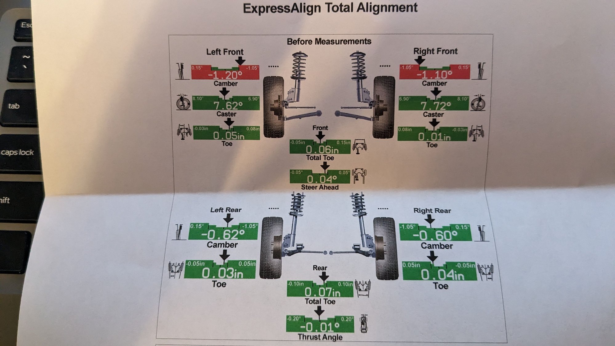

I am back with updates. I took it back to the shop and asked them to turn it two flats to see how the toe changed. In a nice way, they basically laughed at the term "flats" as a means of adjustment but humored me.
When they got it back on the rack, the alignment specs were slightly different than when it came off the rack for the first alignment, but told me it was within a normal tolerance.
When they adjusted one "flat", it changed the toe .06. So for example, the left rear was .03in and one turn of the flat moved it to .09in.
Also, according to the front desk guy, turning the right rear tie rod toward the front of the car adds toe in while turning the left rear tie rod toward the rear is what adds toe in.
Here is how the original alignment turned out:
How it measured when I pulled onto the rack today:
And how I left today:
With just that small amount of toe in added, it made all the difference. The rear end really wanted to walk out in tight turns but now it's much better. They said .10 total toe was the max within OEM spec and even then the .05 on the left rear was teetering on out of spec (as it is red). I wish the camber was a little more even but all in all I am happy. The main thing is that it feels planted again.
