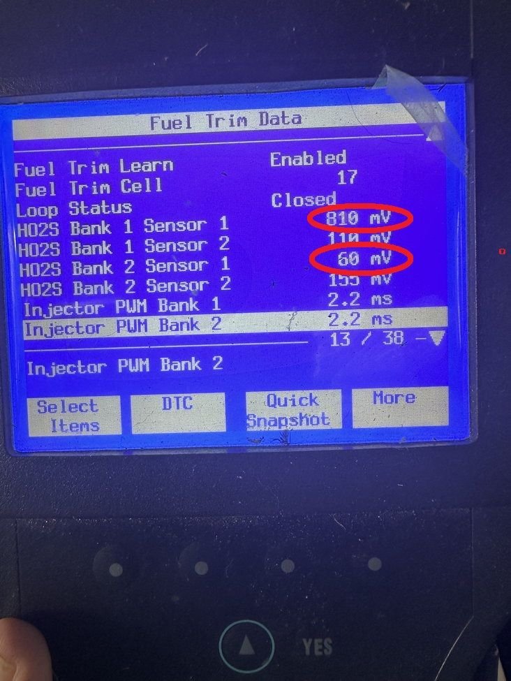

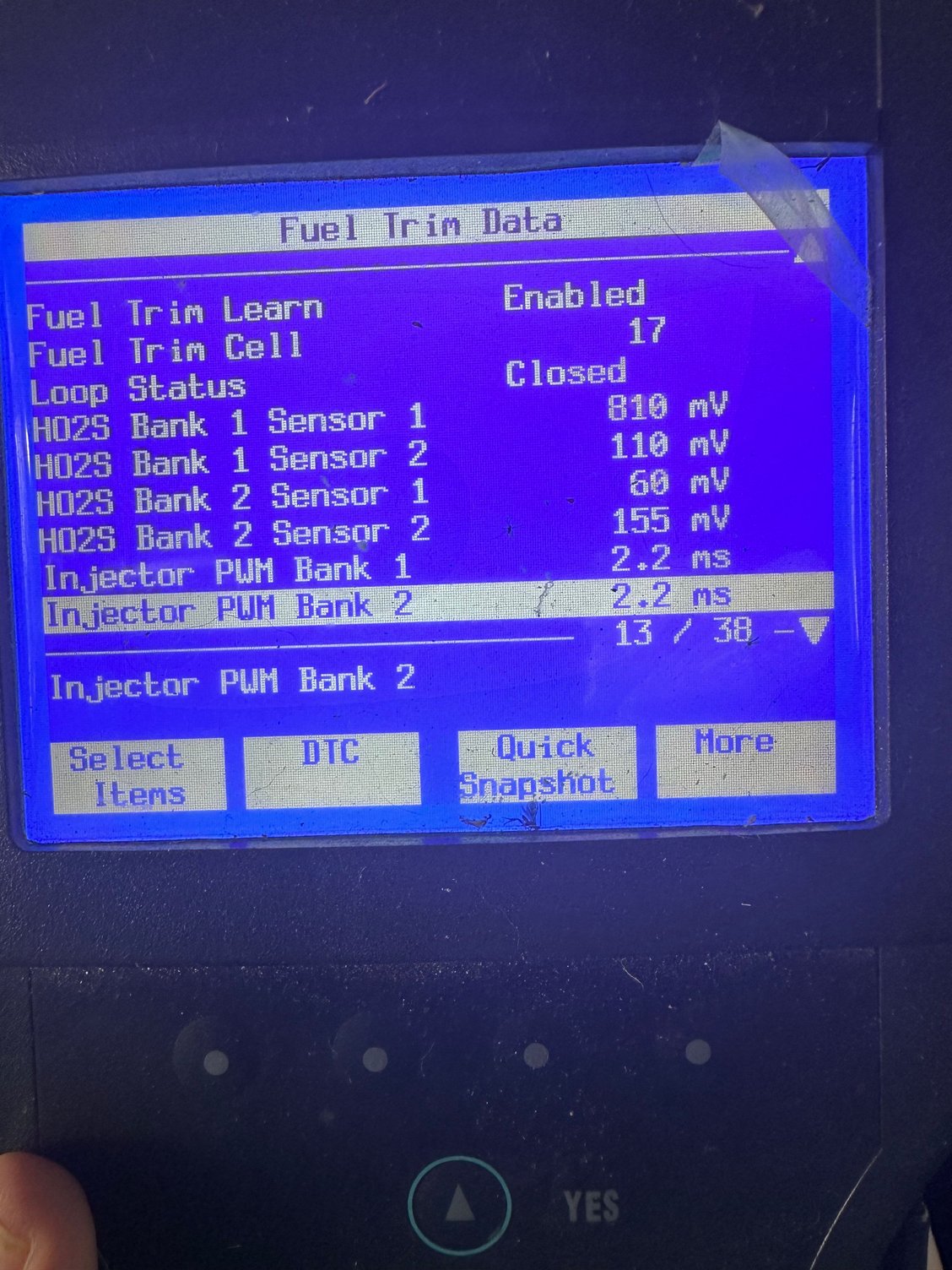

It sounds like the right side(passenger) of engine. It pre-detonates under load. I tried octane booster. Then 94 octane. The high octane stuff helps, but something is not right. Plus 94 at $7.50 is not what I need to use. Any ideas? What should I look for? I have a tech 2 (china) but am not really knowledgeable about its use. I did notice the bank 1 sensor 1 was all over the place.

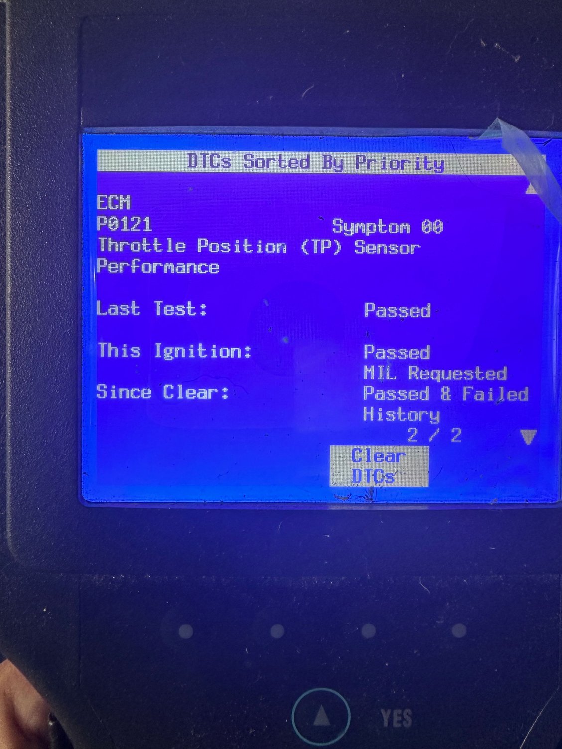

o2 sensor is probably fine since its suppose to operate within 1V, if it just died and stayed at zero it would be an issue. If the throttle position is the only code it has, I bet the throttle body is gummed up and dirty since these engine tend to get oil from the PCV system.
I would just clean the throttle body, clear the codes and see if this fixes it. If the throttle was very dirty, it may idle a little high and you will have to drive it for a bit so it can relearn it's idle values.

Originally Posted by wjnjr
It's just the voltage of each sensor when the picture was taken, they fluctuate and if they are going up and down it's how they are suppose to work:

Upstream O2 sensors should oscillate between 200-800mv’s and the downstreams remain fairly steady at 600-700mv’s…under WOT upstreams should go rich above 800mv’s…you can look at that…your MAF sensor at hot unloaded idle should read about 6.0 to 6.3 grams/second…also look at your MAP sensor ignition ON engine off…it should read about 29.9 inches of Mercury if you are at sea level…idle should read about 10 inches of Mercury…as I mentioned in another post you don’t have to remove the TB to clean it…just clean the area where the throttle blade contacts the TB when closed…if you don’t have TB cleaner Brake Kleen will do..a way to tell it may be dirty is look at your TPS %…should be less than 10%…mine after cleaning is around 5-7%.
