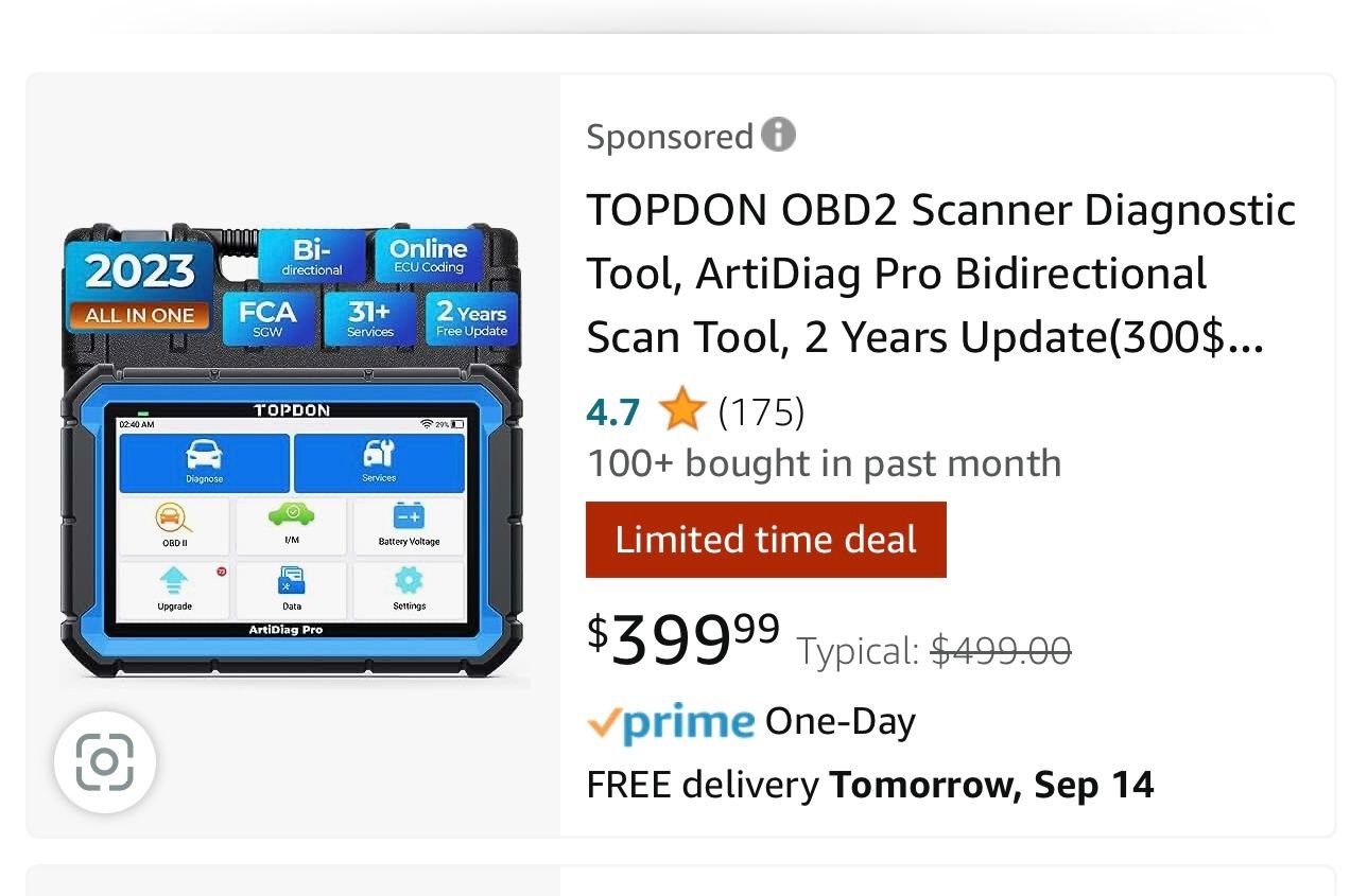

Yes…if not a vacuum leak and fuel trims increase under load can be fuel delivery or MAF issue…diagnostics 101…for a few hundred more you can get this bidirectional which is $100.00 off.

Sorry for the ignorance, but what can I do with the bidirectional tool? I get that it can send data to the car instead of just received it, but what exactly can it do to my Vette that makes it worth almost $300 more than the other one? Thanks for you help btw

With a bidirectional scan tool you can look at most inputs and outputs and turn on (an output) the cooling fan, fuel pump, HVAC blower motor etc...as far as inputs you can see if you push a button or turn on a switch (an input) that that particular computer module is seeing it being turned on...now if you just want to read codes and look at some "live data" your cheaper one will work...that's up to you !!...it will only read Engine, ABS, SRS (Airbag), Transmission trouble codes...the more expensive scan tool will read all modules....what I find funny is guys will spend $10,000 to "bling" up their engine compartment but have a $30.00 code reader and expect to diagnosis something a little more involved with their car...it ain't gonna happen !!!

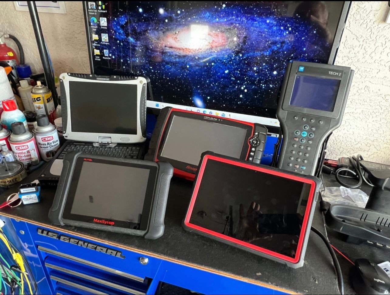

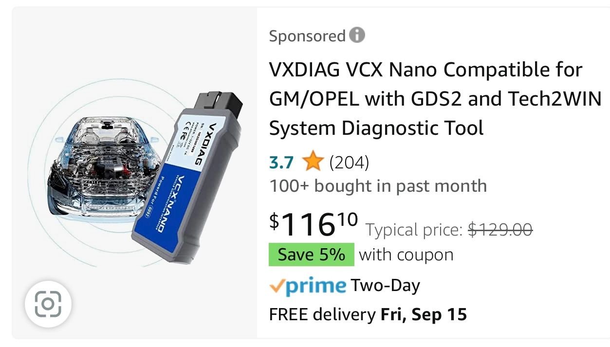

Never heard of a $60-70 dollar bidirectional scan tool…the VXDIAG is a little over $100.00 but the software is glitchy and it may contain malware…I’ll pass !!…I use 5 plus a strictly diagnostic scan tool…4 are bidirectional plus the Tech 2 which is not…these range from 1K to 5K.

Damn you are legit! Those are awesome! I bought one of those Snap-on at a pawn shop and turned around and almost tripled my money. It was basically a Windows tablet pc with a ton of features. Here's the one I was talking about. Let me know what you think, if it is worth the time try.

If anything stick with your first choice.
