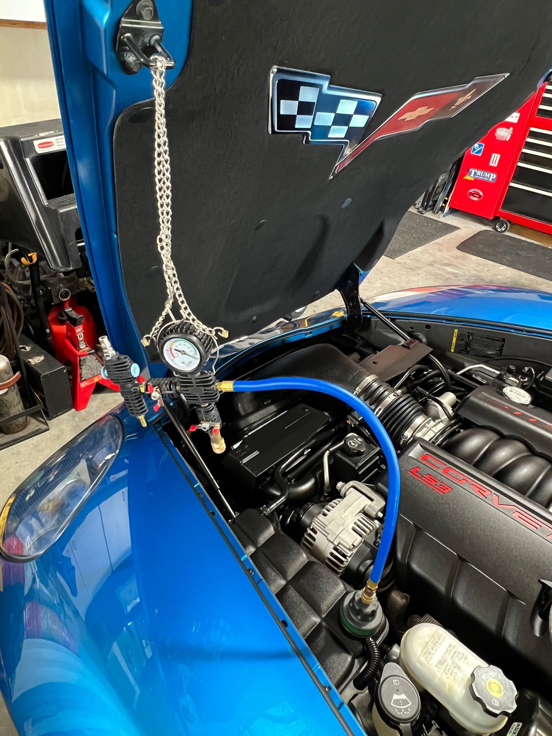

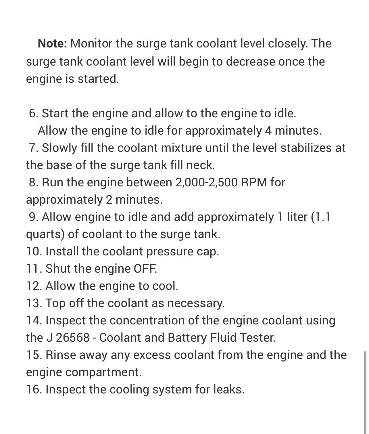

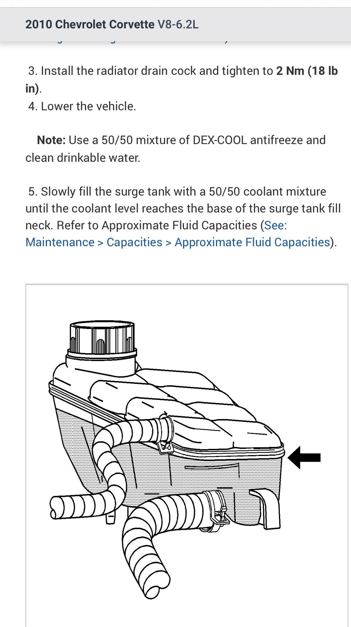

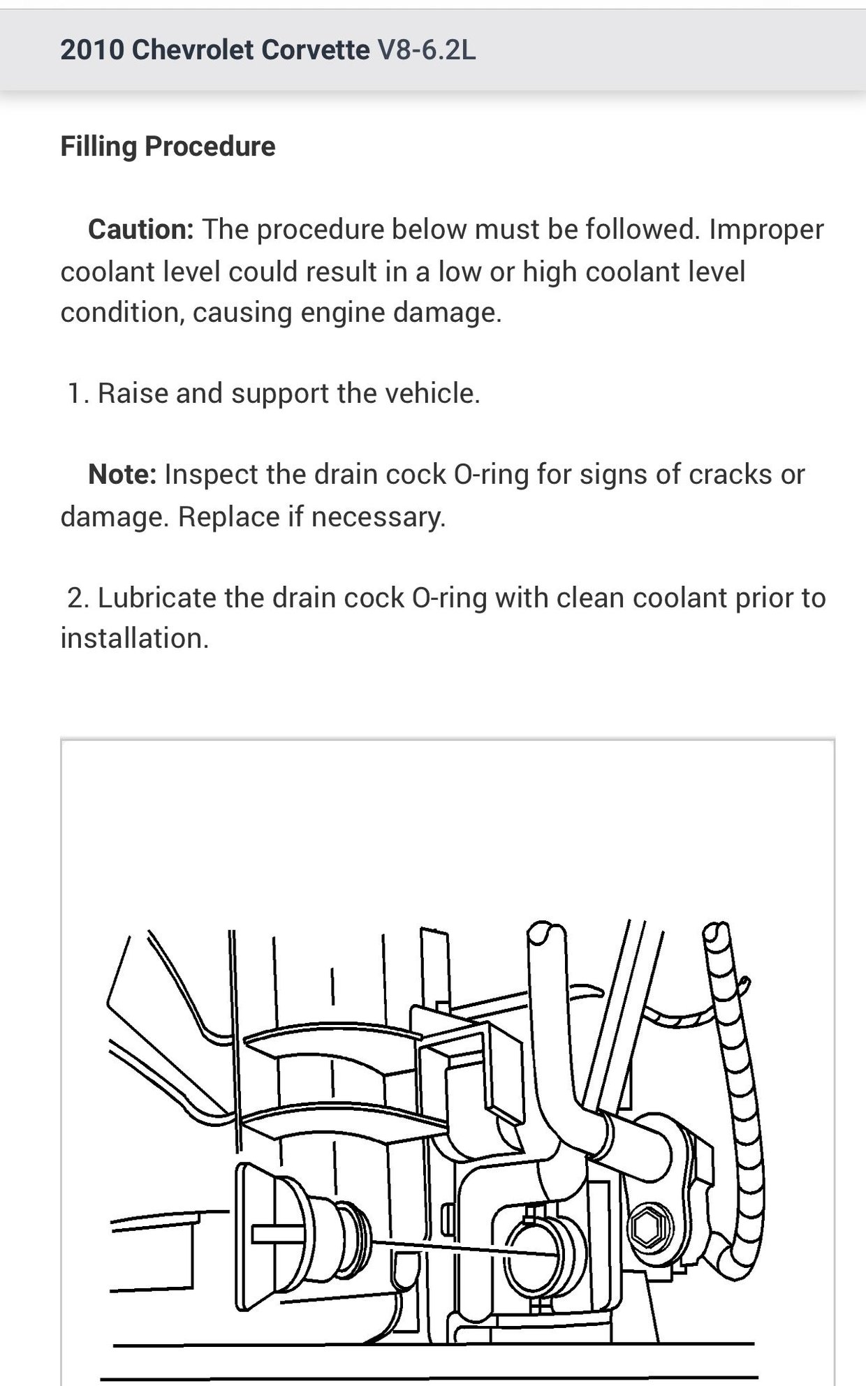

Vacuum fill is the way to go and these kits are CHEAP !!…if not this is the static fill procedure for a 2010.

I’ll try to get a vaccum tool because I feel like those procedures listed I basically performed. I didn’t rev the car 2,000-2,500 but I drove it to and from the shop and that didn’t work. Thank you.

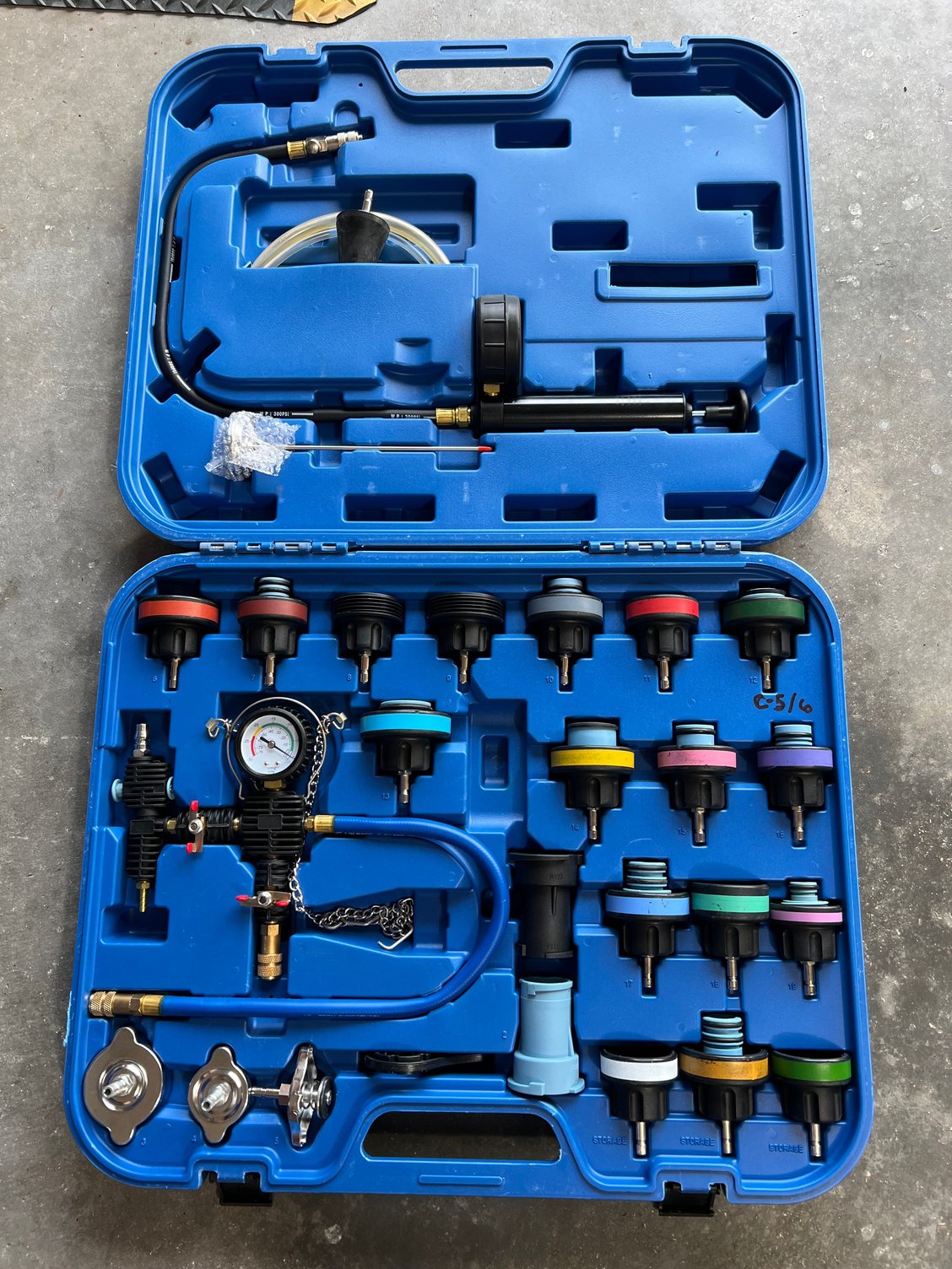

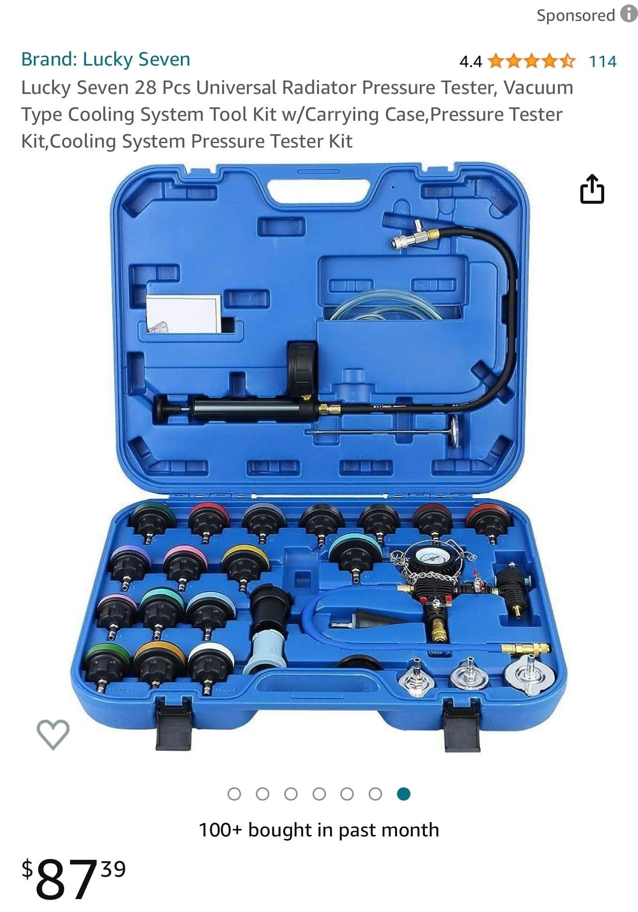

I have this model from Amazon…less than $100.00…attaches to the surge tank cap.

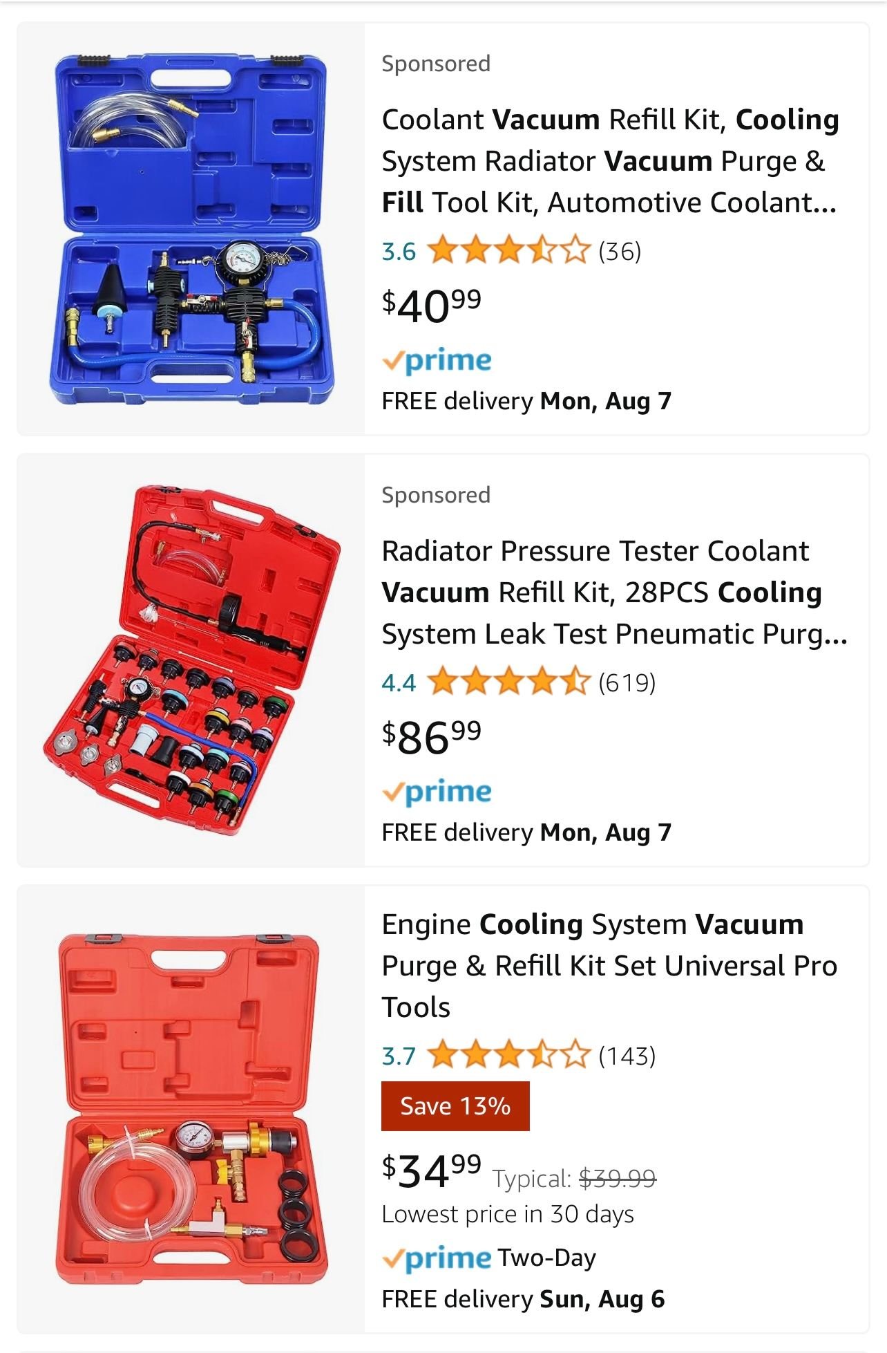

Posts: 193
Likes: 14
Thanks man. Just put an order in. I appreciate your insight. I filled it the static way before when I first built the car but I guess I got lucky. Lol not so lucky this time
