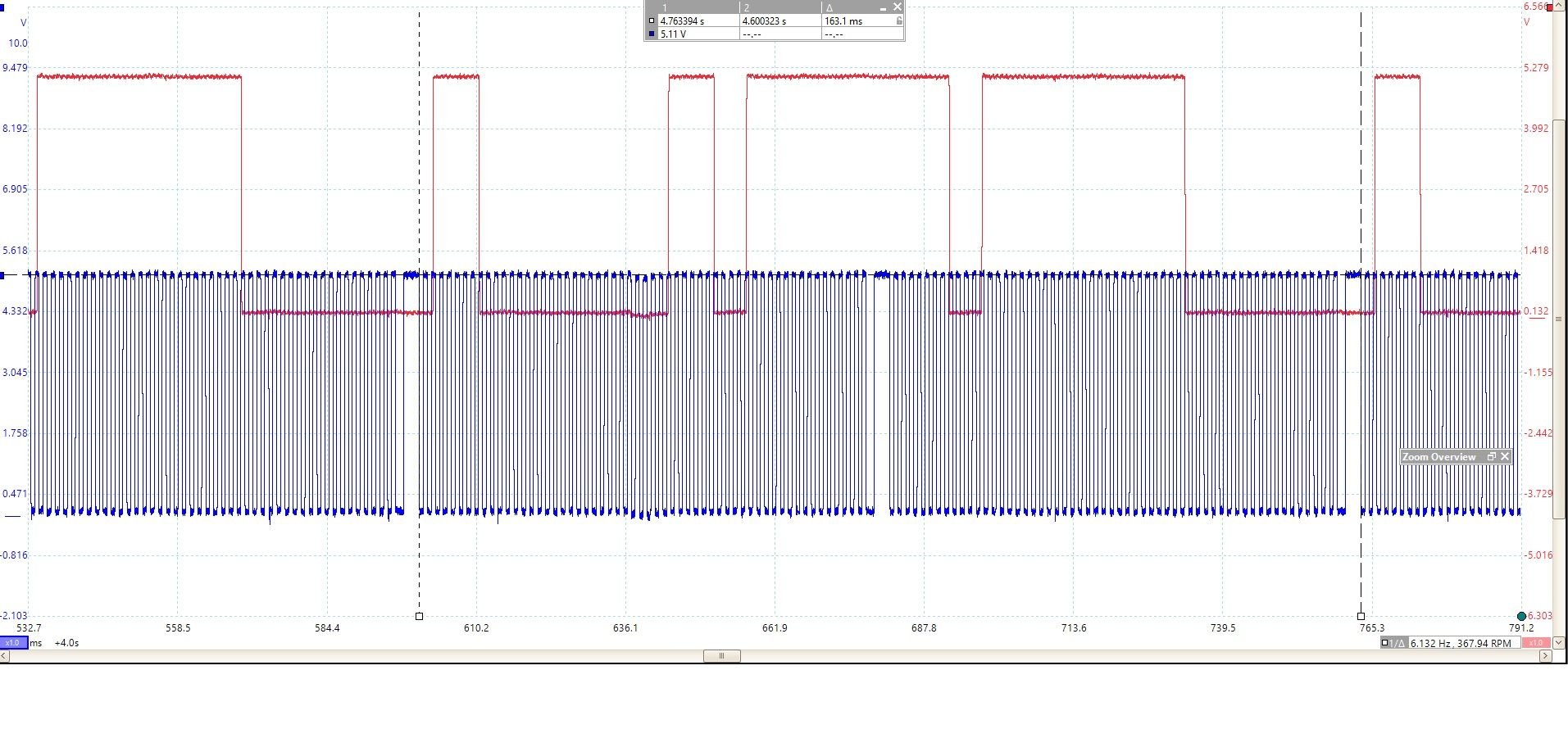

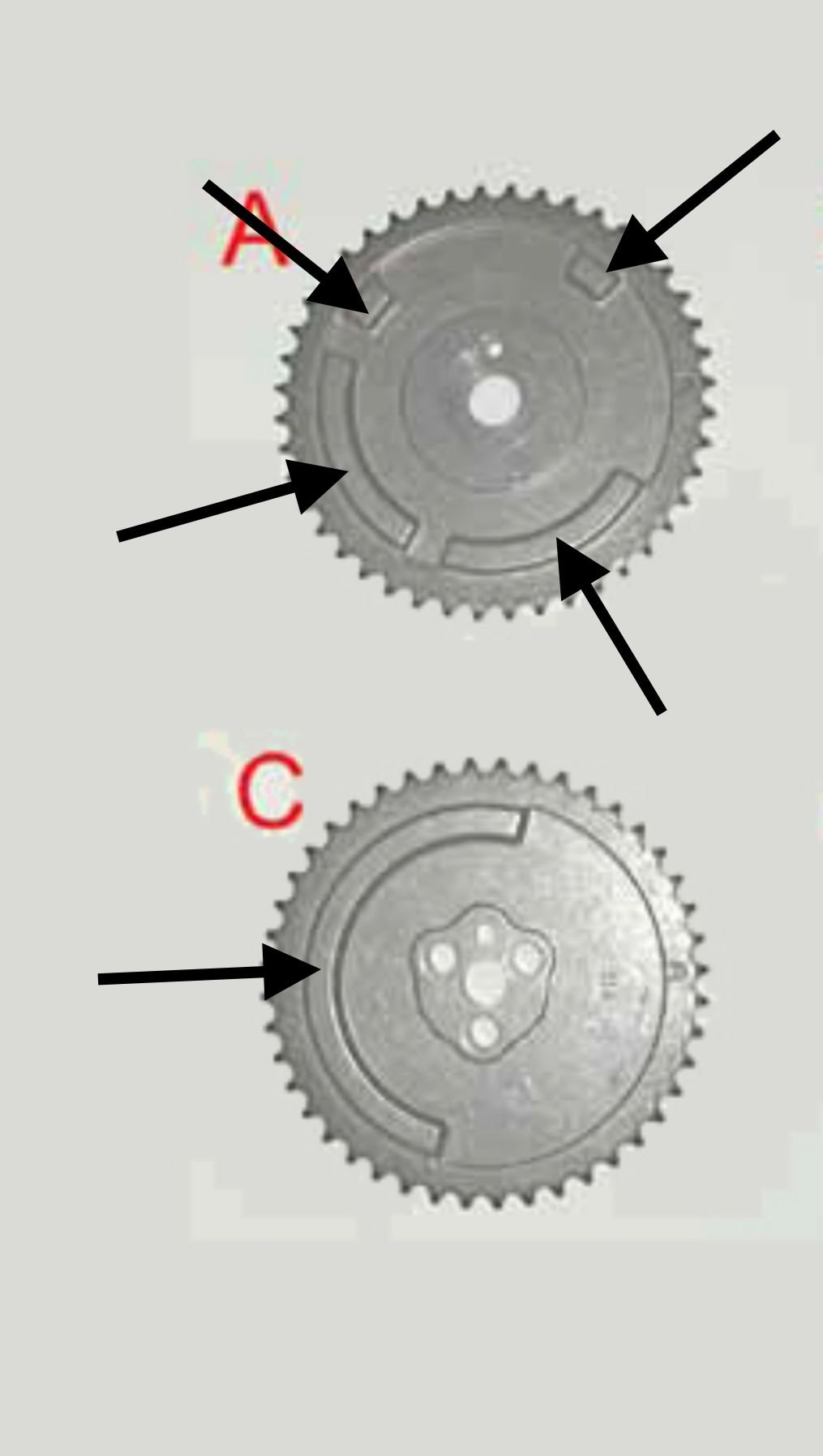

No other way out !!…top pic is a 4X and 1X is on the bottom…on my LS3 which has a 58X crank and a 4X cam the red trace is the cam sensor…2 wide and 2 narrow.
