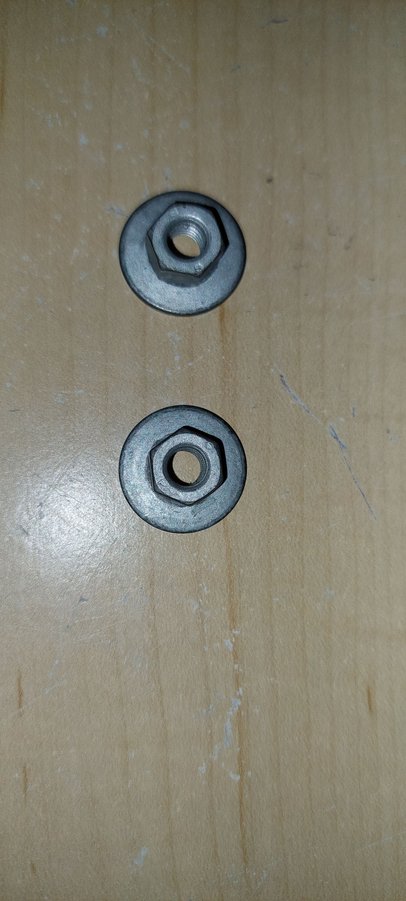

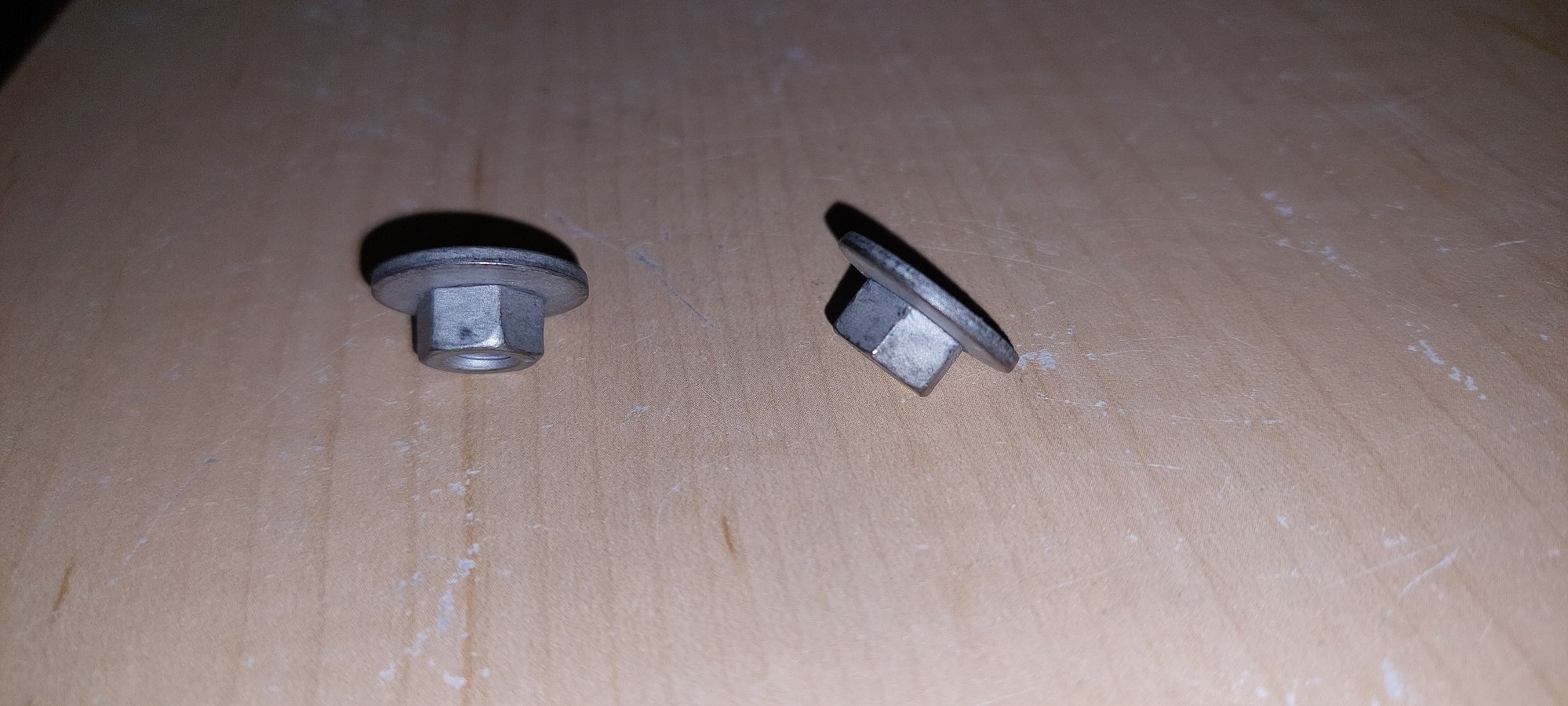

2009 manual corvette base. long story short, when I do work on anything I keep the nuts and bolts by the part or put them back in place till ready to bolt everything back up. I removed the torque tube and put these 2 bolts on top of the differential. when I put everything back together I could not figure out where these 2 nuts go. they're 10mm nuts with a captive washer. they are not for the exhaust hangers or the nuts that hold the trans to diff.

thank you, i did change the diff mount to poly, i definitely recommend it. those nuts are like 15mm, these 2 are 10mm.

Do you mean 10mm or 6mm? If they are M6 nuts (take a 10mm wrench), they are probably the nuts that secure the inner shift lever boot to the studs on the center tunnel.

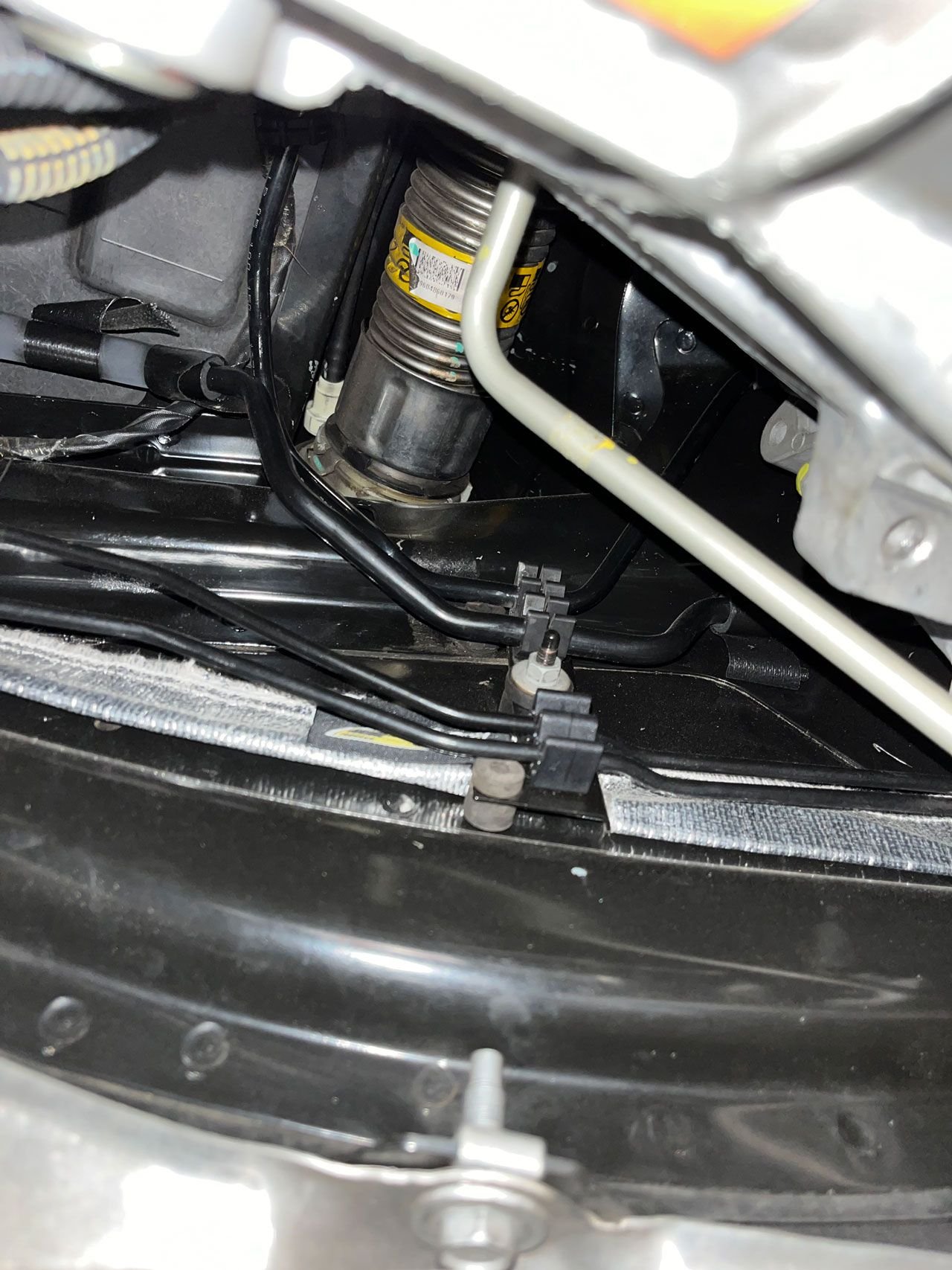

How about the nuts that secure the brake & fuel line clip mounting plates to the inside of the center tunnel.

Originally Posted by airblaine
another great thought, pretty sure those are bolts and are accounted for and installed as well. i am thinking these are from the differential area.
They are nuts with captive washers, like in your picture. They engage studs welded to the center tunnel.
if they dont bolt to the torque tube i am not sure why i would remove those. i will investigate that.
The nuts don't have to come out, but it can be helpful to remove them to more easily detach the rear brake lines for lowering the rear subframe.

From: Deltona Florida
i see what you mean. when lowering the rear subframe i suspended the driver side caliper off the cooling duct. then disconnected the barrel fitting to the passenger side caliper. i am familiar with the brake line attachment you are showing. and just used a screw driver to pop out the passenger brake line to make putting the barrel connections back together easier. pretty confident i did not remove that nut holding it to the frame. i do see your point though.

mid-rear exhaust hangers use nuts about that size

The OP mentioned "they are not for the exhaust hangers," which are M8s. The pictured nuts look like M6s (10mm across the flats). I assume that's what he meant by 10mm.
