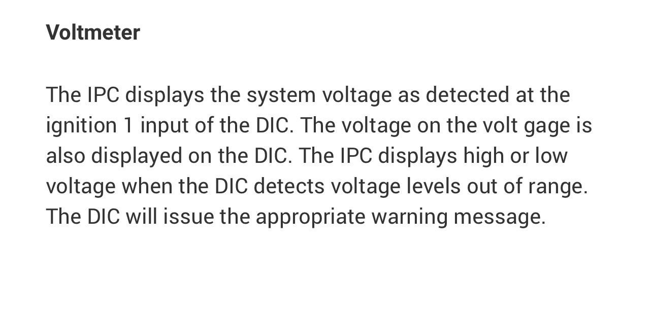

Voltmeter and DIC will always show lower voltage than battery…voltage comes from Ignition 1 circuit of IP so it will go through some circuits before getting there…on C5’s the same way…about .4 volts lower as you can see below…there will be some voltage drop along the way between the battery and IPC.
