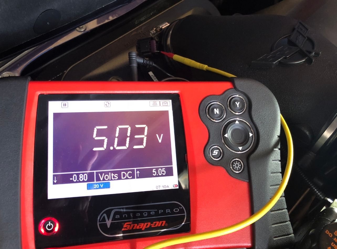

Ok, so the engine is a crank no start or a “no crank” ??..you said the motor cranks strong but then you said it “won’t turn over”…cranks strong means the engine is rotating…that what turning over means…the corrrect verbiage here is very important !!…if you only have a no comm with the ECM you ALWAYS check the ECM power and grounds…a fast check to see if the ECM is “alive” is to check for a 5 volt reference somewhere on the car…remove the MAF sensor connector and with ignition in RUN see if you see 5 volts on the YELLOW wire…the ECM has a 5 volt generator within it so if 5 volts is seen it’s likely powered up but I check ALL powers and grounds before condemning it…make sure ETC Fuse 9 and 11 is good…also make sure that Ignition Relay 1 is good…check the relay…the ECM has 1 BATTERY feed and 2 Ignition 1 power feeds…1 ground G106.

If you did NOT have the ECM no comms I’d say look at the Tach while cranking it over…if NO movement that leads me to a bad crank sensor but as I mentioned check for the 5 volt reference on the MAF sensor…if no 5 volts ECM may be dead but check the powers and grounds and the relay…if the relay is bad you won’t have fuel and ignition !!

Well I’d check for the MAF 5 volt reference and if you still have the ECM no comm before condemning the ECM…many shops just GUESS.
