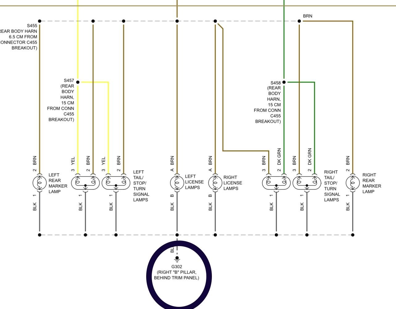

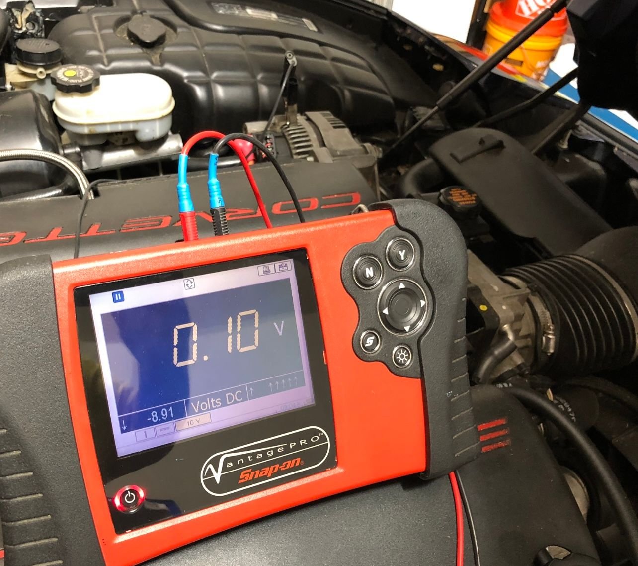

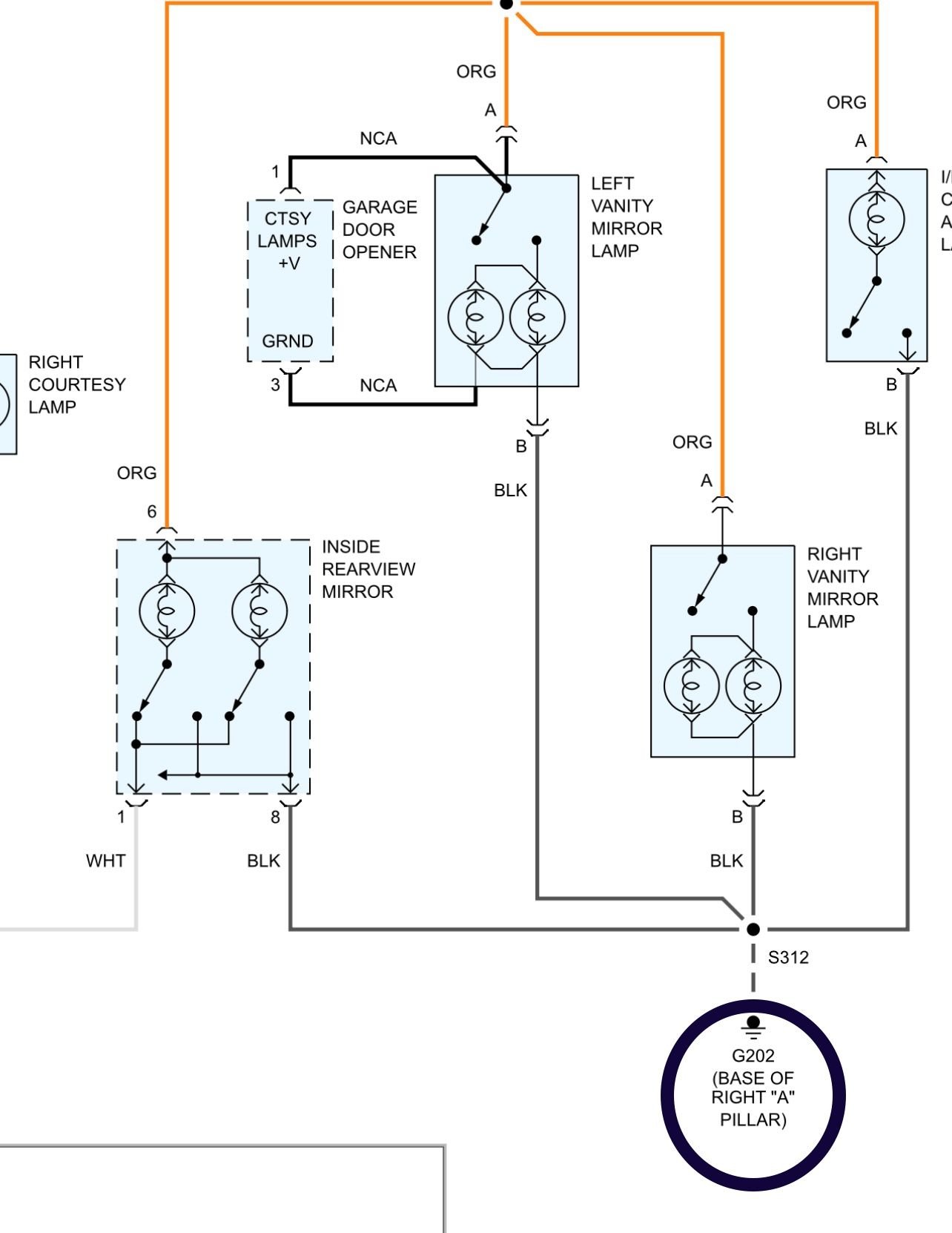

If you have a DVOM and have limited skills I would do a voltage drop on the positive and negative sides of the charging system…with the car running at 2500 RPM put some electrical loads on the car….blower, high beams, defroster and take one lead of your DVOM and place it on battery positive…other lead place on the alternator B+…voltage drop should not be more than 0.5 volts…to check negative side place one lead of DVOM on battery negative and the other lead on the alternator case…again should not be more than 0.5 volts….dim or flickering lights are normally a ground issue…below is the wiring for the tail lights and interior lights….can also be bad bulb connector…you can also check alternator output voltage between alternator B+ and the alternator case…when the car is running the lowest voltage potential is at the alternator case and not at the battery negative terminal…just because your new alternator is new doesn’t mean it’s good…voltage drop shown on my car…0.18 on positive side and 0.10 on negative side.
