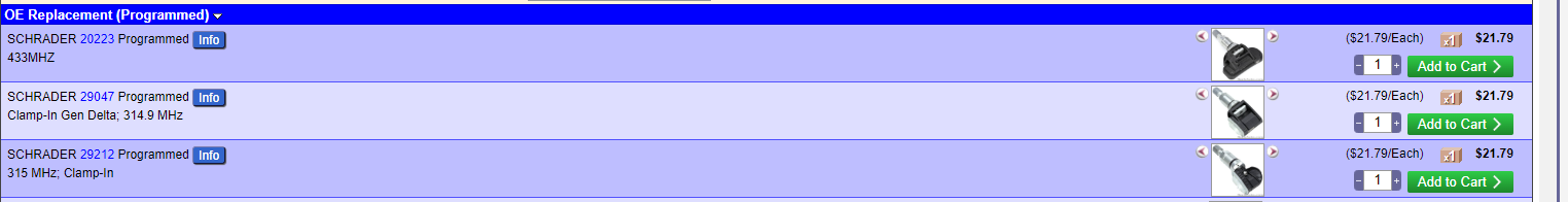

I just ordered tires for my 2013 427 Convertible, and I want to order new TPMS sensors as well. Could someone tell me which ones to order? There are three choices in the Schrader brand.

29212, and will come pre- programmed, so just need to install them in the tires, put the car into TPMS mode via the fob, then trigger them in the correct order to lean them to the car.
https://catalogue.schradertpms.com/e...VehicleType=AU
If you need a tpms trigger tool so you can do relean's later yourself,
Amazon Amazon
If the shop or you have a cloning tool ,can use the 33700's instead (great for when you have an extra set of tires on rims, and can clone the TPMS in these tires, to the TPMS in the other rims, so you don't have to do relearns when you swap the rims/tire sets on the car.
Also, when ordering them, make sure they come with the 20004 parts, and if not, then order 4 of them.
The photo shows the sensor has the parts, but double check since you don't don't want to reuse the seal from the old sensors.
Simply, 416MHz will be for an export cars, while the USA model car use the 315MHz tpms. The cut off date for different year senors is 05 to 09 for early cars, then 2010 to 2013 that you have.
Hence there are 4 pre programmed difffent sensor modules, one for 416, one for 315, for both the 05 to 09 cars, and then for the 2010 to 2013 cars.
