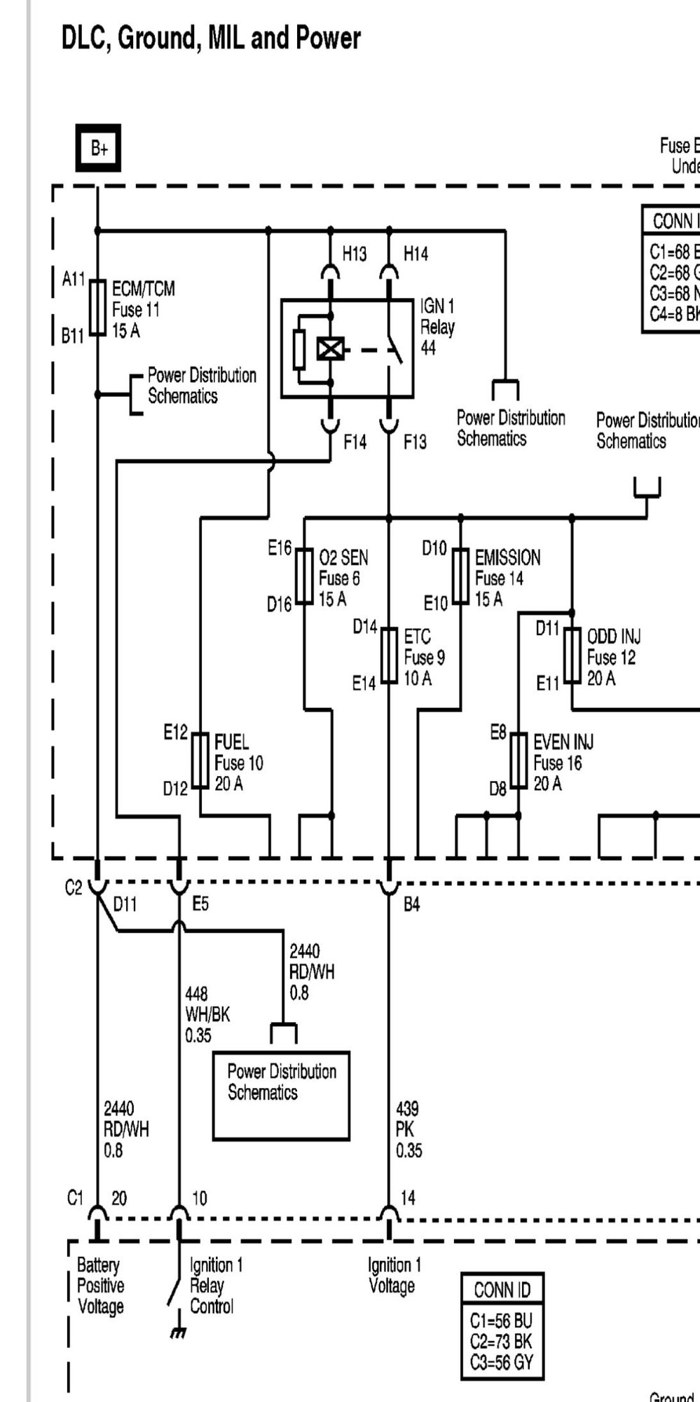

You will most likely not have any codes concerning your shut down issue…testing will revolve around your testing of Powertrain Ignition1 Relay #44…if you remove that relay if still having shut down issues the car should shut down and not continue to run…try swapping that relay with the Rear Defogger Relay #40 and see if resolves your shutdown issue…you may have a short to ground on the wire that provides a ground for the coil side of the relay keeping the relay constantly energized or a bad ECM being a bad driver in that ground circuit…wouldn’t worry about your TC issue right now…don’t know if that Blue Driver will show any codes from the EBCM.
2008 z51 engine & computer electrical diagrams - CorvetteForum - Chevrolet Corvette Forum Discussion

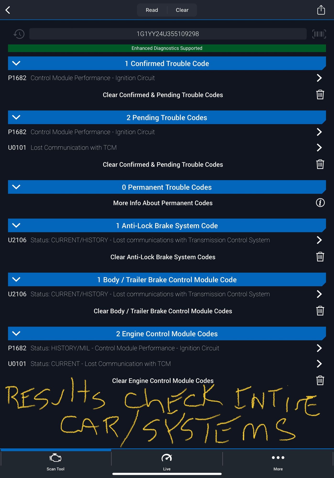

Switch #40 and #44 with no change - still continues to run for about 20 secs. I ran the Blue Driver, here is the results.

First thing what year car is this ??…A/T or M/T ??…remove Powertrain Relay #44 and probe terminal 86 which is closest to the fender and the windshield with test light connected to battery POSITIVE…light should NOT illuminate…if light illuminates either short to ground on the ground wire which is controlled by the engine computer or failed computer driver…I’ll have to research what else may be telling the ECM to ground terminal 86….with test light connected to ground see if the test light illuminates when probing fuses 6, 9, 12, 14 or 16…those fused should NOT be hot with car off…pulling Powertrain Relay should cause the car to shut down and not run for 15 seconds…our member with this same issue also had a P1682.

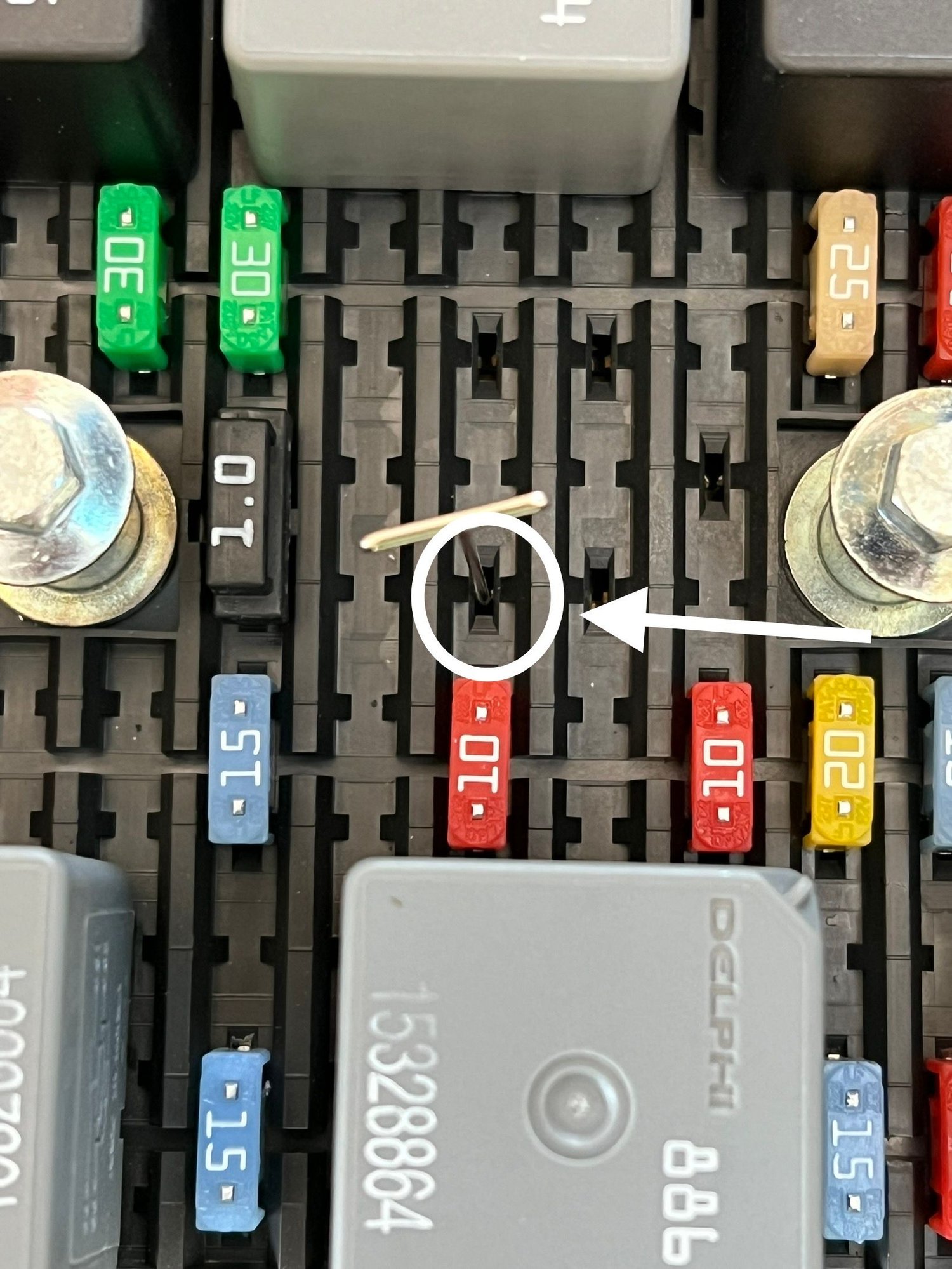

Since my tester was too big to make contact, I used a 2” long Tee pin to access the contacts. With the clip of the tester on the positive, I touched the pin with the tester. My question is, was the car suppose to energized? I did the test with the car shutdown (not in the accessory or ready to start mode). I didn’t really feel a click when I inserted the relays, more of a gentle building of resistance as the relay slid into the contacts.

With the test light connected to battery POSITIVE if you touch the tip to pin 86 which is closest to the windshield and fender the test light should NOT light...you do the test test with the car shutdown…are you familiar with how relays operate ??…what you are checking is F14 in the diagram…if the Ignition 1 Relay Control at the ECM were to “stick closed”
that test light would illuminate or if it were shorted to ground somewhere between the ECM and the relay also…if the relay were energized closed with the car shutdown all those fuses below the relay would be “hot” with the car off…they should NOT be…you can test those with the test light connected to ground
