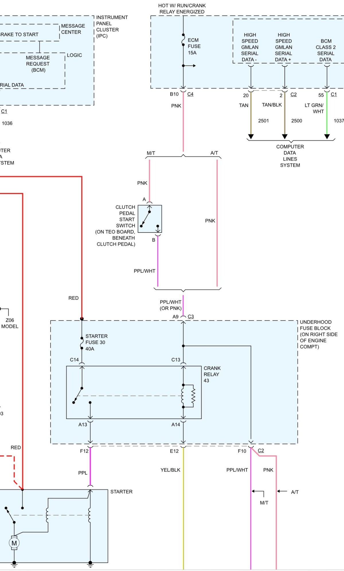

The fastest way to check your clutch switch is remove crank relay #43....with a 12 volt test light connected to a good ground probe terminal 86 (86 is closet to you and to the windshield) which is coil side feed...when starting if run crank relay is being energized the light will illuminate if the clutch switch is good...don't shove the test light inside the fuse box...use a safety pin or something like that...you DON'T want to spread the terminal apart or you will have issues down the road…wiring for your 06 below.
