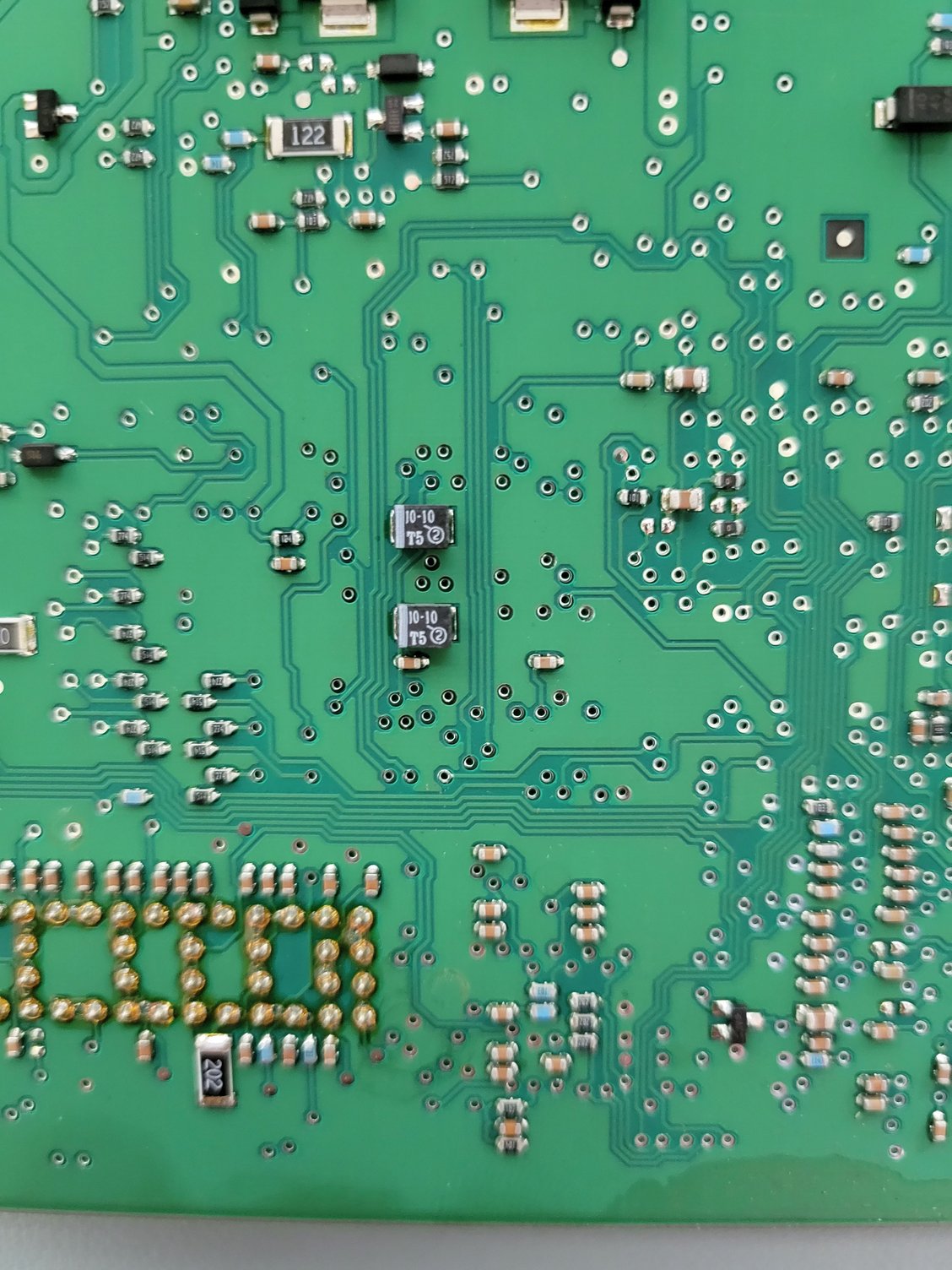

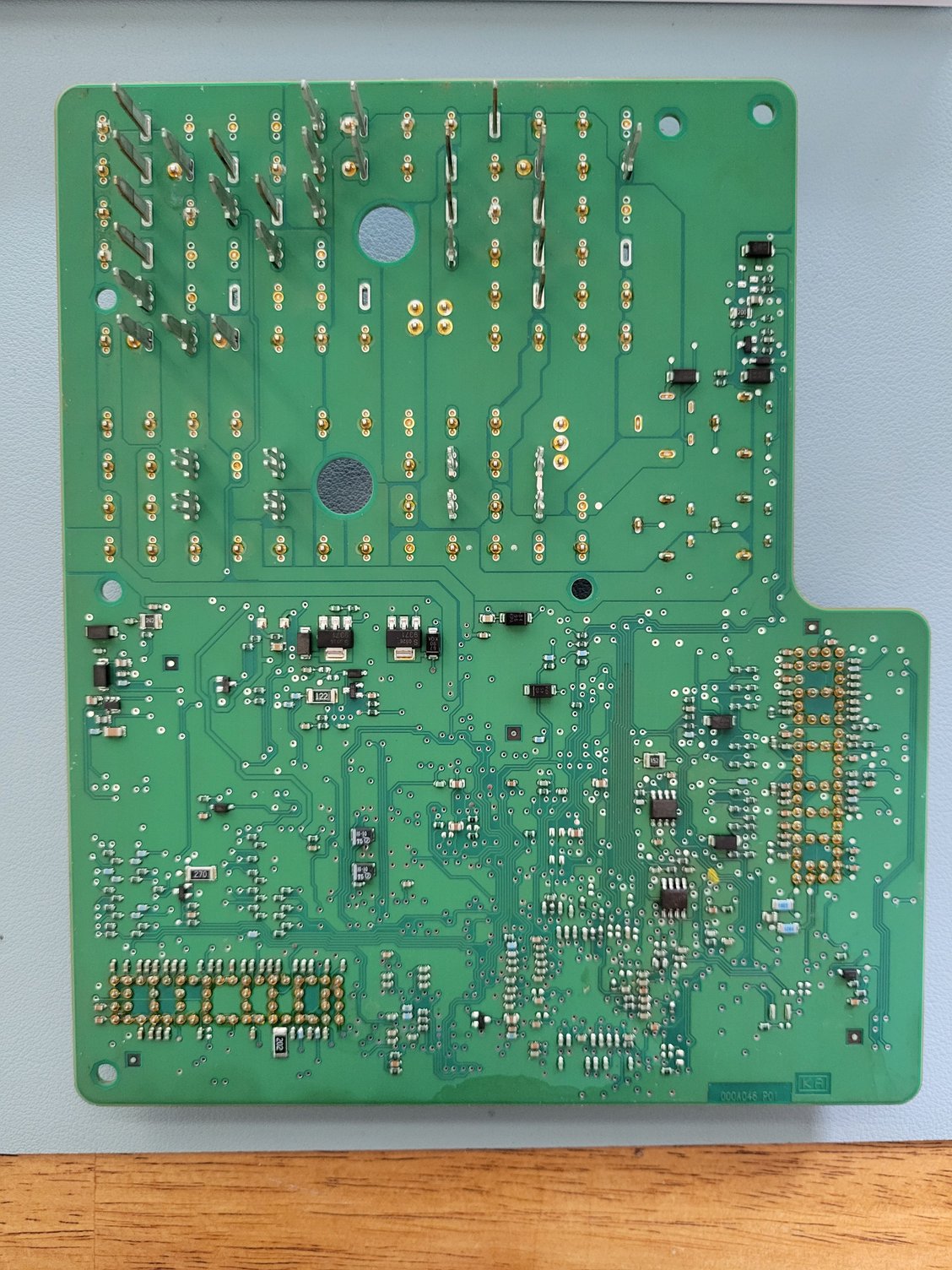

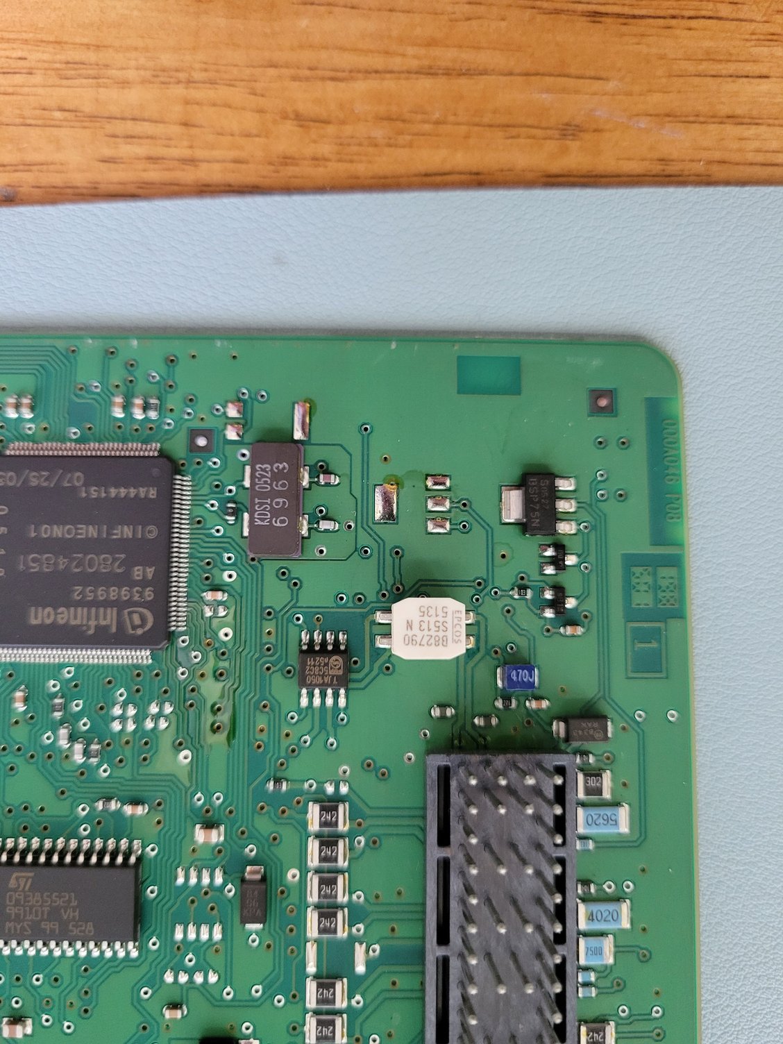

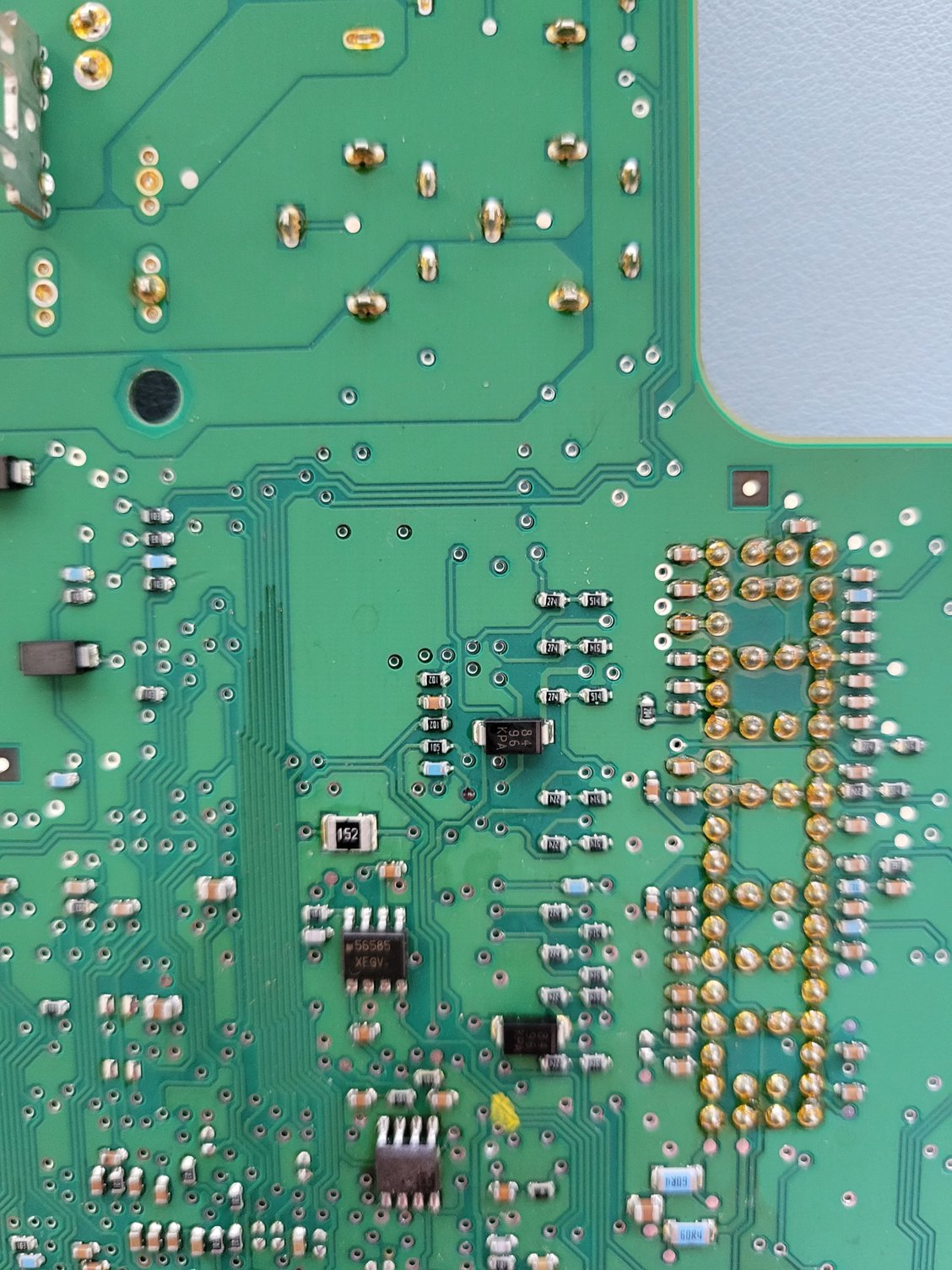

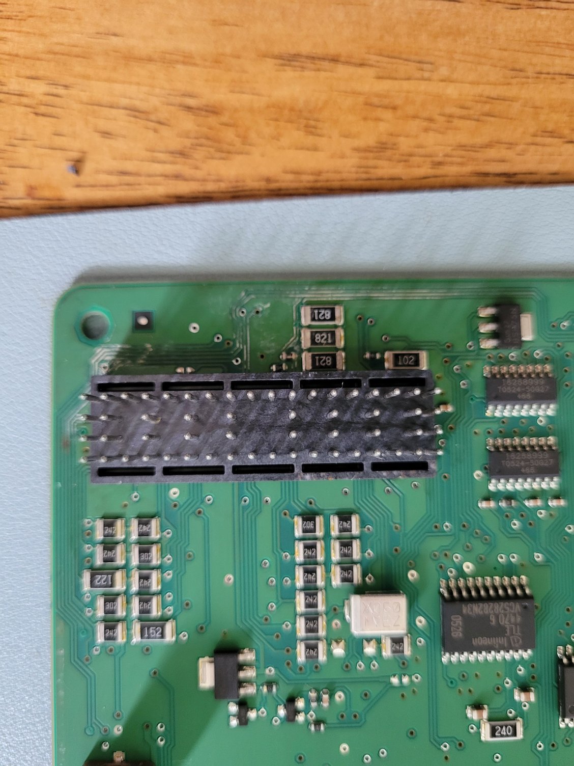

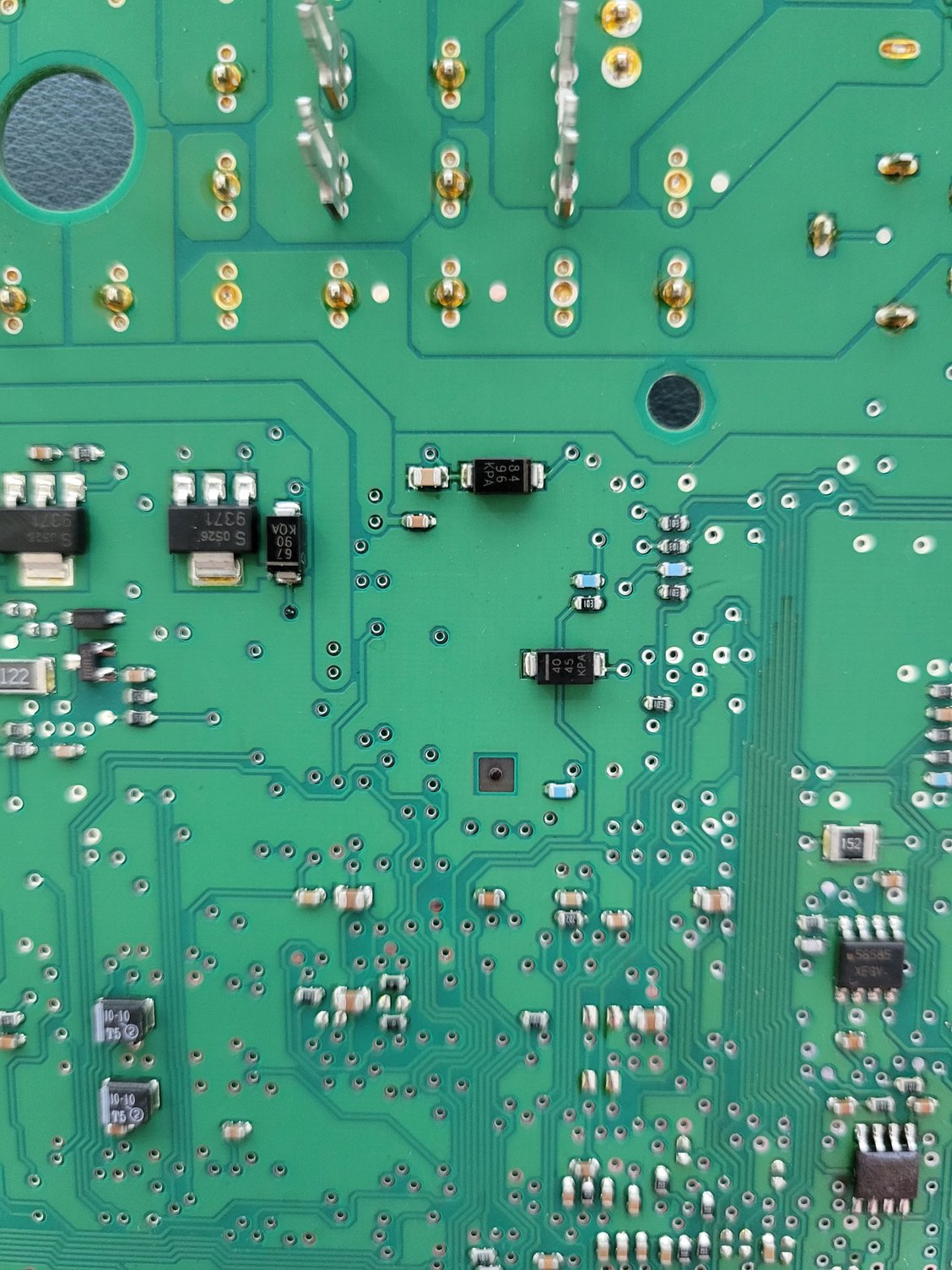

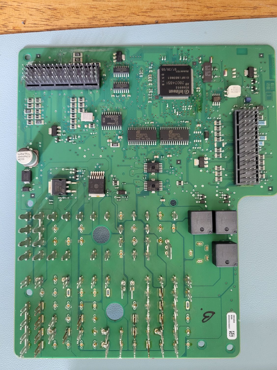

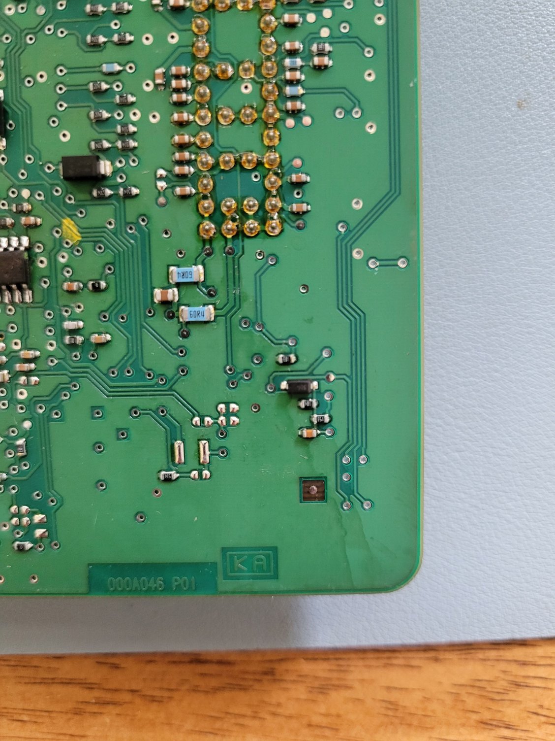

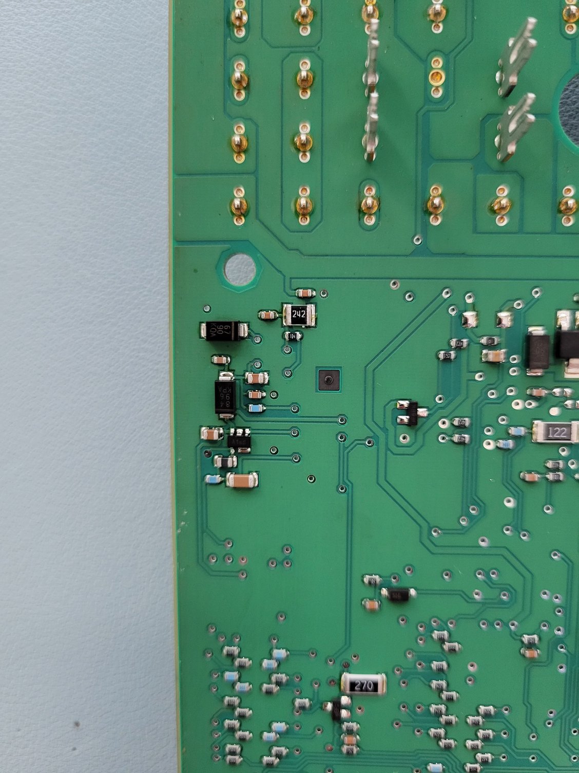

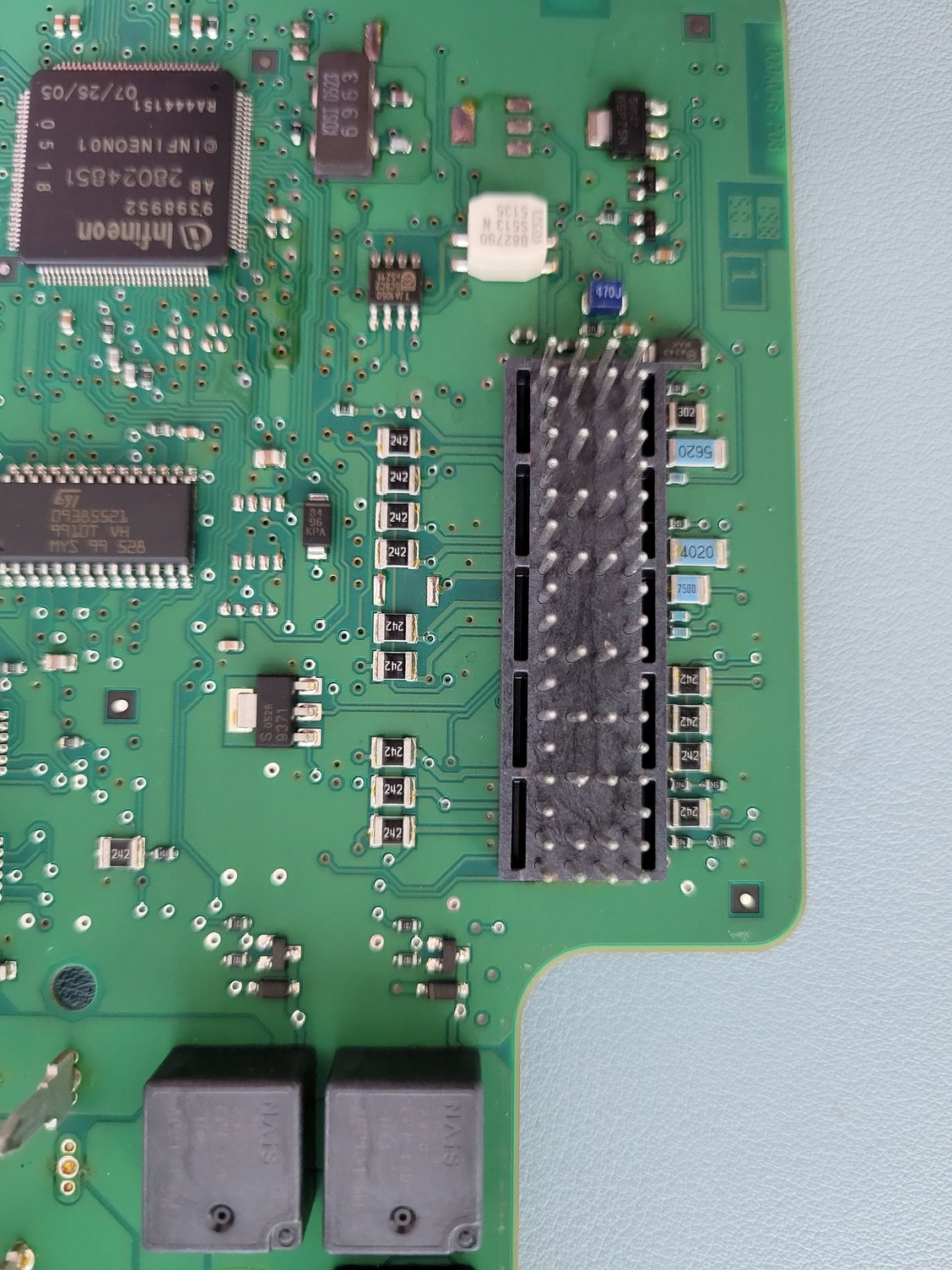

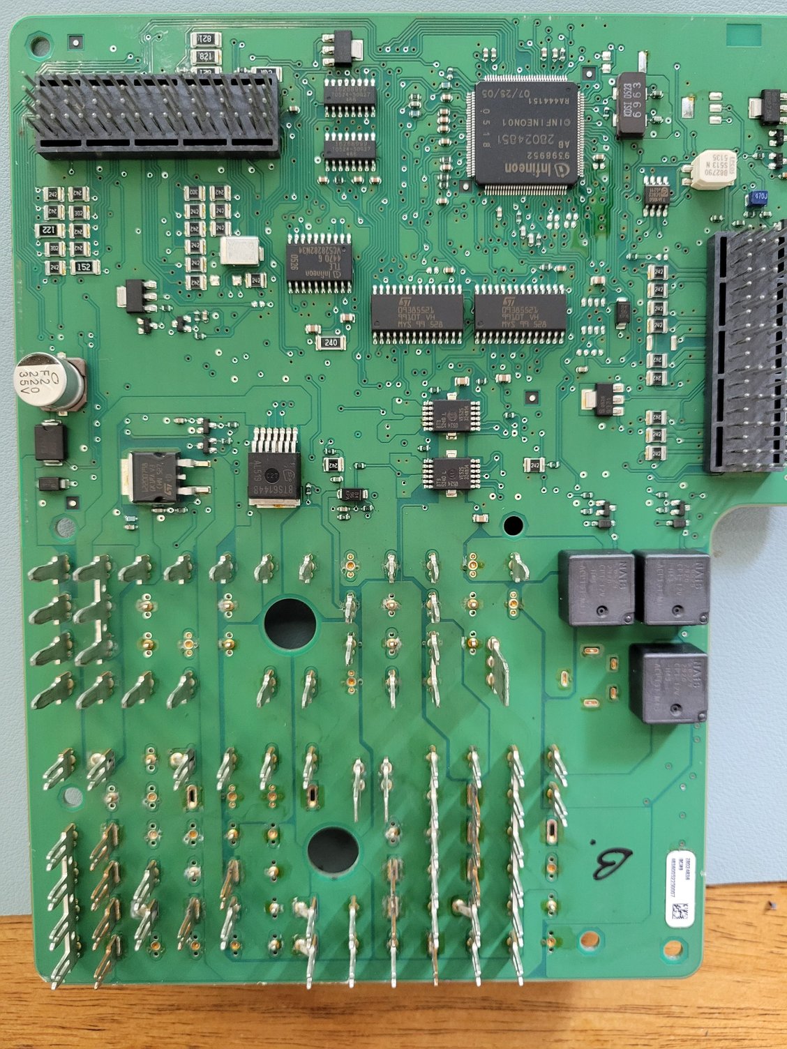

Here's a bunch of close up photos
Originally Posted by Dads2kconvertible
What is the power source for retaining the information? Capacitor in the circuit? Battery back-up? NVRAM chip?
PCBs of that era in other devices use back-up batteries that have to be changed every few years. That seems unlikely for an automotive application but 2005 seems early for NVRAM.
If the chip that stores the data requires power to retain that data and the power isn't there the data is lost.
I don't suppose anyone has looked up all the chips on the boards and tracked down the data sheets?

Missing resistors. Look at the edge shape of he solder on the pads and can see where the resistor popped off from where they were soldered in place. As for header solder joints, would clean them up some more to see if some of them need to be re-flowed,

Missing a resistors. Look at the edge shape of he solder on the pads and can see where the resistor popped off from where they were soldered in place.
How can you tell if it's a resistor that's missing?

Sure looks like something missing there... The car I'm looking at will be back in in a week or so for me to spend some serious time on. Guy reported that the brake lights and things are actually intermittent. Work sometimes, other times not... So could be a bad solder on board or something in the harness. I will certainly pull the board & compare to these pics & provide some feedback on the possible missing part....

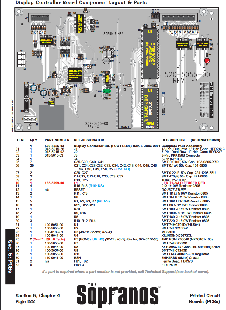

It sure would be helpful to see a schematic and layout.
Here is one from a pinball machine released in 2005. With this documentation it's relatively easy to source parts needed for repair.
2005 pcb from a pinball machine.
