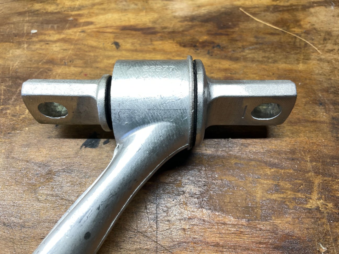

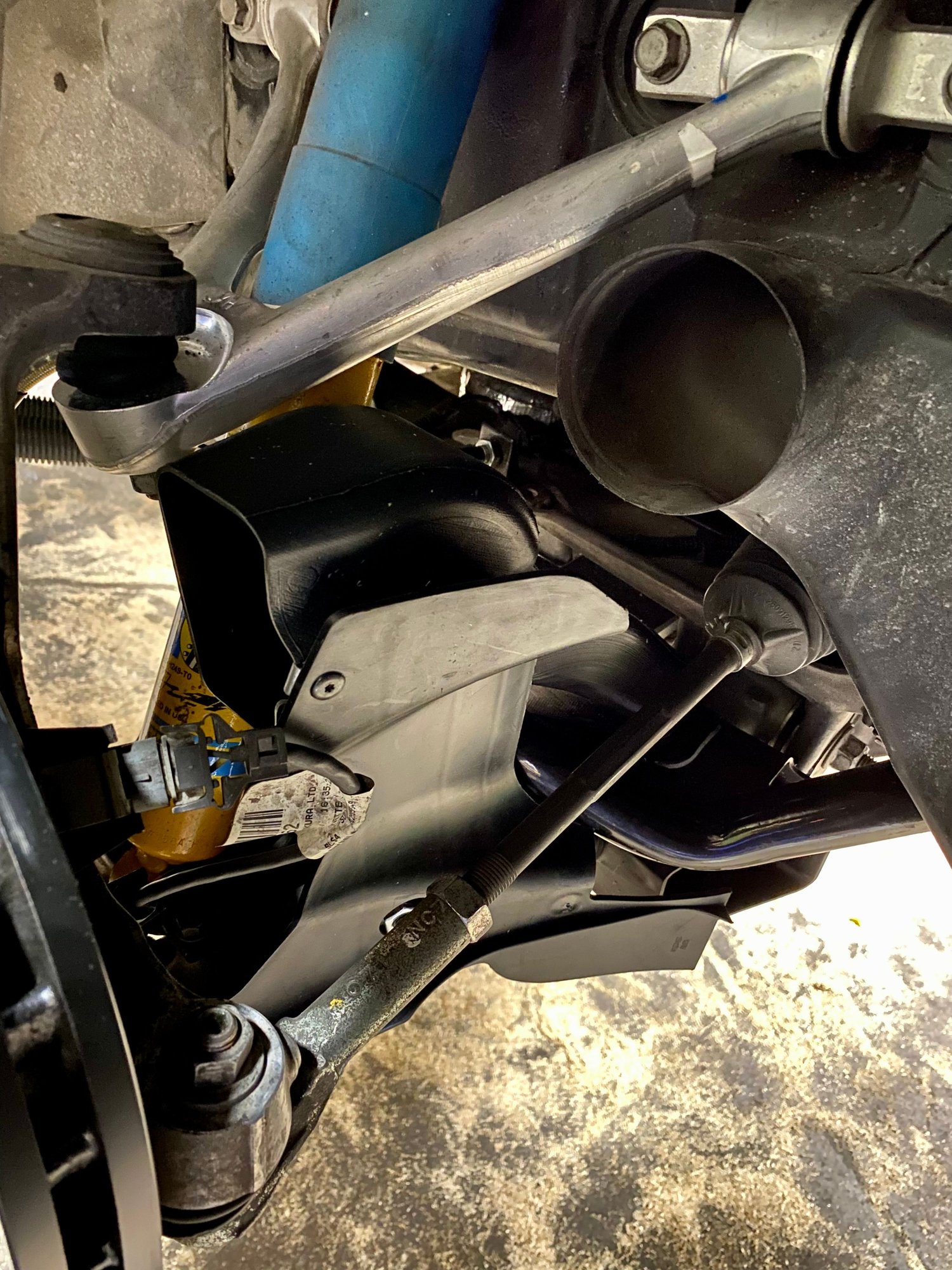

Just thought I'd mention that 'better' C7 control arms fit. All but lower rears.
https://www.corvetteforum.com/forums...s-on-a-c6.html
The bushing design and capture is improved, I have no idea of the durometer of course.
Here, we see my stock upper front bushings slowly walking out (from braking)...and this after very few track events (no auto-X), low mileage car...on 'not so sticky' R888R tires.
And these are better design C7 control arms
Caveats;
a) I haven't yet actually installed/tried mine because I'm still waiting for the lower fronts. Those are on perpetual backorder (6 months paid now!) and I don't want to go for alignments more than once. So, no personal experience here yet...
b) the lower rears, which are showcased in that video above as having so much movement, are different on C7...so that won't be remedied.
Bur, the C7 lower front control arms accept the C7 Z06 brake duct deflector kit! They are a big improvement over the hokey C6 ZR1/Z07 deflectors, and also have a great scoop type duct attachment which loops around the control arm. Although, with my particular setup, they may interfere with my 4" grill mounted ducting, but that's TBD...
While OEM GM are currently B/O on the lower front arms, they are, however available in stock from the aftermarket...Nonetheless, at this point I prefer to wait for the OE pieces. Season is basically over and I'm not sure about bushing durometer on the aftermarket parts anyway (could, of course, even be higher...but who knows?)
For someone who also street drives their car, and tracks it on 100/200tw track tires (not slicks or Hoosiers), no aero, with stock susp, I want to try this as a milder option to delrin or poly. Our roads here in Montreal have now twice won the 'Worst roads in North America award by Nokian Tires'.(and they ain't getting better!)
I don't hear C7 guys complaining, and the one time I drove a C7 Z06 on track, it don't recall it feeling vague or imprecise (yes, yes...I realize it's lower rear control arms are still different/better).
Anyway, its always possible to do lower rear only with Delrin if this is still deemed an issue

As Tommy said above, the c7 upper arms offer a really nice alternative to bearings if you prefer OEM parts.

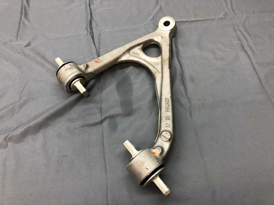

So what is the actual difference between the C6 & C7 control arms?? Are they beefier or what? I tried checking the differences out a few years back and couldn't see a difference online, but then wasn't 100% certain I was viewing actual C7 control arms.
Stop plates on the right and left hand sides of the center rods, so the arm can not just walk off the bushings under heavy braking like on the C6.
https://i.ebayimg.com/images/g/ks0AA...x6K/s-l960.jpg
If you look at some of the poly kits, they will come with the upgrade rods to achieve the same as well.

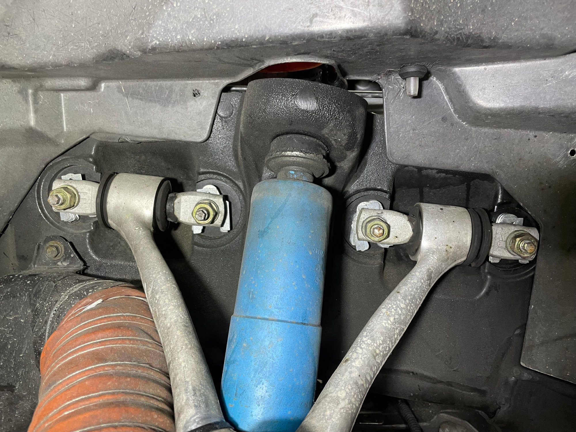

Here’s another angle on the upper bushings, there’s also a sleeve and while as I posted above, I have no idea of the actual durometer of the rubber used, it appears that the bushing will permit less lateral deflection. While still allowing rotation.
I still don’t have the C7 lowers so can’t comment on any differences regarding bushings, only that they allow use of the better C7 Z brake cooling deflectors (my post #5 above).
Again, this obviously can’t come close to the positive location and rotation offered by spherical, but is just a decent solution for a street car, which doesn’t affect NVH.
And again, I haven’t yet tried/installed mine so can’t give any first hand feedback at this time

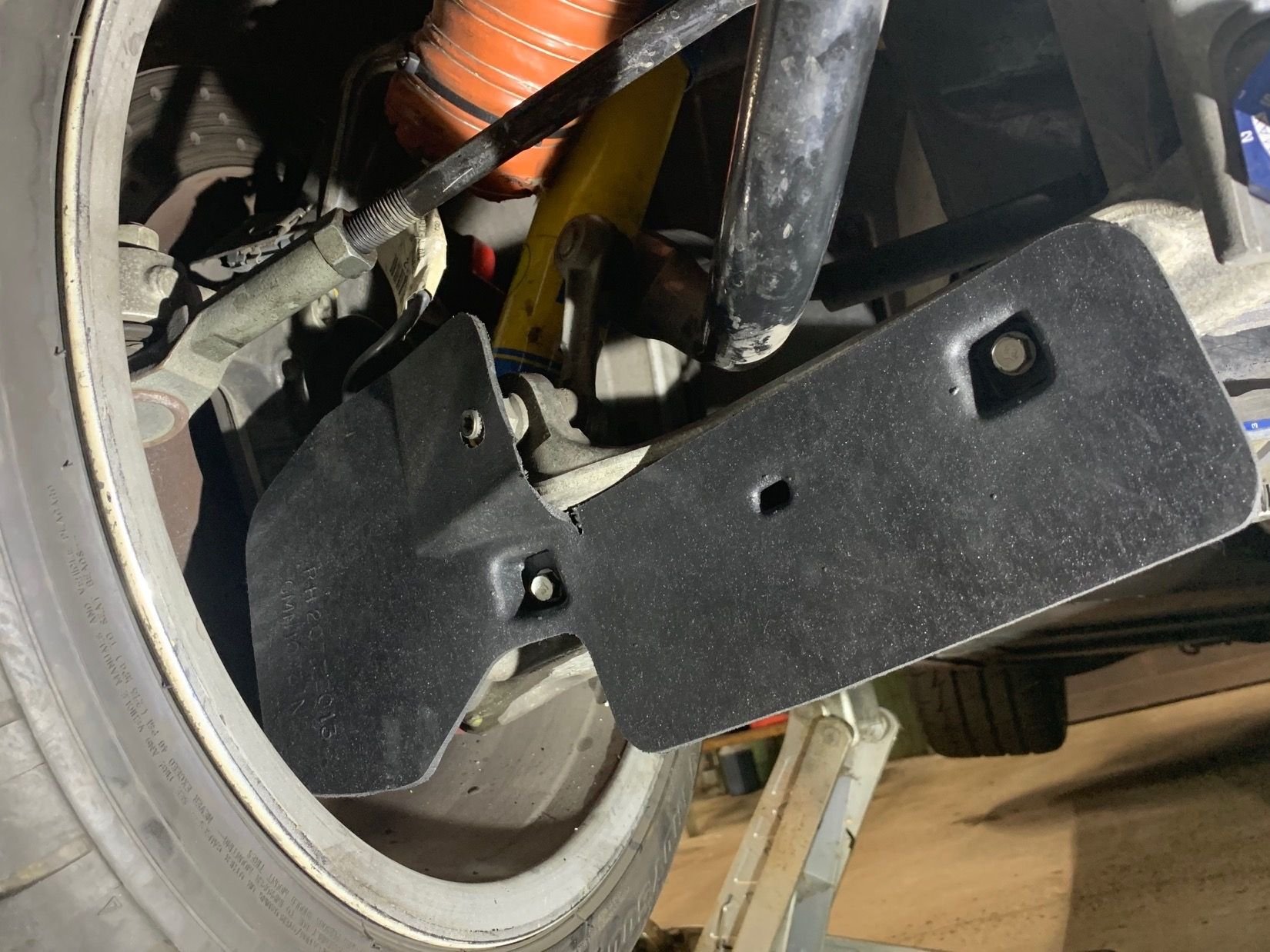

Curious to know, if the C7 brake deflectors will fit on the C6 lower control arms as well.
no, only on the C7 LCAs.
for C6 you need the ones from a C6 Z07or ZR1. Maybe there's a wrecked ZR1 in scrap somewhere...recently saw a related YouTube

Originally Posted by Wtbcrocs
Curious if it is because on the shape of the arm, or just because of the holes required?

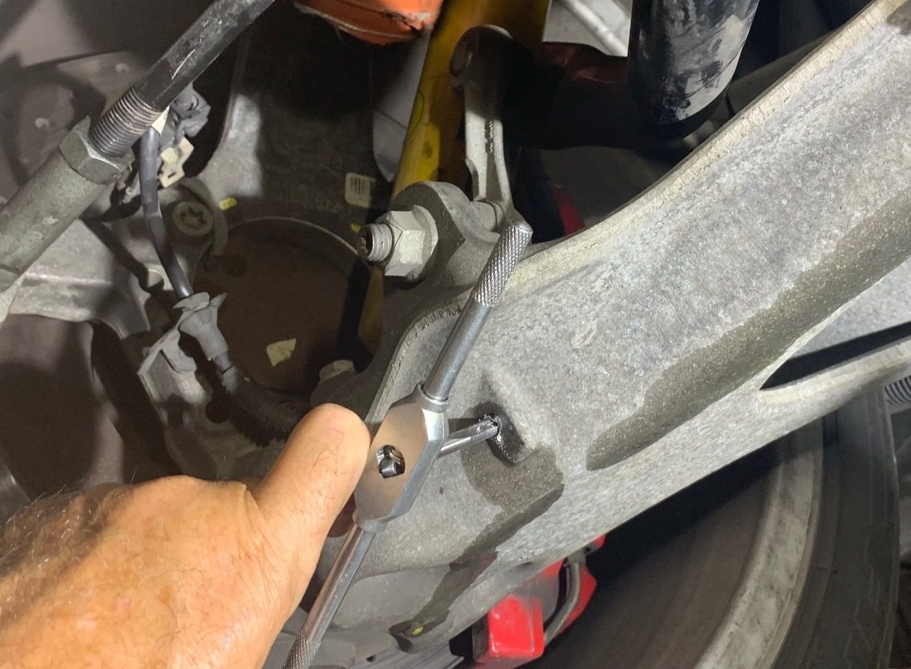

shape, design ...C7 appear to be hollow cast.
Regardless, even for C6 LCAs you need to drill, and tap the holes. Unless maybe newer ones all came that way...presumably

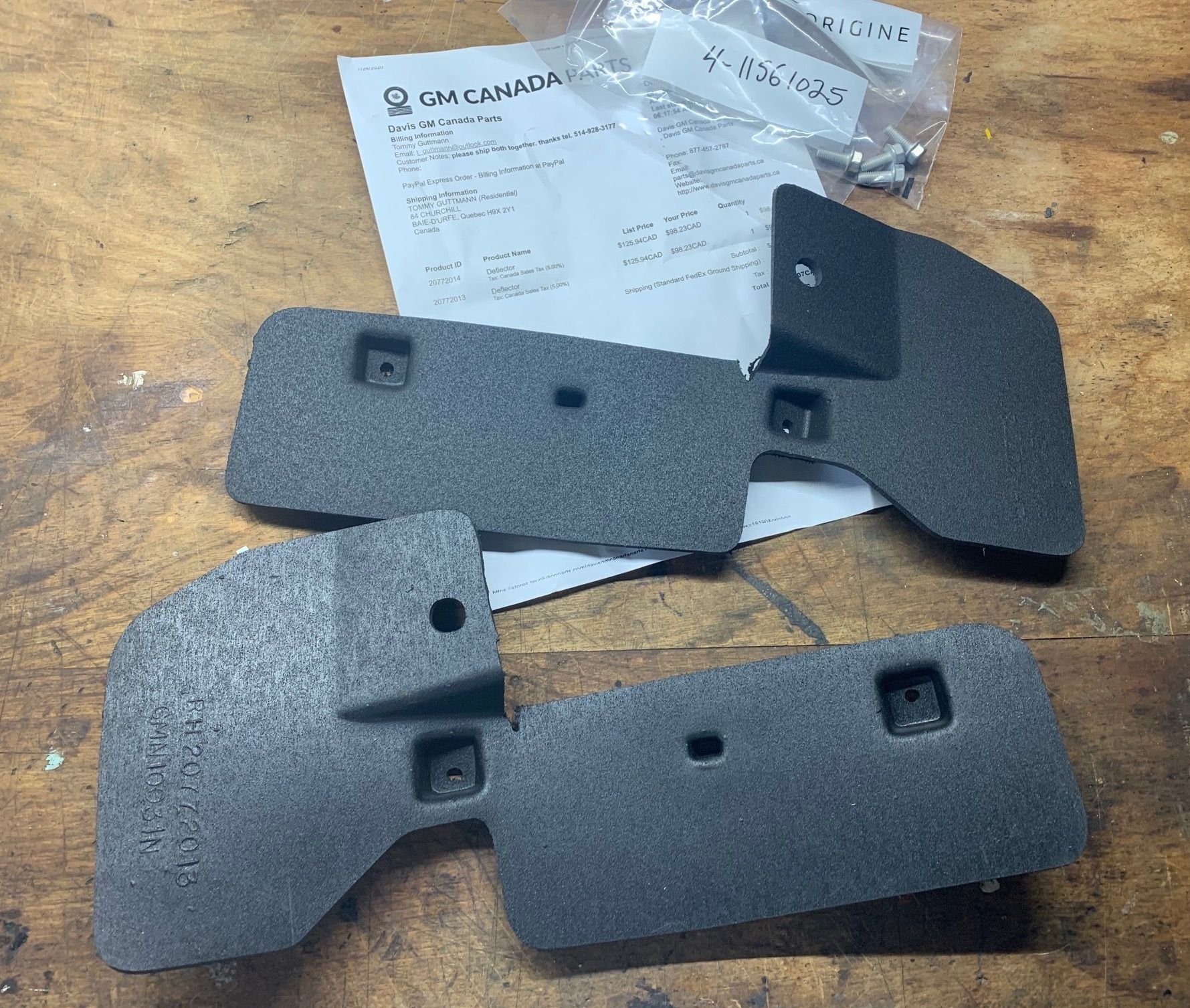

How much would you want for the defectors/scoops? I may try my hand at making them work if they don't rub too badly

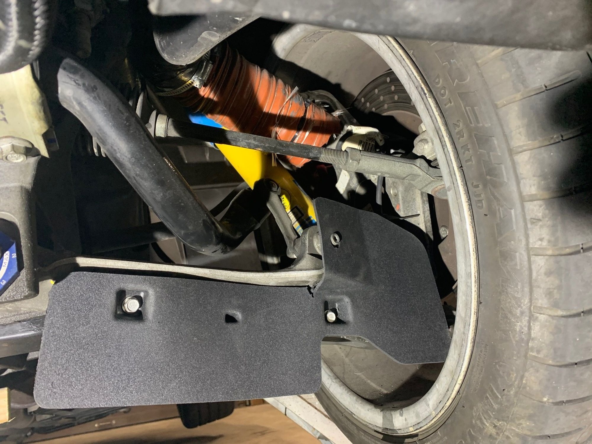

I don't think they would fit. You see, the C7 LCAs are shaped differently than C6
heres a couple pics of them on the C7 arms
Im away now but will open the package and take a closer look this weekend to see...

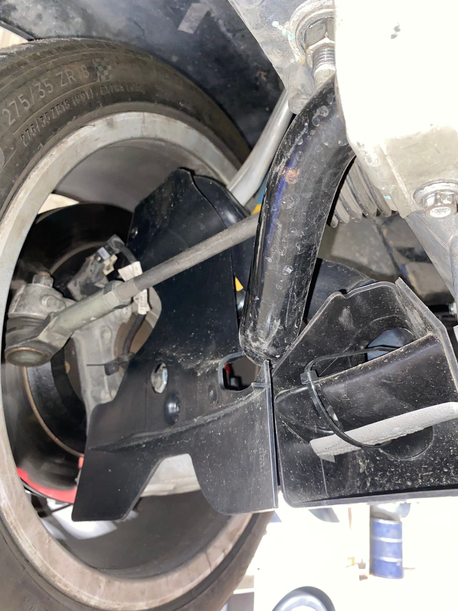

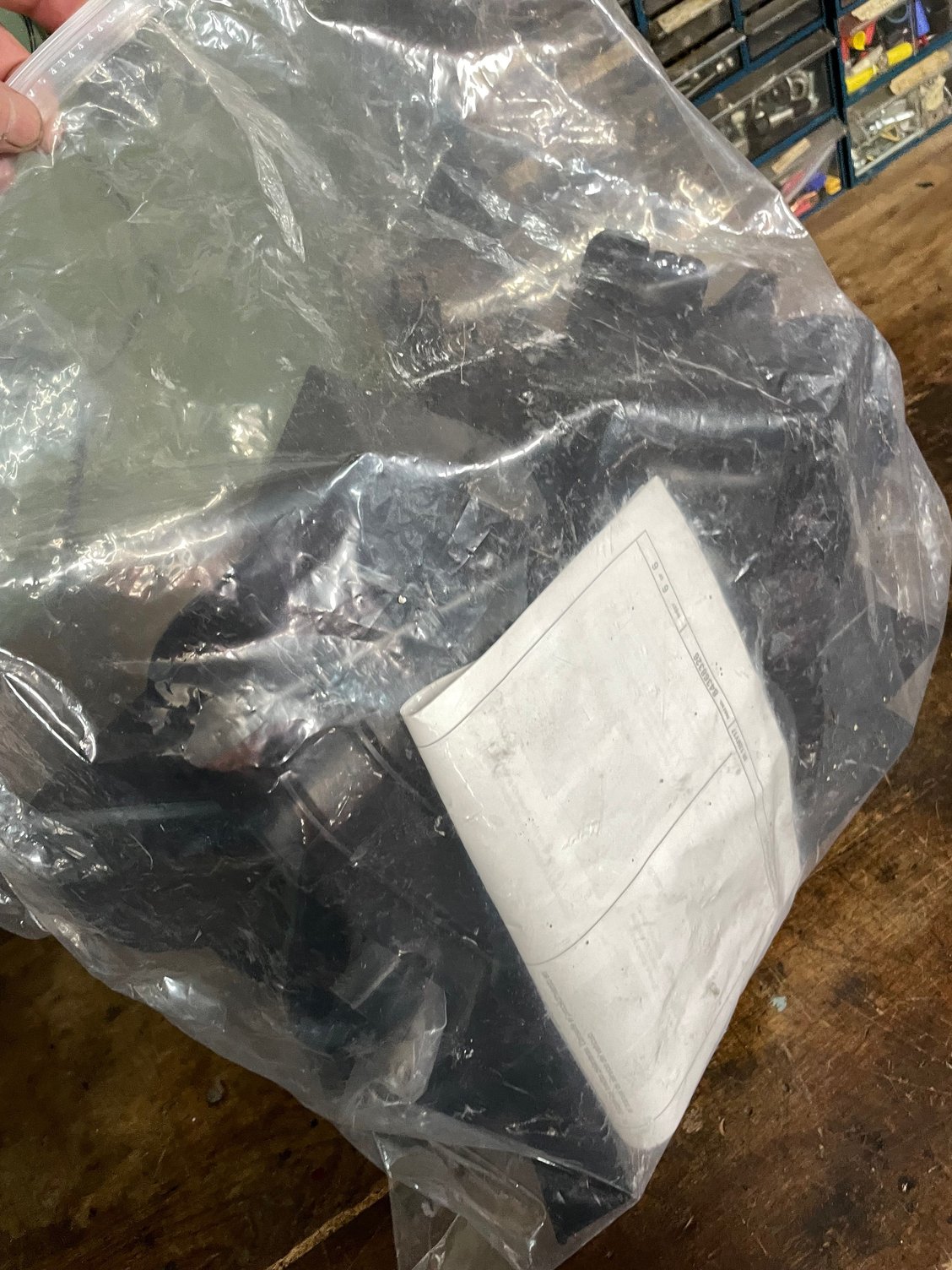

so I had a look, and unfortunately I'm just not sure. Reason being that my c6 ZR1/Z07 deflectors are installed on my C6 LCAs and I can't position the C7Z pieces as a result. Didn't want to start removing stuff...sorry
anyhow, this is the kit
https://www.cultragfactoryparts.com/...it-84057829kit
if you want to take a chance
mine is still in the packaging
